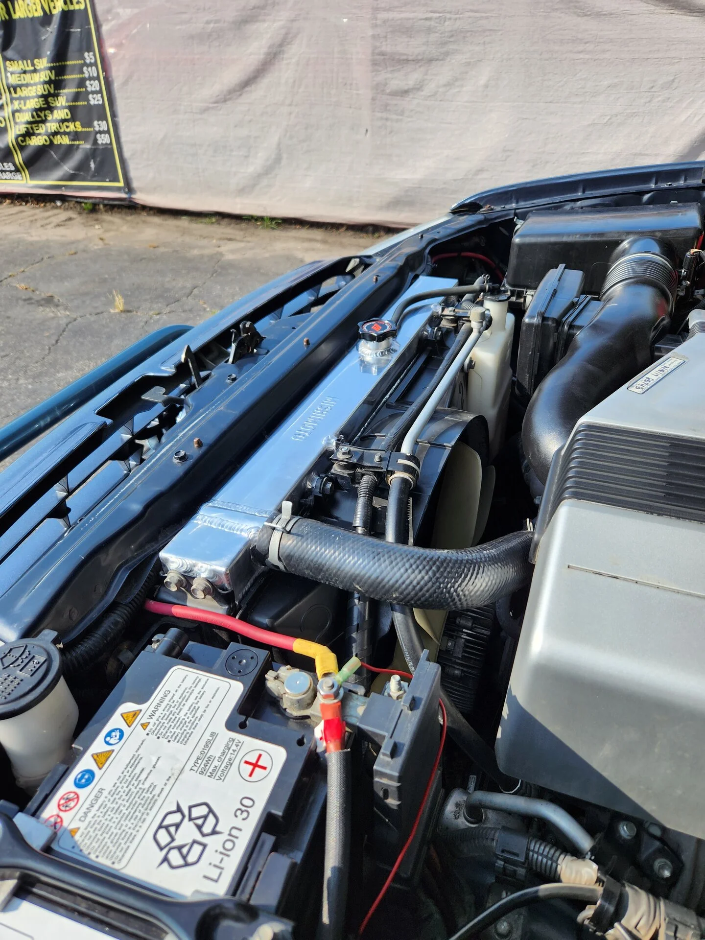

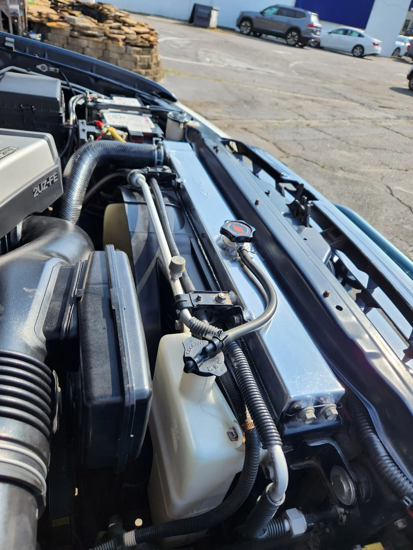

I am a OEM guy through and through when working on my 100. Everything I've replaced/maintenance has been Toyota OEM. But damn, this aftermarket radiator cost less than my cost(I get discounts) OEM, and OEM is plastic. It started seeping on top.
Anyone else go this route. This thing is quality!View attachment 3385484View attachment 3385489
I've seen a few of those floating around on the forums. Looks bad ass for sure.
Let me know when it gets to 200k miles with plenty of life left, like my OEM radiator =] ( which lived in las vegas for the first 15 years of it's life )
Is this the Mishimoto Al radiator? I've been running one for about two years without issue. I too generally lean hard on OEM parts, but went this route when it came to my radiator replacement.
I have bought Mishimoto radiator hoses when I replaced the heater t's. They are very nice haven't had a bit of problem out of them. I will get there radiator when I need to replace the original.

Looks well built!
I noticed on their site that a transmission cooler is “integrated” with fittings coming from the lower tank. Not sure what that consists of… separate heat exchange coil or just a tube running through the coolant reservoir. Did you use that or keep the OEM separate coil?
Nissan had a recall where the radiator was leaking internally- coolant was making its way into the trans cooler and that would then take out the transmission. I really like the idea of an all aluminium radiator but I’d have to see some long term positive reviews first.
I ran a few Mishimoto radiators in previous cars. The build quality was good, but not up to OEM standards. All aluminum is good, except it pits over time. My Mishimoto rads have all been hit or miss on coolant hole fitting sizing. They're often wrong by just a smidge. OEM would be 40mm and the Mishimoto would be 41.5 or something. Not enough to obviously wrong, but enough to cause leaks over time once that hose isn't brand new.
If I were buying aftermarket, I'd consider Mishimoto as it was quite good for aftermarket - just don't expect anything better than genuine Toyota/Aisin/Denso.
For my money, OEM Toyota is still king here. Plastic or not.
