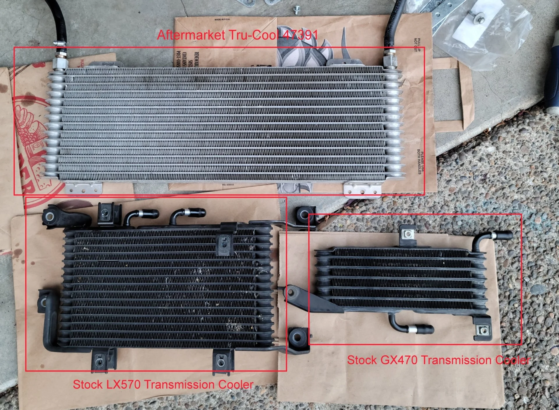

Go with a larger Toyota (like the 200 series transmission cooler) or aftermarket transmission cooler if you decide to off-road or tow. The OEM trans mission cooler is only adequate. You can monitor your transmission temps (torque converter temp and pan temp) with any OBD reader like OBDLink MX+. Below is a comparison of the stock GX470 transmission cooler (similar in size to the GX460 OEM transmission cooler) vs the 200 series LC transmission cooler vs a larger aftermarket cooler. Part numbers are on this forum, just search for them.

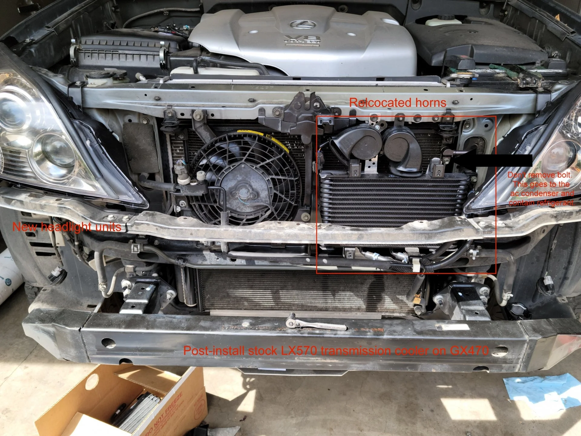

Below is what a larger 200 series LC transmission cooler install looks like on a GX470. It can also be done on a GX460.
What kind of transmission fluid temps are you seeing using the larger 200 series LC AT cooler in a GX? My first thought on seeing the OEM GX cooler was that it looked kinda tiny. It did drop my average temps though. Pan temp went from 206 deg F to 192 deg F. Torque converter temp went from 213 deg F to 199 deg F.
The stock 470/460 cooler (when equipped) is still too small. A Hayden 678 is around $50 and 3X the size of the OEM cooler. Mine usually runs ambient temp plus 80-90 degrees when running the TC locked. So I'm typically 170F in the summer.
