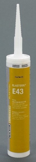

Be careful with using some silcone types on painted steel due to corrosion problems.
