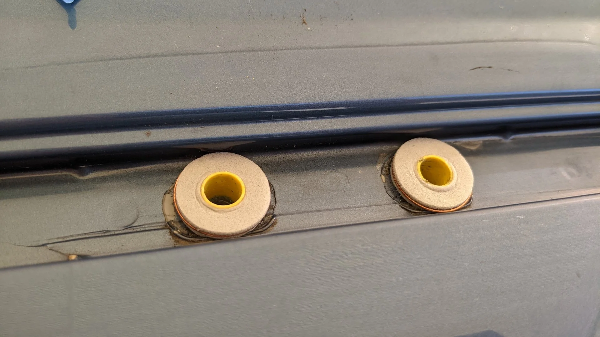

I shied away from the installation of the K9 roof rails for this exact reason. I wasn't comfortable with a "daub of silicone" and a stack of washers to keep water out. I'm sure that method is fine for most people and I'm sure that they've "never had anyone come back with complaints or water intrusion issues", but I felt like there had to be a better solution out there.
The approach that Rhino-Rack takes seems at least a little more methodical: foam coated copper washers and an o-ring around the bolt head going down. It may not be perfect but I felt better about it.
