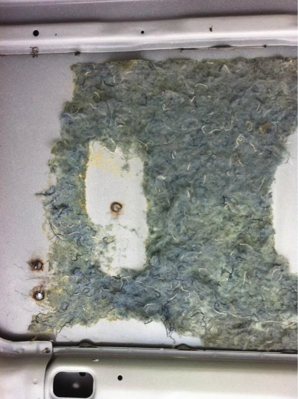

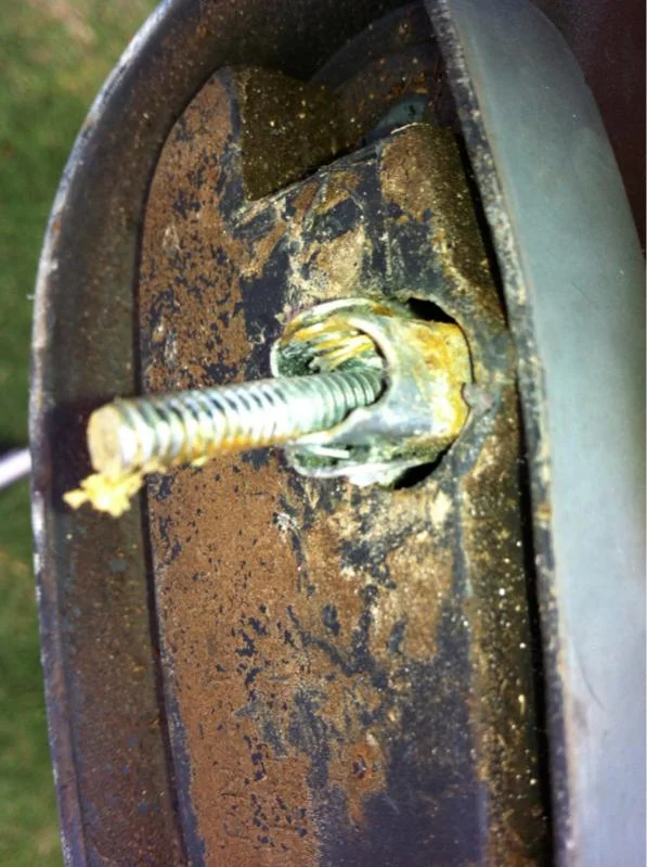

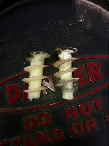

This was insanity, unbeknownst to me and compliments of the PO.
Resulting in
All the rest that hadn't been reinforced with drywall anchors, spun, and the only way I could remove was to apply pressure up on the rack itself.

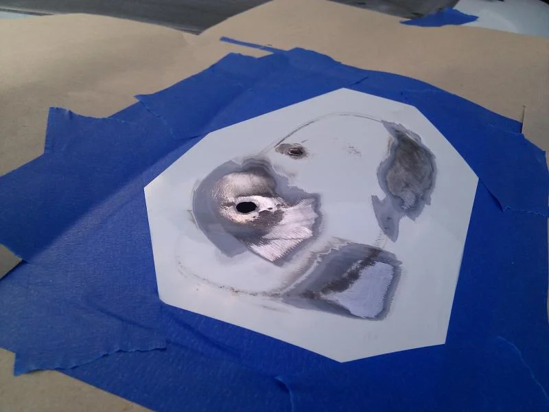

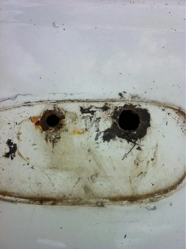

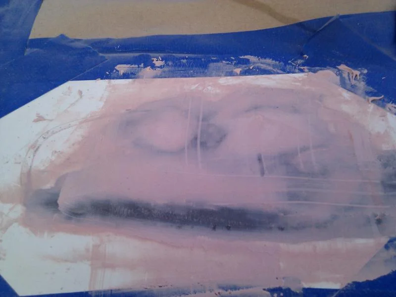

Removed my rack today.. two nutserts were not attached, both on the front one on each side. The other screws came right out but all had rust. I took it to a shop and got a quote for $1000 to patch and paint including the rear wing which is pretty bad too even though the rear hatch was painted 3 years ago. I also got a quote to line-x just the top for $600
I decided to just grind off the nutserts and rust as much as I felt safe and using bondo to fill the holes.. Once dried i fared it out with sand paper and prime it. Took about 4 hours total.. I will do the rear hatch tomorrow. Not sure how to finish it off though to match the color.. Might end up going back to the paint guy and seeing what he would charge to just do the paint.
Almost ready for the Gamiviti Expo!
Update, so Bondo alone will not last if you use it to fill a hole.. after using the car today I noticed on one of the bigger holes where I filled with bondo had blasted out.. I owe it to the very thing layer holding a large plug, when you close the door the air pressure probably cracked then pushed the plug out. ooops
So while doing the wing today I ground out the old bondo on the bad hole on the roof and patched it with fiberglass cloth, then bondo over that. that should give it some strength.. after finishing you will never know.. Gamiviti rack will be here Friday!

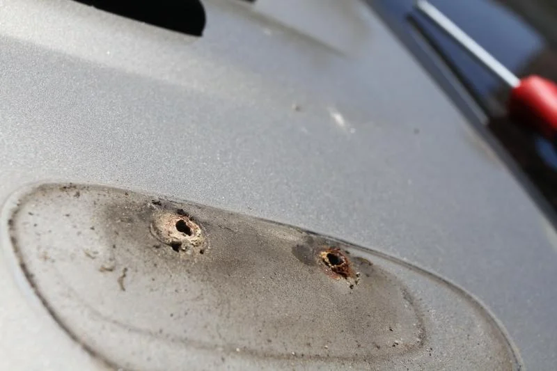

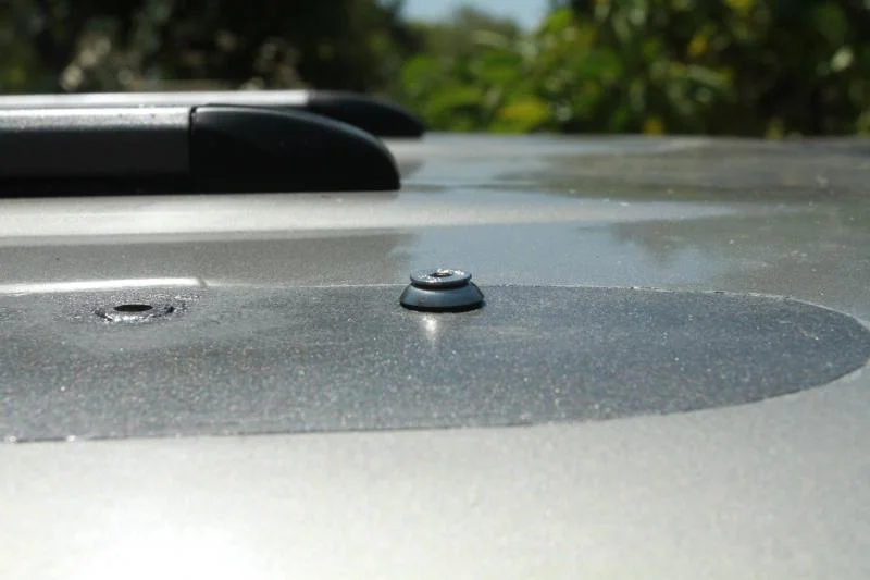

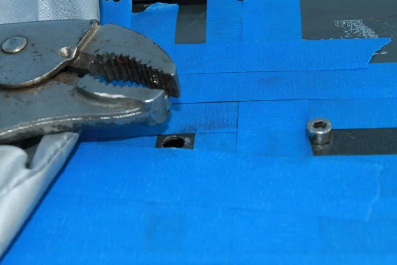

I drilled out the heads of the screws of a couple nutserts that just spun with the original hardware.
Beno suggested using a hemostat to hold on to the thin side of the nutsert to keep it from spinning. Somebody else on MUD used a sharp pick to catch one of the ribs or edges of the nutsert to hold it. I tried a variety thin pliers and scrapers (under the lip) to hold the nutserts while I drilled. I also tried some new hardware to re-tighten the nutsert to the body (not much luck with that). One nutsert I just keep spinning with the drill till it came out while I tried to hold it with various tools (I hate to admit); it literally wore the sheet metal out and then came out. At least one nutsert pulled up enough from the sheet metal that I could cut it with a very thin cut-off wheel. I replaced all my wind deflector nutserts with the next size up (M6). I replaced many of my roof nutserts with the original size (M5). The nutserts under my rack ribs were in good shape.
The last pic below is some stainless hardware I tried out. The stainless half-donut-shaped washer has a rubber washer under it, as recommended by one of our legendary parts vendor gurus on here...
