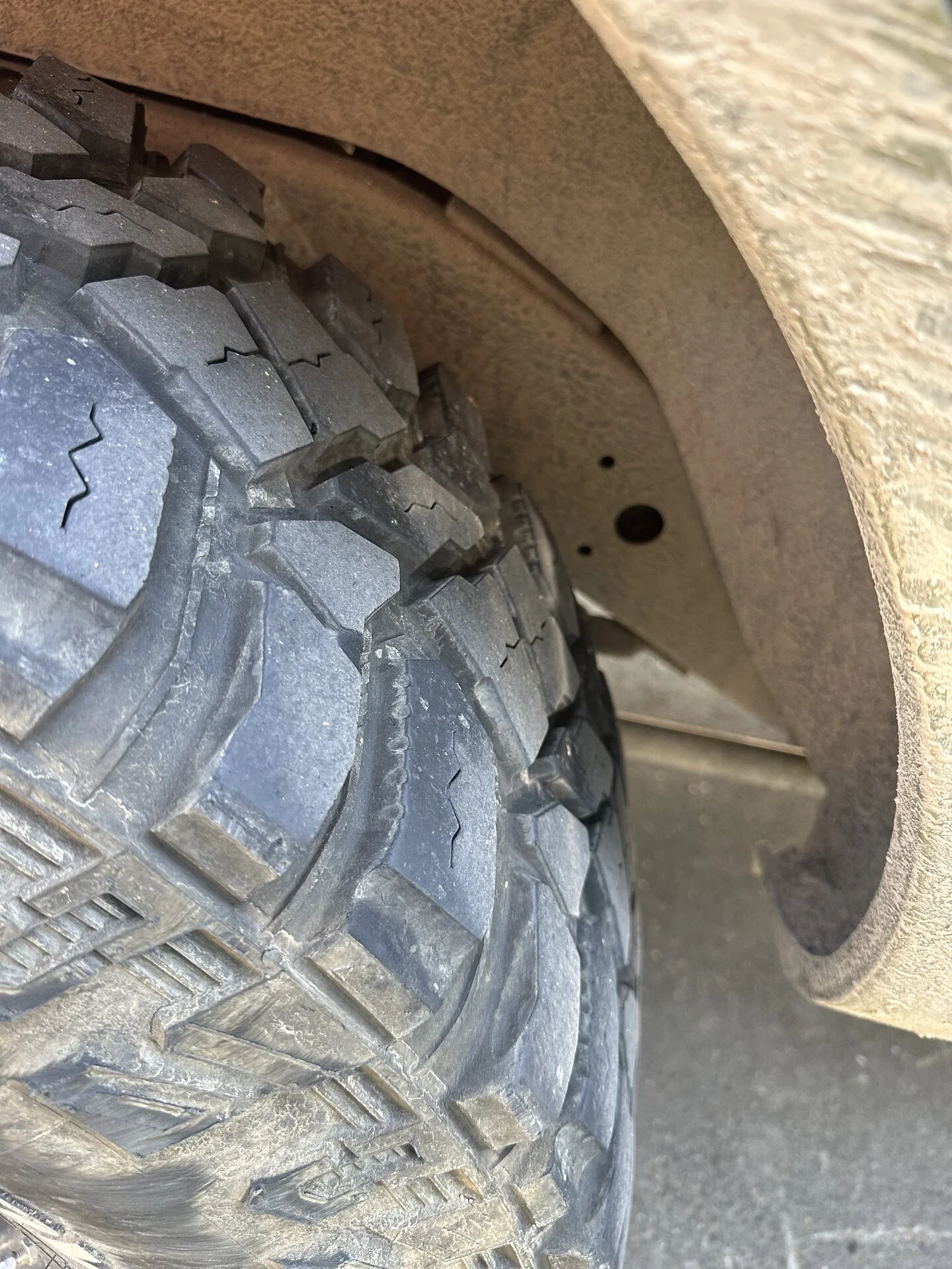

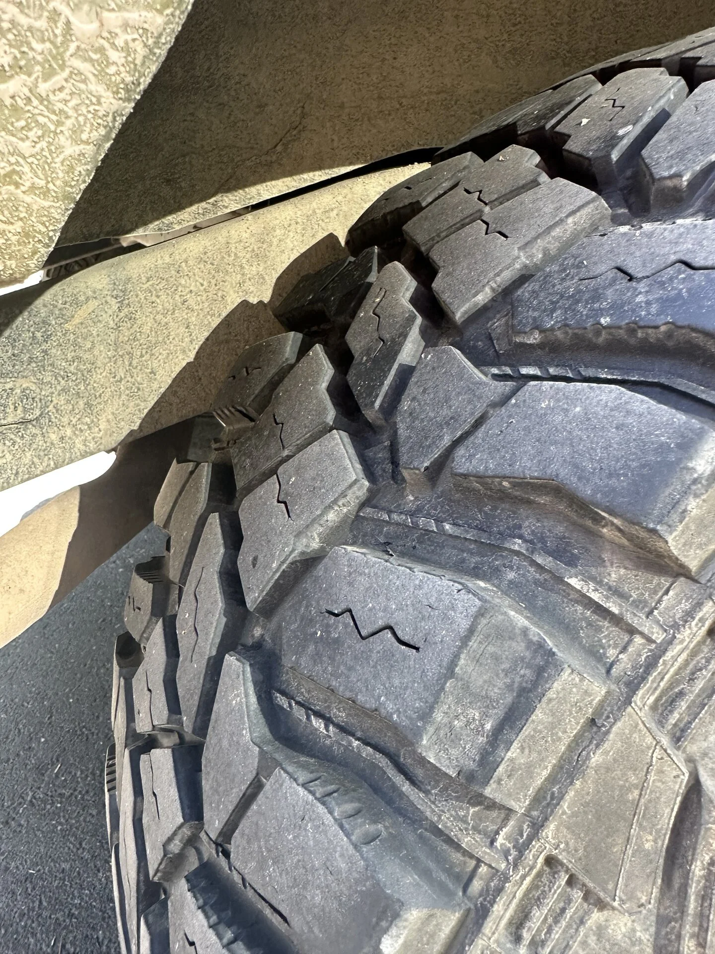

Got a 97 FJZ80, running 35” Cooper STT Pros (E) about 1.5yr old. Got Fox 2.0 extended shocks, about 1.5yr old. OME mystery springs. The rear tires are having a funny wear pattern, almost feather like. Can’t notice anything in the front, maybe some odd wear before the rotation. No vibration or other issues that I can feel. Running about 35psi. These two rear ones were rotated from the front 3000mil ago. Any takes?

How many miles ago did you rotate them?
What I see there is typical front tire wear, then rotated to the rear and the rear is straight and flat, so the pattern looks off.

Interesting,
These two rear tires were rotated from the front 3k miles ago. When looking at the front tires, the wear “looks” even, meaning I don’t these contact witness marks.
I could be wrong, but I’m assuming the darker spots is where the tire is wearing more.

Looks like mild sawtooth effect or ramping of the tread. Run your hand forwards and backwards across the tread and youll feel it
When you rotate them put the lower leading edge so that it makes rotational contact with the ground first as opposed to the higher edge. They will then even out and slowly start sawtoothing again at which point you rotate them again
Key is to always have the lower edge contact the road first when driving forwards
On the fringe side of things, a bent axle tube can do similar things I believe.
But perhaps it's just worn control arm bushings causing the rear axle to yaw under accel/decel?
true, play in wheel bearings, incorrectly adjusted LSPV etc. Many things but looking at the tread blocks which are quite aggressive they cop a hiding driving on sealed roads which exacerbates the issue
