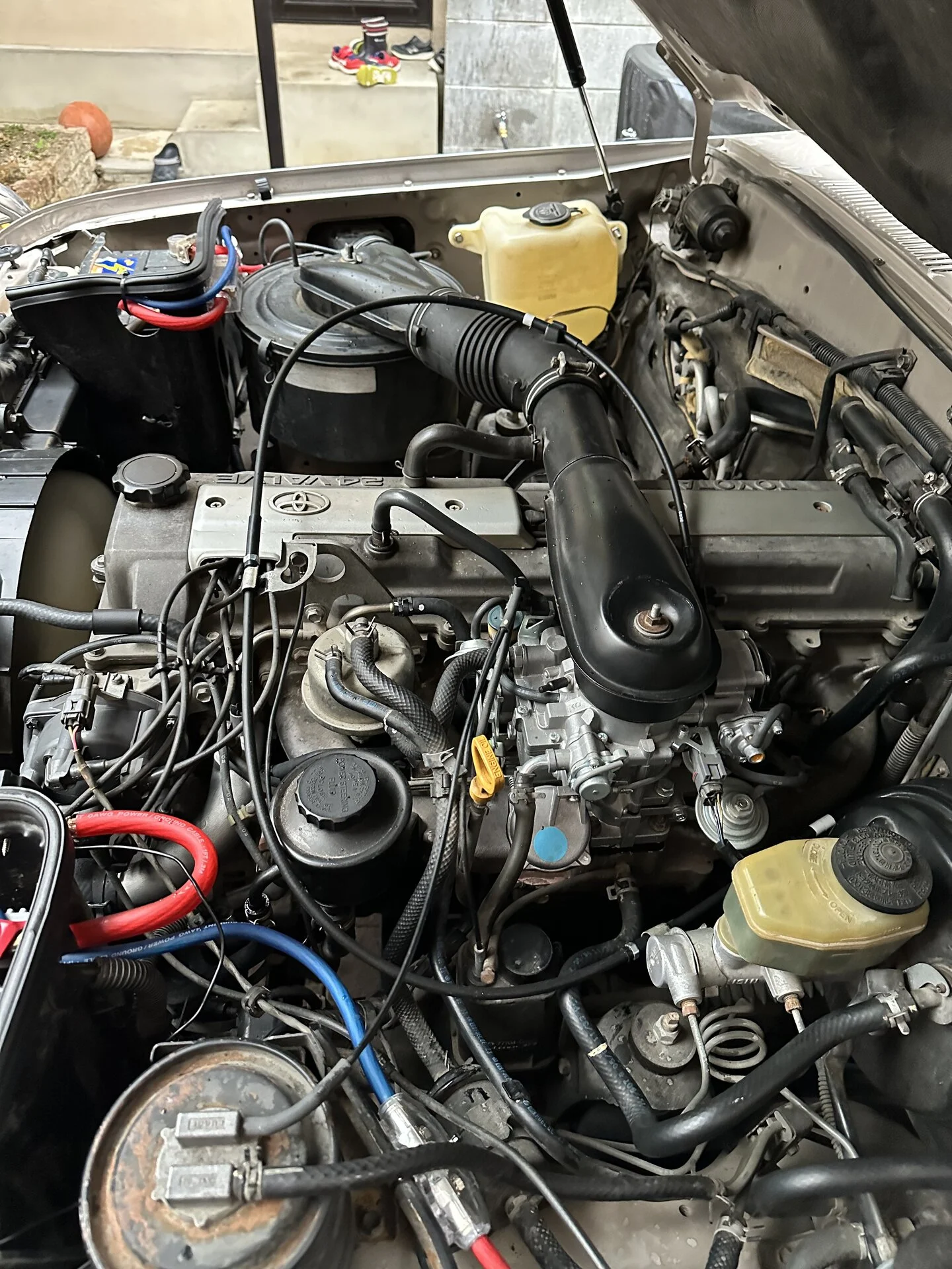

Would anyone be able to identify this rubbery-like pulsating squeaking sound? Comes from the front of the car, only when cold, can be heard inside and outside, and seems to somewhat be connected to engine revs. Goes away when car warms up.

I feel like if I stand at the drivers side (US) and look at the engine from the front fender, it’s almost as if the noise is coming from the right side - towards the firewall. Is there even anything that pulsates in a pattern like this there?

Can you get another video/sound clip from above?
