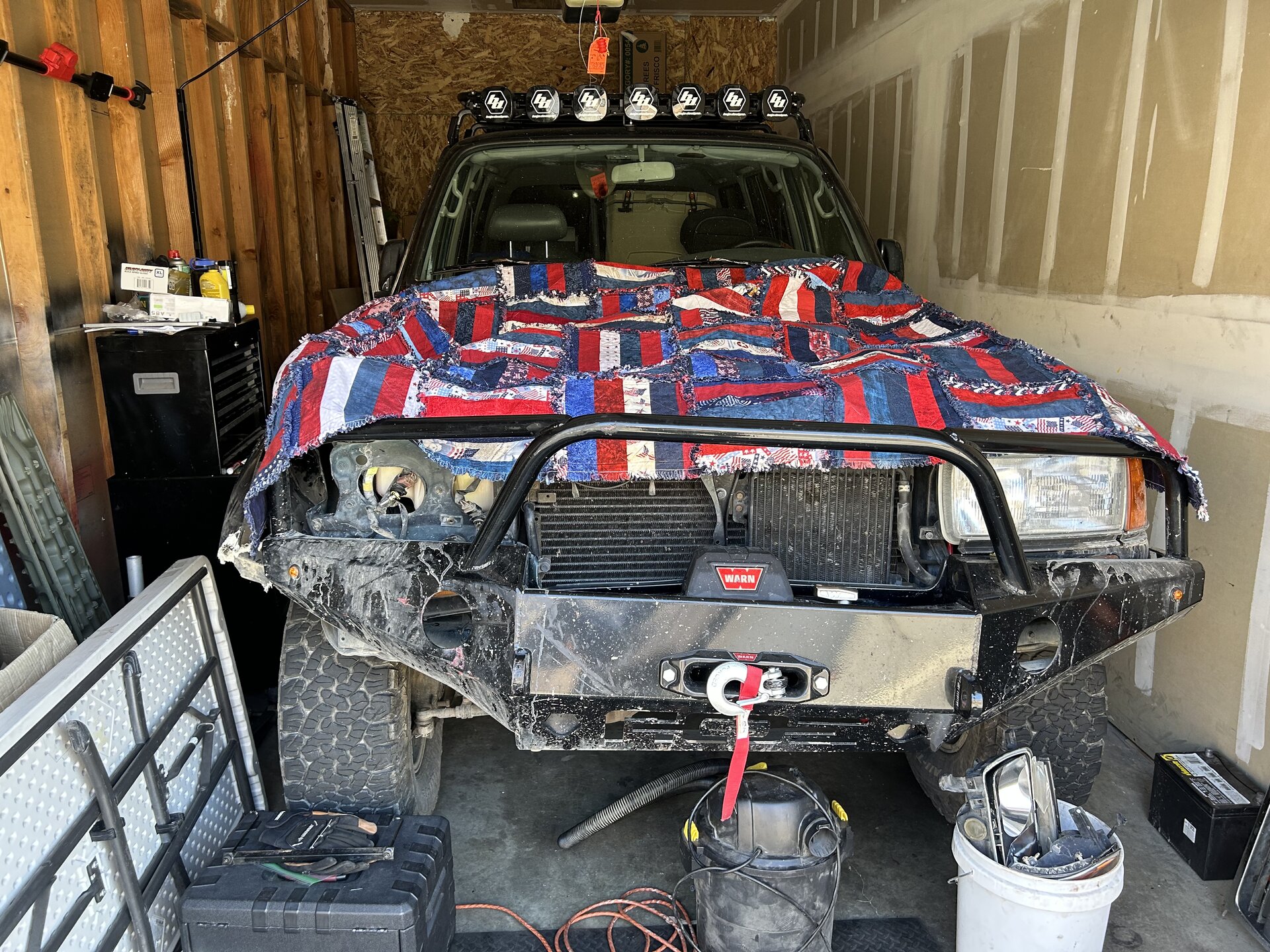

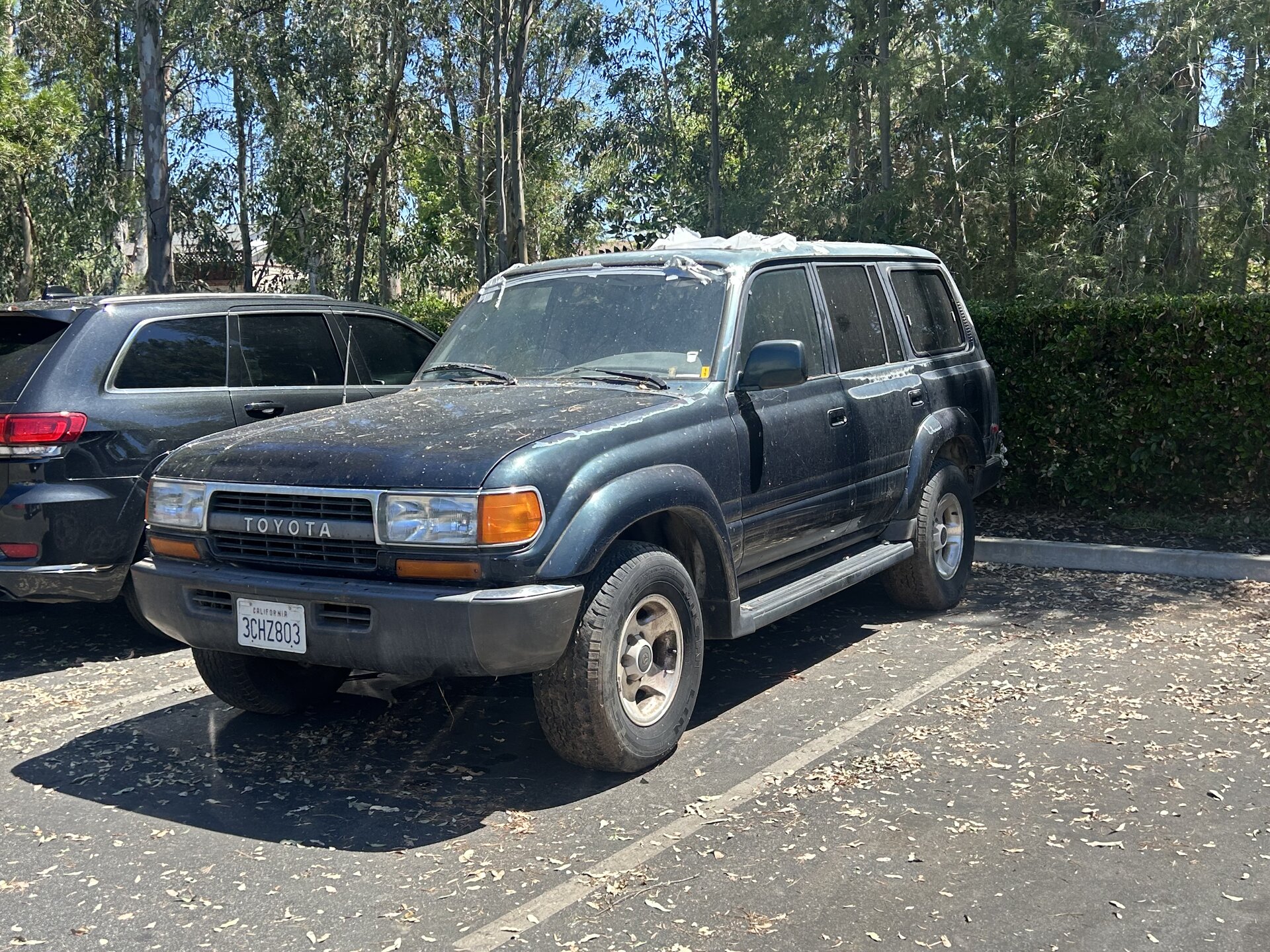

Long story short, I purchased a non locked ‘93 LC 80series for unbelievably cheap, might as well have been free cheap. The body looks great, surface rust on undercarriage/ axles.

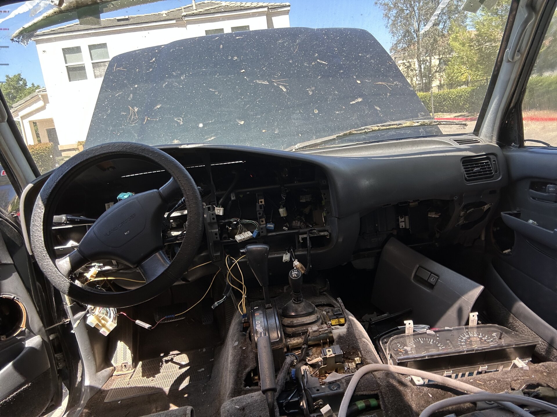

The previous owner said that the engine with 300k+ miles and headgasket blew 12 years ago and has been parked since. He began using the truck as a donor to his new truck so the interior is taken apart. But not a big deal as my crashed locked 80 of the same year will be the donor for this one. To include my engine with 214k miles and locked front and rear axles.
I’ve never taken an engine out nor have I ever rebuilt one. Should I use this blown engine with 300k+ miles to rebuild to gain experience…. Or should I just rebuild and replace the headgasket on my crashed truck motor with 214k miles and stick that on this truck.

First off good for you wanting to rebuild something you have no experience in! I rebuild 1fzfe’s for a side hustle and have some experience. The motor with a blown HG that has been sitting I would not touch. With coolant sitting on all your bearings and mixed through out your motor it is likely shoot. Pull the motor out of your wrecked 80 and rebuild it. Lots of threads on rebuilds on here and some good videos on YouTube. If you don’t have a Toyota FSM download one for free in the resources section and get a parts list from the build threads on here. It’s not that expensive for a head rebuild from a good machine shop. It can get ex if you start replacing everything in the engine bay. Ask questions and the MUD community will help out. But don’t be lazy and ask questions if you have not searched for easily found answers. If you search google with your questions and IH8MUD in the search it will bring up lots of answers.
If you have an engine with a blown HG that has sat for 12 years, odds are, the cylinder walls are junk due to corrosion. You will need a new short block and then have the existing head rebuilt.
If you have a good engine with 214K that does NOT have a blown HG, I would just pull that one, freshen up seals, and install it (don't do the HG) unless you really want to while it's out of the truck and it's a lot easier.
Also if your motor with 214k is blown drain that oil ASAP and refill with fresh oil. Drain the coolant and run the motor to get that fresh oil throughout the engine and get the coolant of your components.

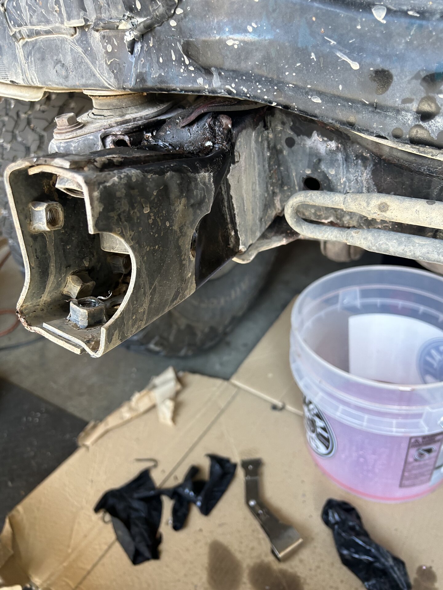

Engine aside, is your plan to have the original frame straightened (pic shows frame damage) or are you envisioning a frame swap from the newly acquired 93? The core support also looks to need some love as well.
The only reason I want to do the head gasket is so that it’s something I wouldn’t have to worry about again so a long while.
But yea, you’re 100% right, might as well just scrap that engine and just use my 214k engine.
As far as the interior, I’ve head really horrible experience with people doing whole center console dash swaps.
Would it be better to just engine swap and body swap?

The interiors on these are stupid simple bolt on affairs. I wouldn't hesitate to swap it all out if the other one is better. I ripped my whole interior out to start fresh on my trail build.

The only giant PITA item in that year truck is the headliner.
Those are all clip and bow headliner on the 91-94 years.
Everything else is stupid simple.
It all depends. I’m putting her back together to take her to get an alignment done.
Depending on the alignment and is the frame is all square then that will depend if the shop I took it to will repair the frame. Looks to only be damaged on the weld points and not farther back.
If she is too far gone then I have a tough decision to make. Either swap the body and engine into the good frame(make life easier on a wiring perspective) or just swap engine, axles and interior into this good body and frame.
Pros: the truck with good frame has a nicer body then my truc
Cons: interior is complete my f’d and I would have to swap everything over. I have no experience but would learn as I go and at that point will not be paying for labor or a shop to swap the body. Some estimates are upwards of 9k. Ughhhh
No way really? Yea my dash is in pretty good shape so I wouldn’t mind just swapping it over if it is that easy. The wiring could potentially be the biggest issue
