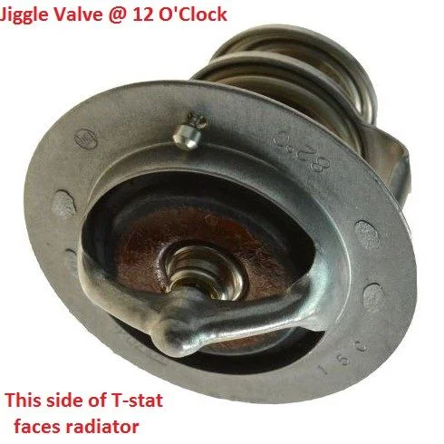

Likely air in the system. Or t-stat in backwards, but I don't know that it will even go in that way.
Hmm I'll see about the air.
Yeah pretty sure that tstat only when in one way. I remember making damn sure it was in right when doing the job.
It's esay to install a t-stat backwards, but that causes overheating. The spring goes inside the engine.
I agree air in the system.
Turn up the heat, but not to max and drive normally. Once the air bubble moves you'll get massive heat all of a sudden.
Just make sure your overflow tank is full to the brim.

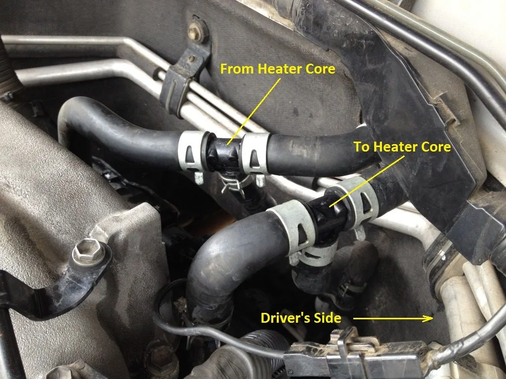

It can also be a blocked heater core. I have seen it before.
Wouldn't hurt to double check your Heater hose routing and the position of your T-stat.

This might be related...
When I pulled out the heater Ts they came out in pieces. It's possible some crumbled heater T fell down the tube. That might blocking access to some degree.
I'm guessing there's no trap or easy way to access that is there?
