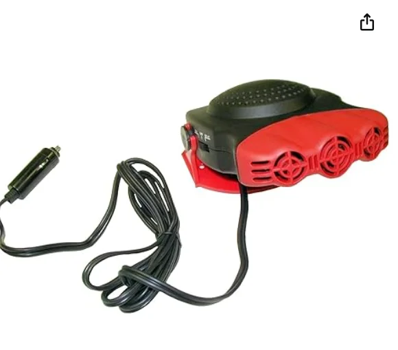

lol right, f**k that here's your new heat source
