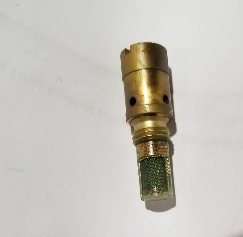

Ok, update...so I used @OSS starting method for 2 days and it worked and fired up. I tried his method today and it tried to start/stubbled, then after the stubbled it wouldnt start. I noticed today there was no fuel in the window and shaked the truck but to no avail...no fuel appeared after attempts of starting. When it did started on Sat & Sun, I noticed the fuel window was below half way in the fuel window. With that, I took the airhorn off and blew where the fuel line connects to diagnose the needle valve and it was working. Since fuel level was below sight window i knew I needed to adjust float. Since I made sure to get all chemicals off in my ultrasonic cleaner (water), I know all previous chem dip was remove and sparyed down with Carb Cleaner and blew out with compress air. Remember this was the theory as to why I had all that green gunk on my needle valve (and screen) main needles, etc. Well, I did seem see some more green residue...I dont know what this stuff is. Below is a pic from my NEW Keyster kit I just put on last sat (Jan 30th) and notice the green stuff. Any thoughts, suggestions after cleaning carb. Should i drop my tank. Btw, original replaced tank recall August 1996, per Toyota recall line.

My guess - tank is contaminated

If it is contaminated...can you please explain what contaminations in the gas could cause it to turn or have a reaction to the carb in this way? I will drain it and inspect, blow and replaced fuel lines.
Sheet in your fuel. Who knows what's in it. Water. Dead mice. Joe Biden's marbles. Sugar from disgruntled significant other ---
Drop tank, clean or have cleaned and checked (radiator shop), flush and blow out all fuel lines with carb cleaner, compressed air, then cleaner again.
This awesome ethanol gas likes to attract moisture but i am sure you already know that. I would do as recommended above at this point.

No i didnt know that. The Powermaxx fuel System Cleaner (Made in Germany) that I added weeks ago claims to help with moisture. I will drop the tank and report back my findings. Thanks guys
Is powermaxx a stabilizer? At this point I guess you have to go thru it all. I cannot imagine extra water in the gas causing all that brass to turn green that fast. That normally takes years. Something is reacting with it, like pissing on new copper or pouring Coke on it! Snowing like crazy here today, but let me know if I can help out sometime over PM?

Its a fuel cleaning system. As seen above, the gas is greenish. I dont see any deposits in my fuel filter. I will drop the tank to see whats in there since it will give me a piece of mind. Im glad this stuff isnt sticking. I sure let you...much appreciate it.
I can only guess that putting fuel treatment or stabilizer in old gas is wishful thinking. Old gas will varnish, and a quick google search shows others
with the same green gunk from old ethanol. So the gas in the tank has been sitting for a year?
Yes...it was sitting close to a year. Wow...that was a great article @g-man...thank you and all referencing to the fuel. The same green and how it affected the brass in my carb. I hope the weather turns here so i can drop the take. I will spray bolt Knocker Loose on their so hopefully the bolts come off easy.
