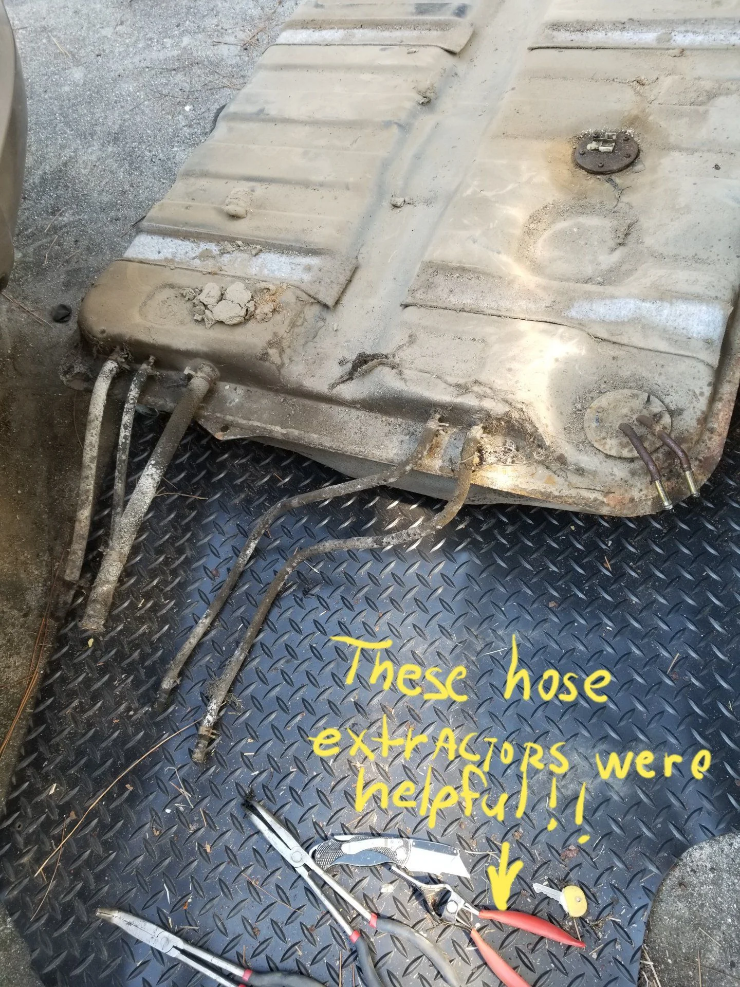

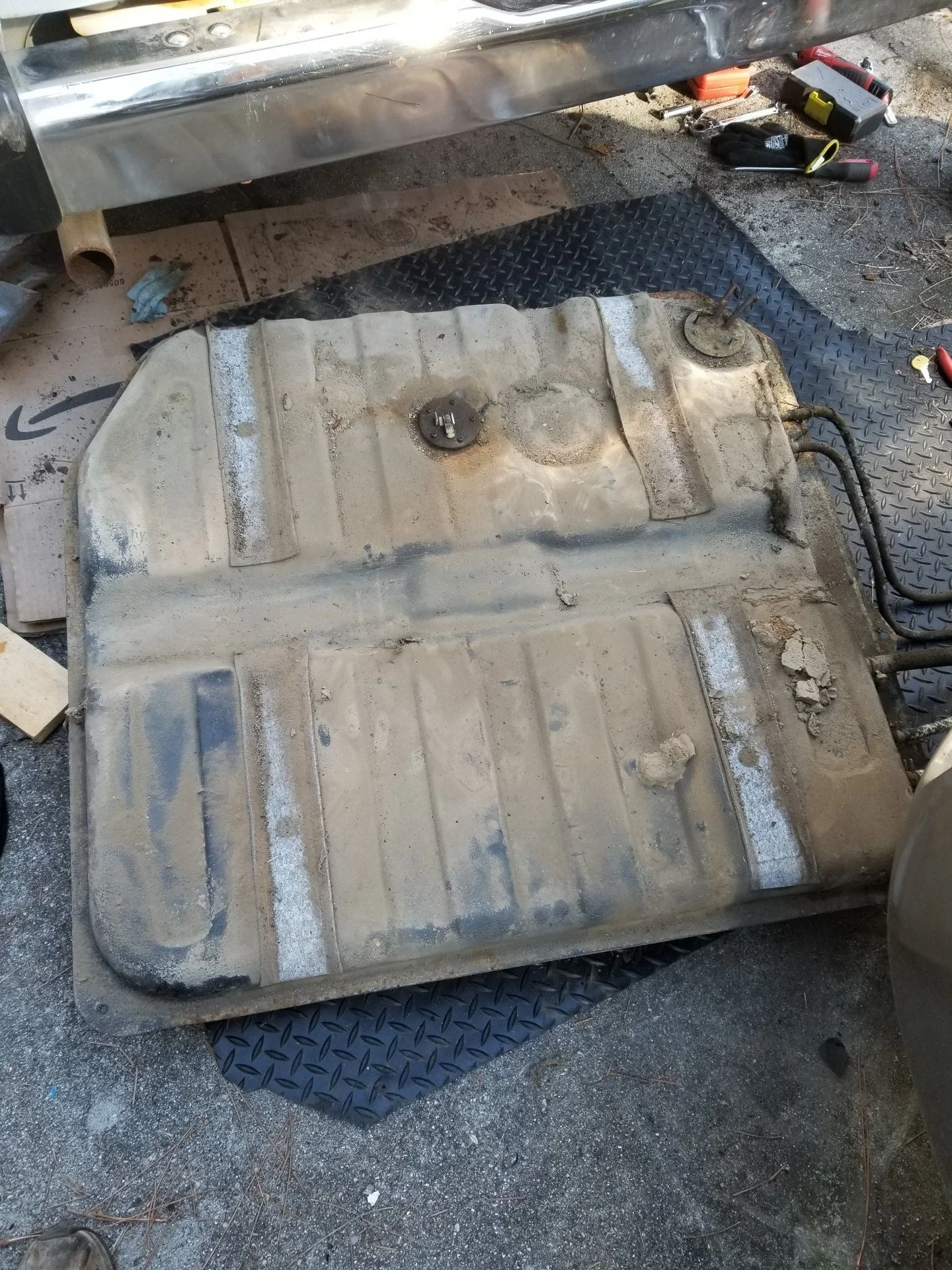

Well, I (the one man show) took the day off and took advantage of this nice weather in VaH- Beach to lower the Gas Tank. @IamGhost FJ60 Fuel Tank Removal Procedure helped out a lot. However, there are things that can help as well, such as; a Hose Extractor (a great investment), a good penetrent ( I like Knocker Loose & Liquid Wrench)...I soaked all bolts one week prior to today. It seems mine never came down since the last time they replaced for recall since 1995. The tire cross member was a PITA to get down, due to those old bolts and washer/nut on other side. Everything else went pretty well and I didn't see any rust but a lot of green Ethanol Residue. Its amazing what you discover when DIY things regarding the cargo mat was from Specter Off-Road.

REAL DIRTY!!!!

Well, I (the one man show) took the day off and took advantage of this nice weather in VaH- Beach to lower the Gas Tank. @IamGhost FJ60 Fuel Tank Removal Procedure helped out a lot. However, there are things that can help as well, such as; a Hose Extractor (a great investment), a good penetrent ( I like Knocker Loose & Liquid Wrench)...I soaked all bolts one week prior to today. It seems mine never came down since the last time they replaced for recall since 1995. The tire cross member was a PITA to get down, due to those old bolts and washer/nut on other side....it's not going back up, because A) I run 31x10.5 and I choose not to have a spare underneath B) It will shed about 25 lbs. Everything else went pretty well and I didn't see any rust but a lot of green Ethanol Residue. Its amazing what you discover when DIY things regarding the cargo mat was from Specter Off-Road.

REAL DIRTY!!!!
