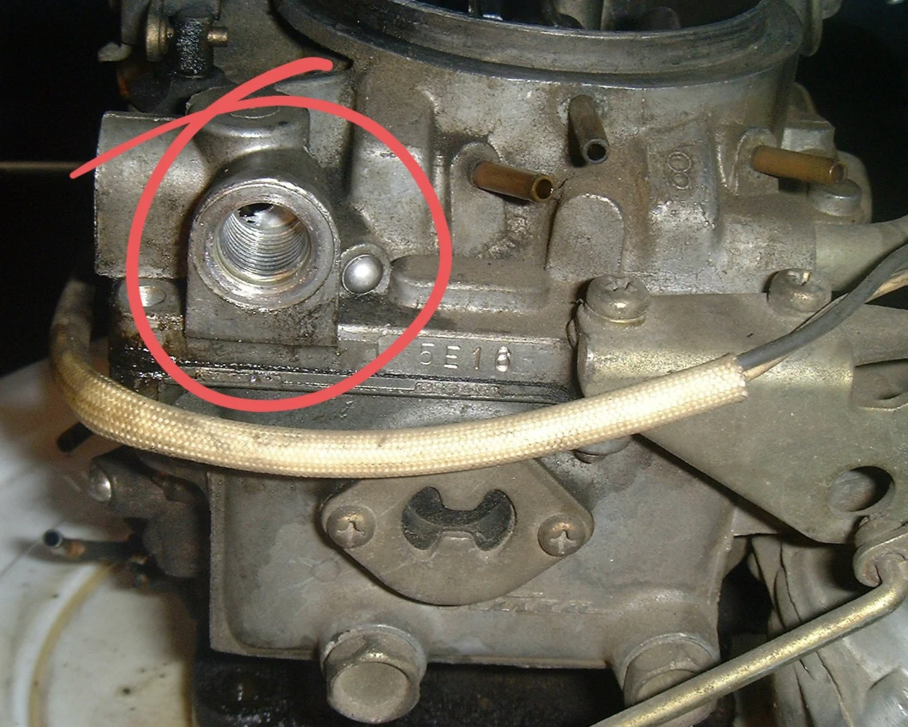

No start after sitting a few weeks - fuel and pump a-ok, getting gas to carb. If I pour in a little gas into carb, it fires right up. Sight glass shows the bowl empty and dry.
Is there a way to unstick the carb float/needle valve without pulling the carb off? Maybe spraying in some gumout, or something? PS this is a 1987 FJ60 - 2F with a Trollhole carb. Was running ok before I let it sit too long.

You can get to the needle valve by just taking the top off the carb, no need to remove the whole thing
First thing I would try is disconnect your fuel line and shoot some carb cleaner into the fuel inlet which is direct to the float needle.
Thanks, very helpful. I'm going to try that first, along with some tapping and rapping. I really should put the original carb back on, though, so I'm going to do that anyway in the near future. HNY!
All right! Couple squirts of Gumout in there, and some light taps with the 17mm wrench, and she fired right up. This buys me a little time, so I can clean out the garage a bit and pull the truck in there to work on. Got the JimC rebuilt carb and disto going back on. After that - a job I've been putting off too long - knuckle service. Thanks to all, especially @MDH33 . Happy 2025! Off to an auspicious start! :beer:
