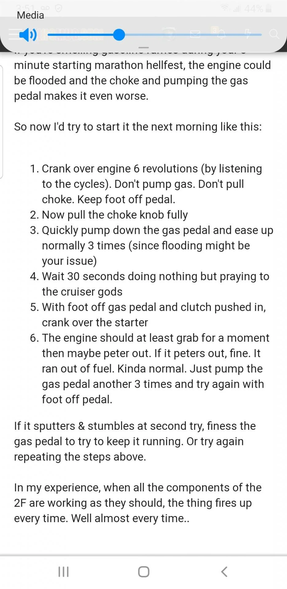

Well..it wasnt starting and im one not to give up. I was reading everything I could find on this forum. I happen find something what a procedure OSS recommended to do. I did it and Viola it worked on a cold start (35°F) and sitting more than 24 hours. Thanks OSS and Gman...Im smiling.
Heres what he said to do
Glad you figured it out! That’s a common thing with carbureted engines. I drove an old 66 ford stepside in highschool and that was the procedure every time I drove it no matter what. Sometimes my 60 behaves the same way. Shortcomings of antique technologies. They have their perks and plenty of drawbacks but carbs are a brilliant solution to a complex problem.

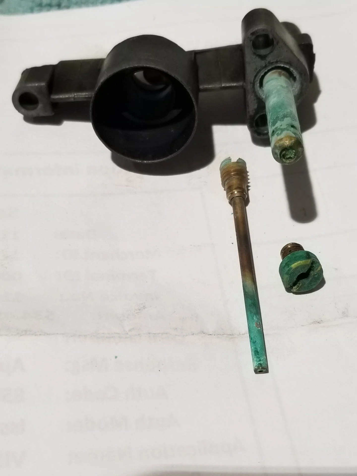

Well...it seems Osiris didnt feel OSS starting technique would work at the time. So, the carb is off again because Im not getting any fuel in the carb even though Im getting fuel pressure from line. I just rebuilt carb about 2 weeks and Carb dipped every part of the carb and it was clean. I just open up the carb and its all green and disgusting...what causes this in this short period of time?
Wtf is wrong with your truck my brother?! That looks like acidic corrosion of some kind. Maybe salt water? I don’t know. I’ve seen brass corrode like that but that’s crazy. Damn.
Well, the only way brass gets that green patina is Water, Oxygen, and CO2 ...
ETOH in Gasoline attracts H2O
But yours seems excessive in such a short time.

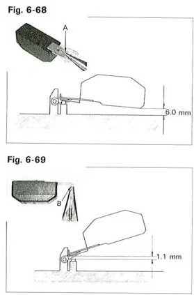

If you're not getting fuel into the float bowl and your pump is good and there are no restrictions, it's need/seat or something around there. Make sure you can blow thru the Air Horn where the Needle/Seat threads in.
I have no idea. My truck ran great...then have almost of year of sitting and troubles began of getting it started. It will start after I put the carb on then it will not run and gas will drain from bowl. Thanks you both CPS432 and Spike Strip for the information. I'm going to do a ultrasonic clean then make sure everything is dried out and rebuild it again with a Keyser Carb kit. I'm just lost..:bang:
No, I did not. I did put fresh gas in the tank. I only changed the fuel filter which is clear. So, its the gas that making it turn color?
I bet your fuel tank is full of water from condensation my man. Drain it. Check for rust. Maybe disconnect your send and return lines and blow them out with air. Let that tank dry out for a few days. Try it again. Change the filter. Change the rubber lines.
This^^^ with the horn/ top section off the carb, move the float level (figure 6-68) and blow thru the fuel connection ...it should be sealed or tight ..no air gets thru
Then with the horn upright and the float hanging down (as in a low fuel in the bowl senario) (figure 6-69) blow thru again...now air should easily move through the needle valve and seat.
