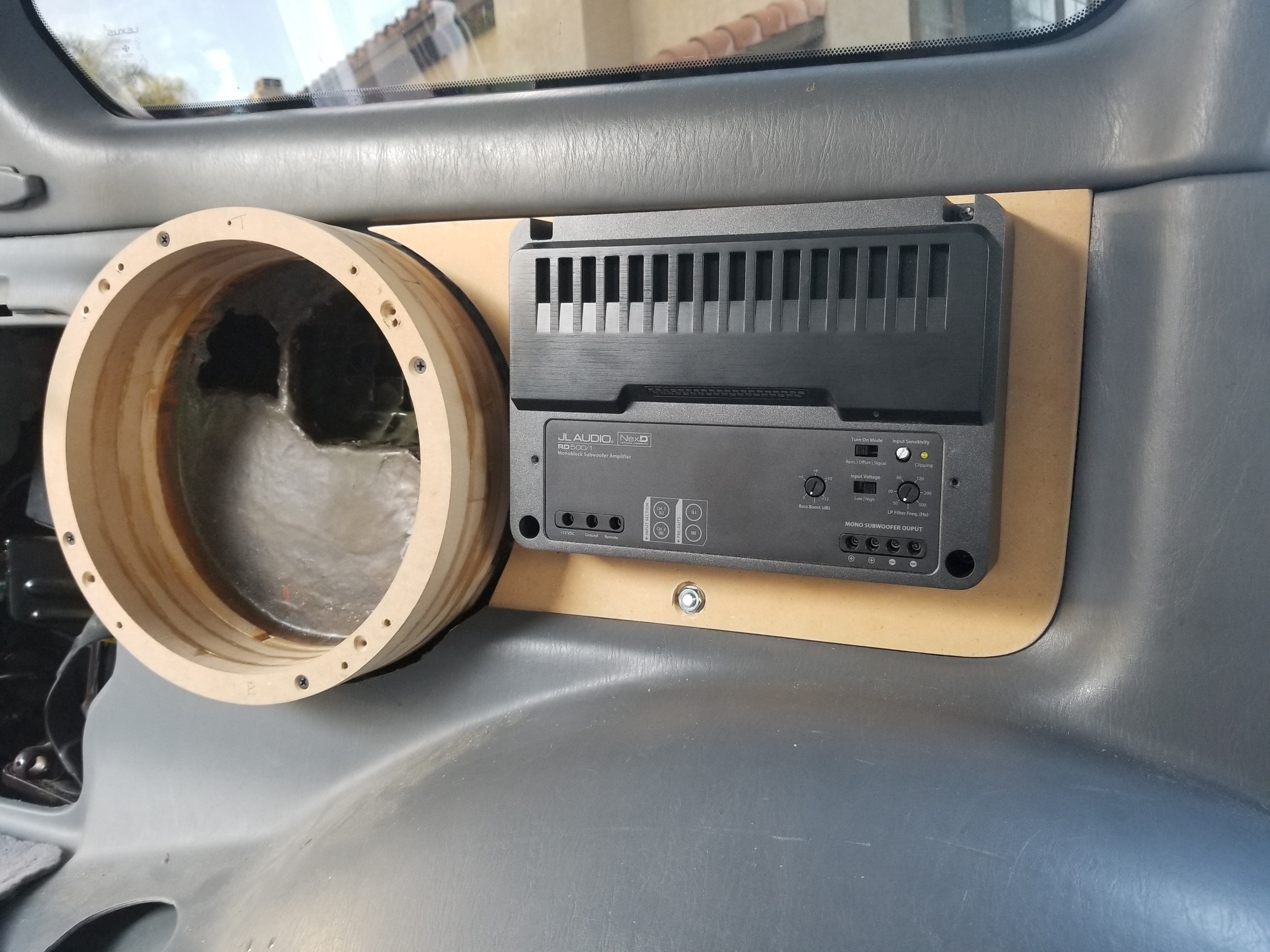

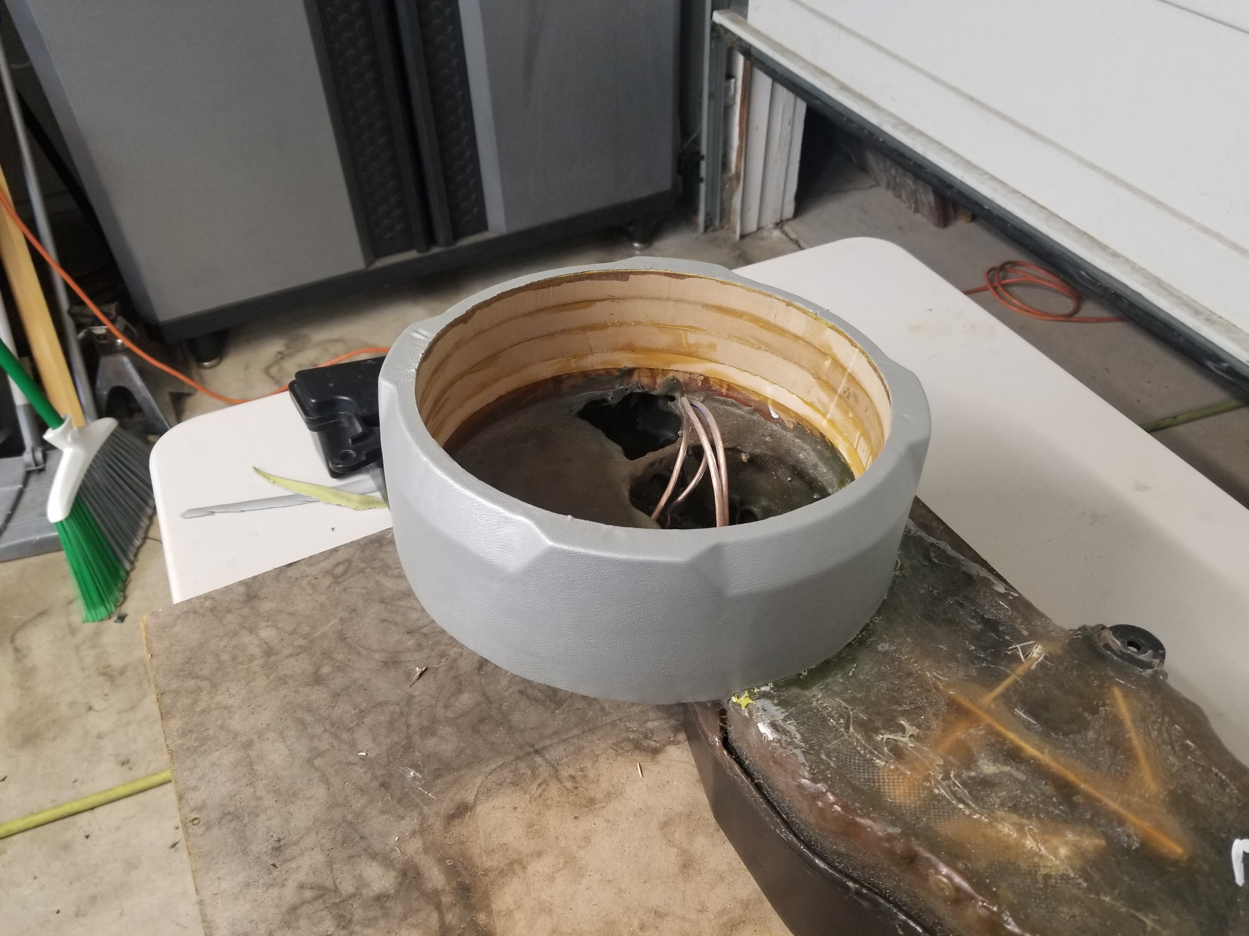

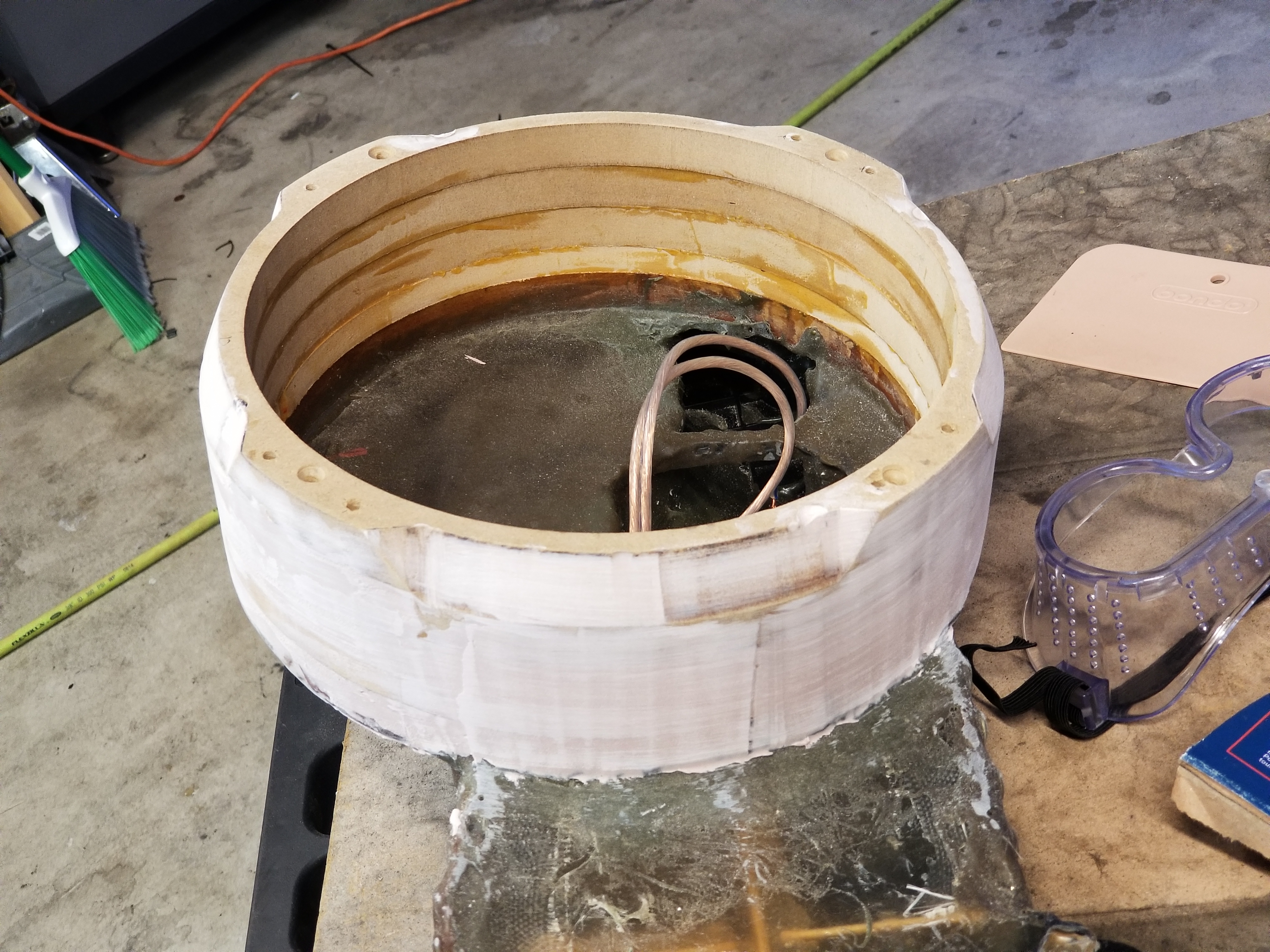

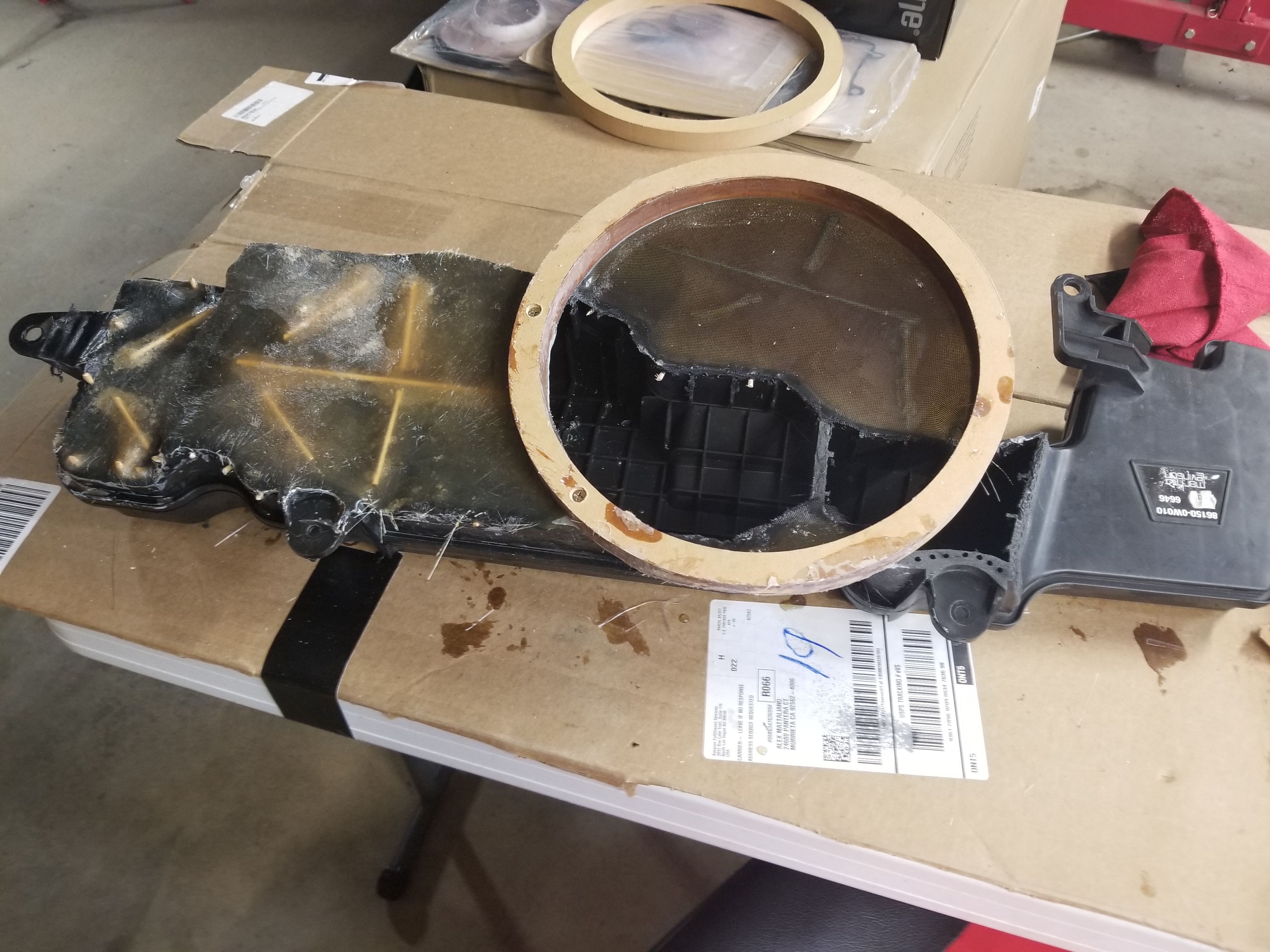

just thought i'd throw this one out there, i got a new JL audio 10tw3, and thought i had seen pictures of someone installing in 10" in the stock location, however it was an 8" and then i saw one with 2 6" lol. So i kinda got myself into a tough spot, ended up installin in this location, fiberglassing rings into this location, anyhow here are the pics :)
this is in a 2001 lx470 with mark levinson sound system - i couldnt quite get the airspace to .5 cubic feet but around .4 cubic feet. it sounds good and am happy with it :) i barely have it up, just to fill in the low end
***for some reason not all pics are popping up, if u see the image with an X, just right click>open in new tab>then refresh again , that loads the pic, not sure why but there is a solution :) ***

Looks great and I'm thinking of doing a similar project. I'm guessing you've had a few car audio systems in your life. What's your opinion on the sound quality of the sub firing sideways instead of rear-firing? If you had to do it again, would you use this same setup? I'm really torn between using a JL 8W3 and this 10TW3.
Also, I'm still getting up to speed on how to incorporate an aftermarket Amp. I know the LC uses a different factory stereo, but did you take the outputs of the factory amp and route them through a line output converter, then to your JL amp? I've heard good things about the Audio Control LC7 for this type of application.

i would do it this way again yes, as for sound quality the bass is great in terms of redirection etc (cant hear direction of bass) however the air space is a little tight, for this subwoofer required .5 cubic feet, the most i could get was about .4 cf, so below about 40hz it falls off a bit bit its still great - i use it to fill in the bass not to bump it like crazy - and it does bump if i want it to,
as for wiring, the amp itself has a built in line converter, so you just take the stock speaker level inputs directly into the amp and just select "high level input" on the amp itself, its a simple switch, i even used the factory connector from the sub and just sliced that into 2 RCA's made to go from speaker level to RCA.
i have thought a couple times as to weather i should have gone with an 8" and to be honest i thought some pictures i have seen online were 10" but it was an 8" which is why i had to put the subwoofer in a different location, now that i have done it the hard part of "figuring out how the fu$% i was going to do this" is already done so i would do a 10" again :)

Did you have to cut the interior panel to accommodate the install? I'm trying to avoid that and my 12w6 is taking up too much space.
