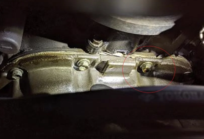

Long story short, been trying to find this oil leak for close to a year now. It started as 2 tiny ones, one of which I took care of. The oil filter housing oring was leaking. Fixed. Everything cleaned up, then the next oil change, more oil on things. Never enough to drip onto the ground so it takes a while to show up.

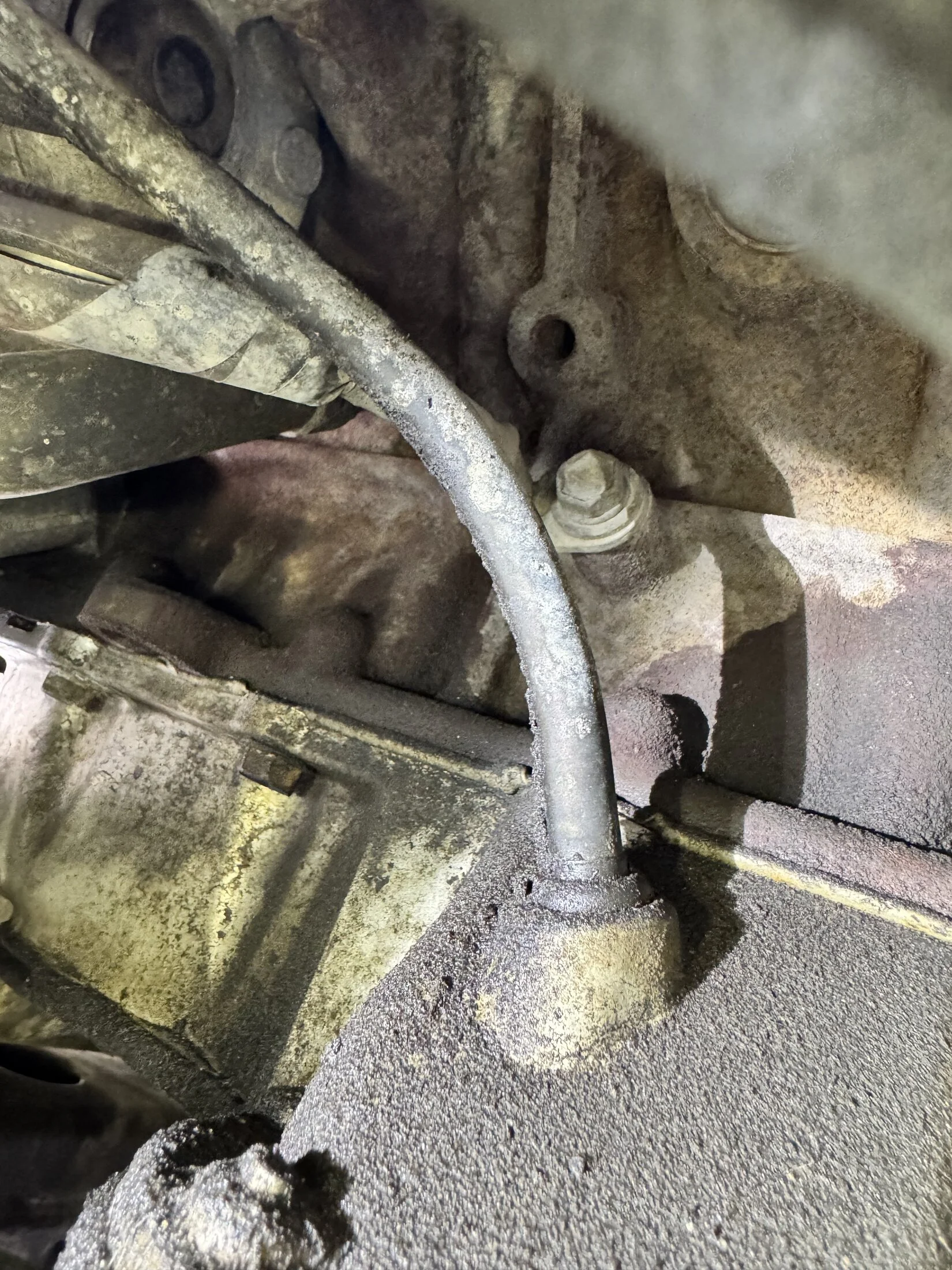

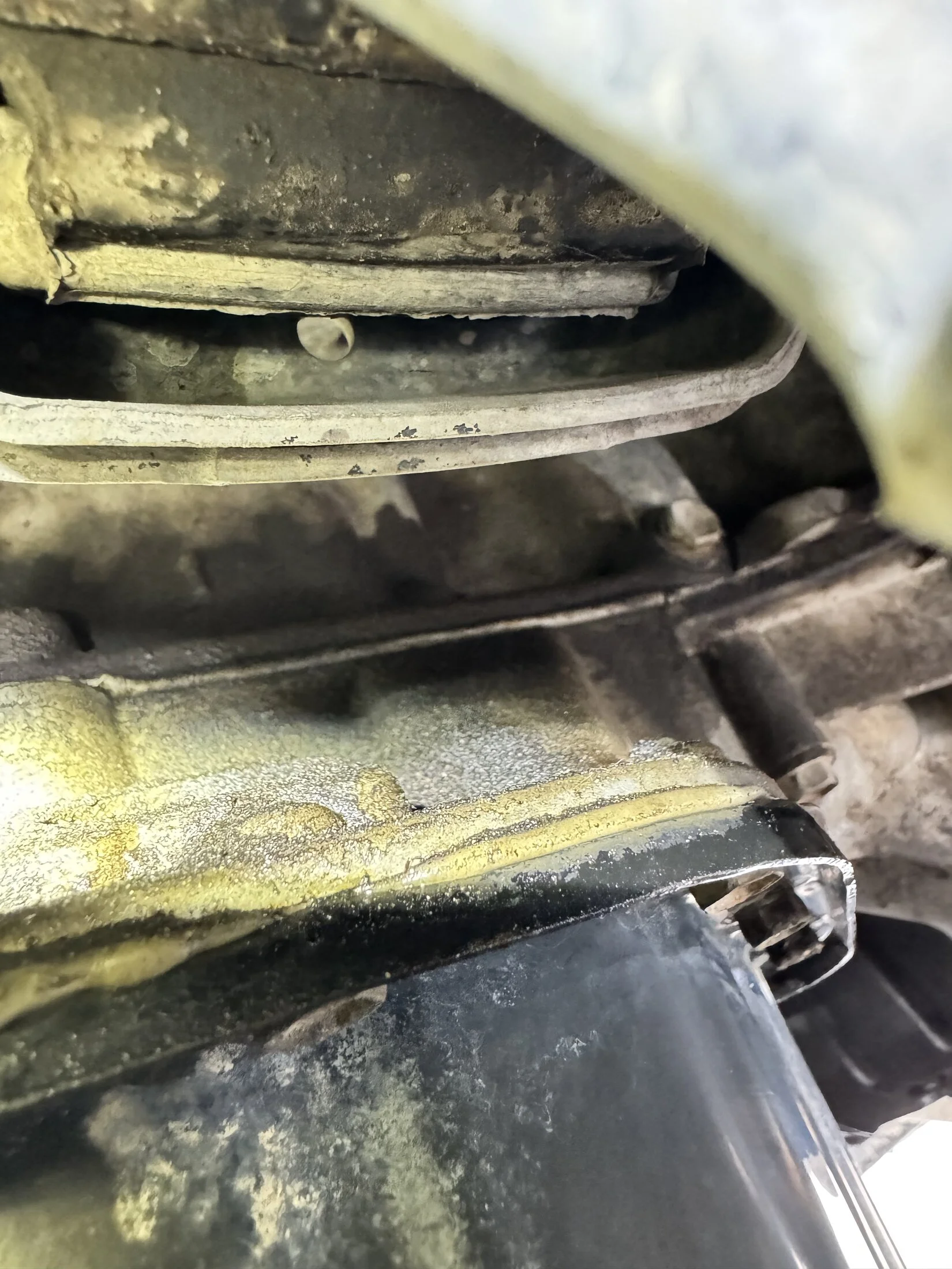

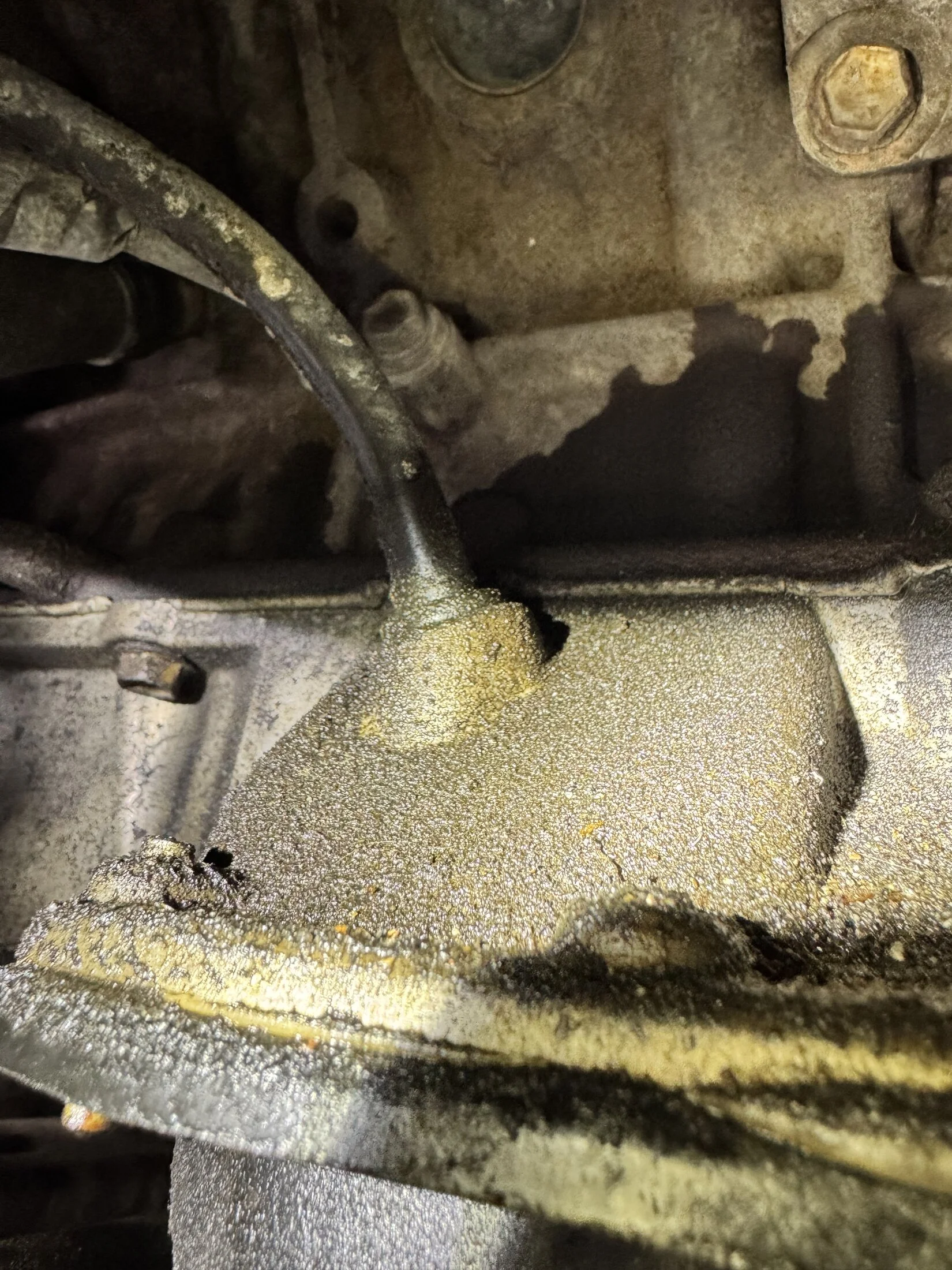

My gut keeps telling me it’s the upper oil pan gasket but my mechanic keeps telling me there’s no way. Could be steering rack, but the oil level doesn’t drop at all. I’m going to post up some pictures of the area that I think it’s coming from. Let me know What y’all think.
It also crossed my mind That it could be the dipstick tube but I think that’s the least likely culprit. Also not the valve cover gaskets. That area is clean as a whistle.
Excuse the crappy pictures. I was laying on the ground trying to hold the flashlight and get the phone to focus on the right thing. I’ll keep monitoring but see if something sticks out to y’all. These are driver side oil pan area.
Only an opinion... I would clean up the entire area and begin with the easiest repair.. the oil tube o-ring, when you do your next oil change.
I’ll start with the oring and see where that gets me. Thanks guys.

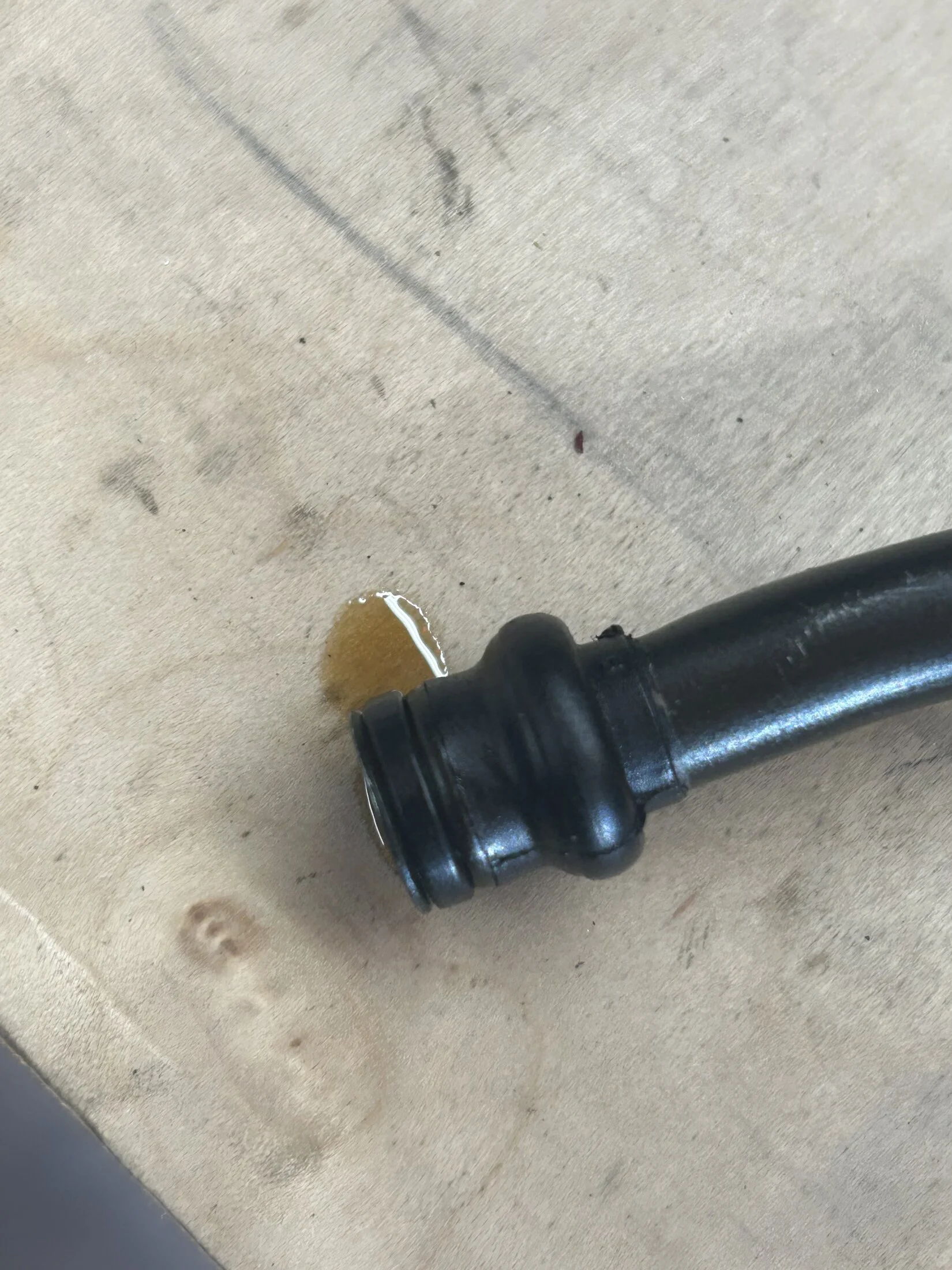

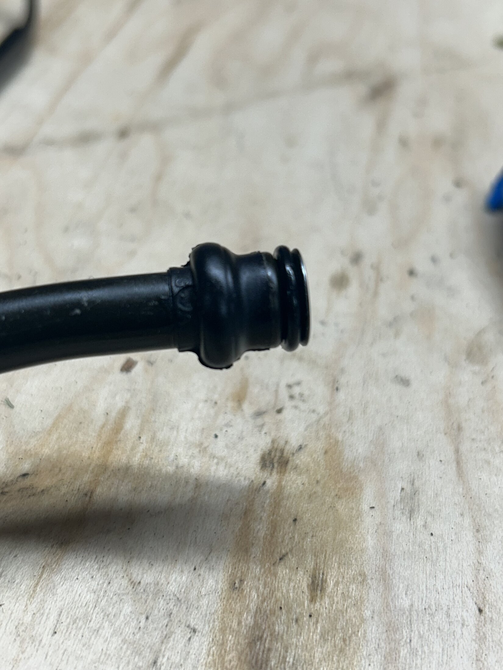

All dipstick O-ring, eventually weeps. The rubber O-ring shrinks with age. Over the years/miles, the oil builds up around pan. Eventually, moves around oil pan and forming a drip. Many have though this to be and oil pan leak. It's not a pan leak!
I thought I had a lower pan leak. I replaced the dip stick o ring and it stopped. But then I found the bolts holding my lower pan were barely tightened. I torqued them down and everything is dry. I did the UV dye and glasses and lead me to the two sources. I did an oil change after I replaced the dip stick o ring just incase I dropped some crud down there. So far no leaks. This all took place over the last two weeks. My dip stick o ring was completely hard and flattened. I will probably change it every other oil change just to be safe because it is pretty damn easy and cheap insurance.
This is what I found….
This is the replacement

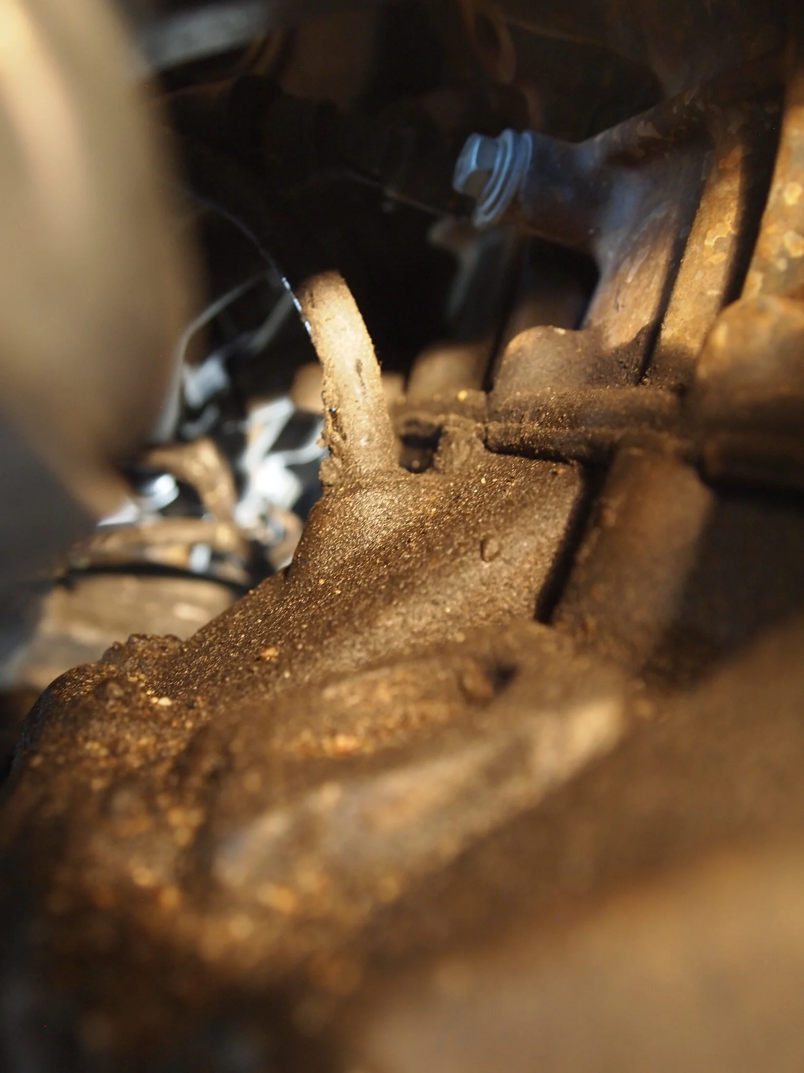

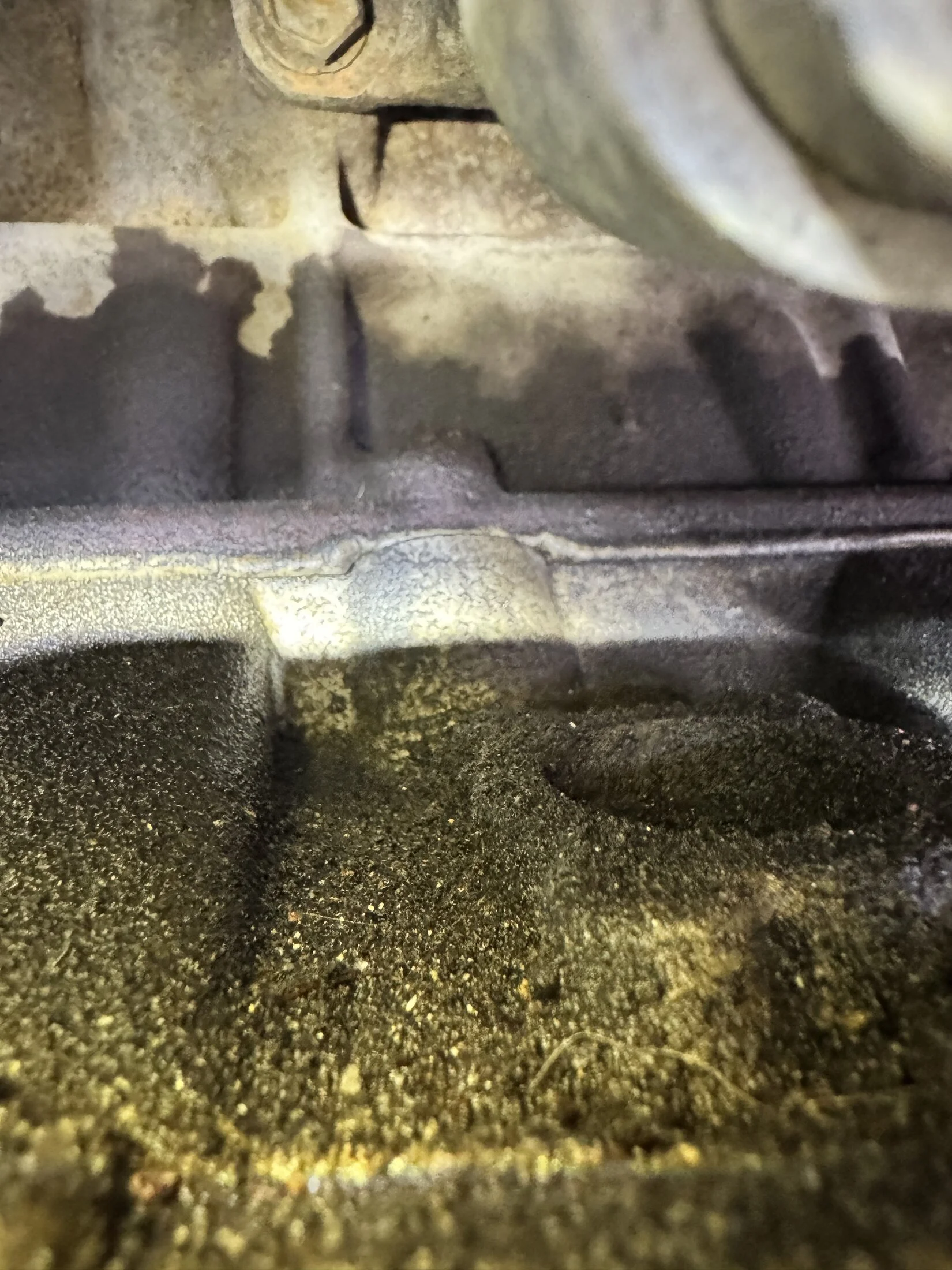

What happens is. As oil builds around the dipstick area, from its O-ring weep. Over the years, the oil builds up and spreads. Evenulty, enough accumulates, it moves down around seam of oil pan. Which appears to be a leak. NOT!.
If area cleaned really well, and O-ring NOT replaced. We'll see oil weep (sheen) only at dipstick seal (O-ring). We'll not see a any at oil pans seal. Or at least I never have as if today.
This is the replacement View attachment 3912324
