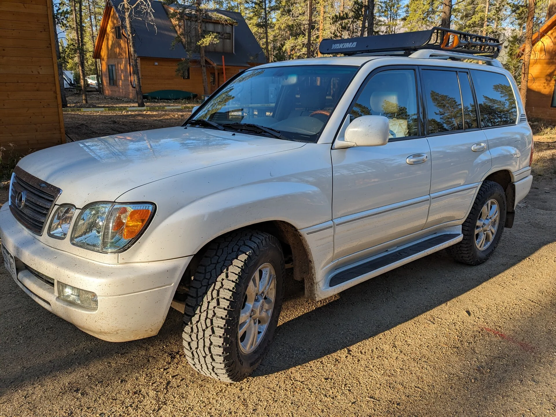

I've been on the hunt for some stronger tires ever since we started taking chunks out of the (otherwise excellent) P-metric Michelin Defender LTX M/S 275/60r18 that came fitted on Pearl. Clearly, the former owner had good taste but didn't primarily drive Colorado ex-mining roads. Running shoes are great until you start ripping them up on hard rock. When that happens, it's probably time to choose a hiking boot.
Use case:
-Roughly 50% off road driving by hours
-Regular drives from the high alpine in Leadville down to the Western Slope, Utah, Arizona, and New Mexico
-Truck is very stock, and happily so
Goals:
-A single tire that can safely manage packed snow at 0°F in Leadville in the morning, wheel competently at 75°F in Utah in the afternoon, and not drown out child entertainment devices during a few hours of highway driving in between
-Must fit in the spare tire storage area without hitch interference while using a range of accessories
-Speed rating of R or higher in LT metric
-Weight 56 lbs or less
-Tread spec'd to resist cutting and chunking
Those parameters felt like threading a pretty tight needle. Toyo AT3 has too low of a speed rating in LT form. BFGoodrich KO2 has only "OK" snow performance in the bitter cold according to friends in town. Wildpeaks are heavy and louder. I was spending more time reading tire threads than actually working on the truck...

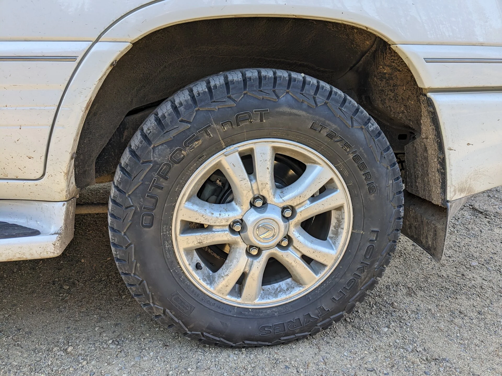

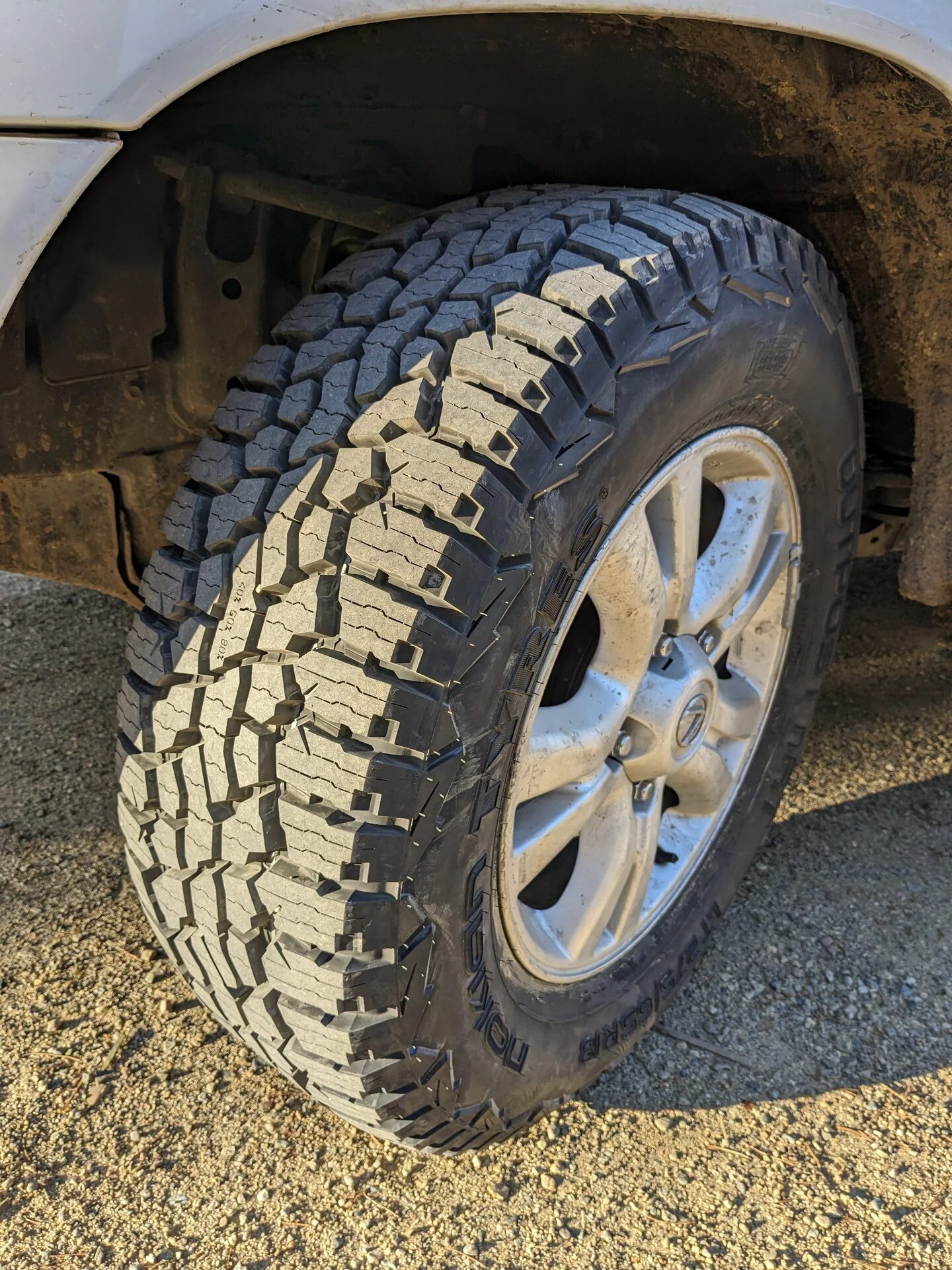

Enter the Nokian Outpost nAT. This was a model that I'd been excited about before in its earlier Outpost AT form, but stock dried up this summer as Nokian finalized the pivot to their new Dayton, TN plant. An excellent review thread for the older model lives on Expedition Portal. Nokian's reputation rides on snow and commercial mining tires, and the older reviews and current design bill seemed a perfect fit for my own goals. When Priority Tire got the Outpost nAT in stock last week, I ordered five.

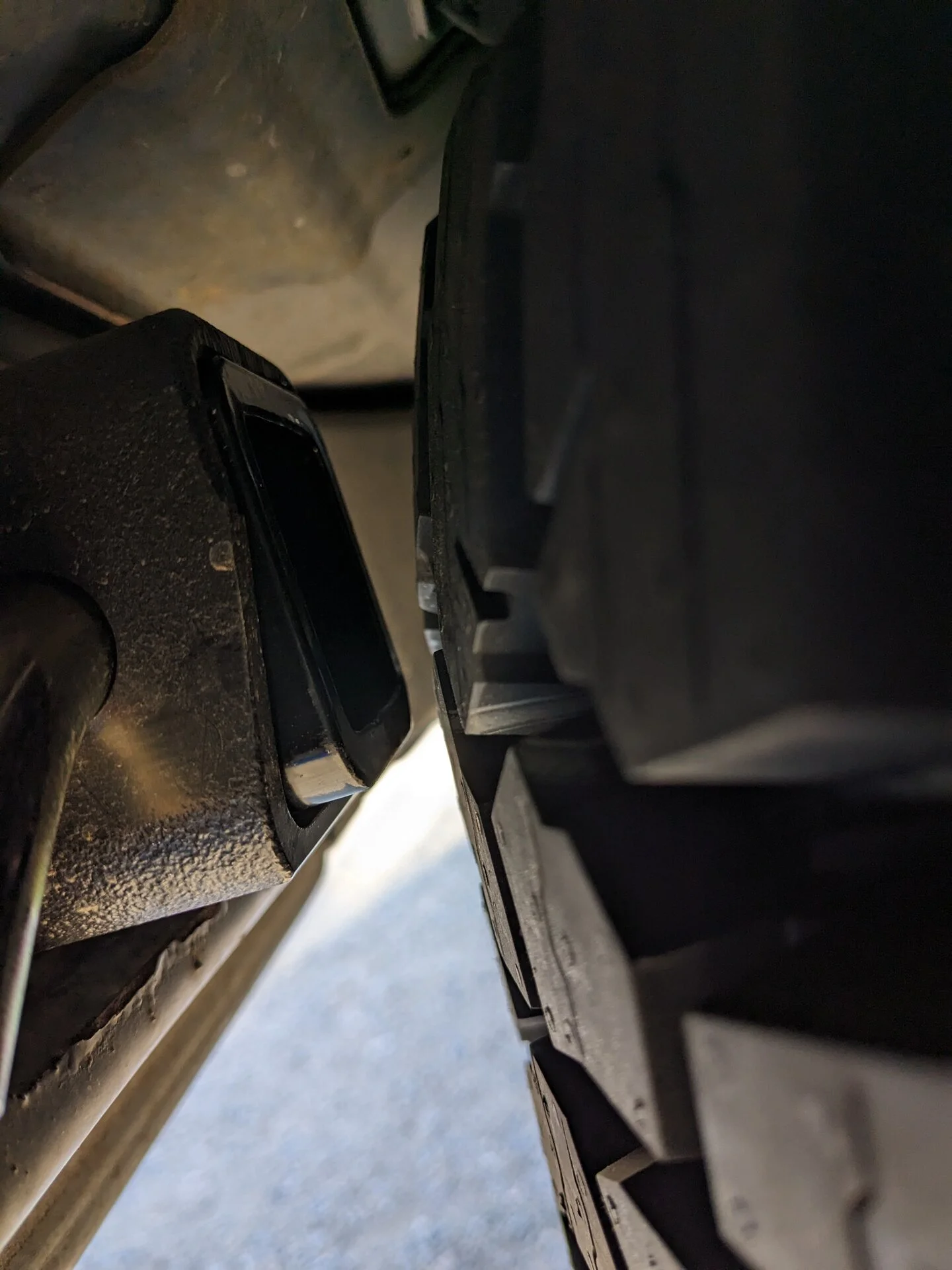

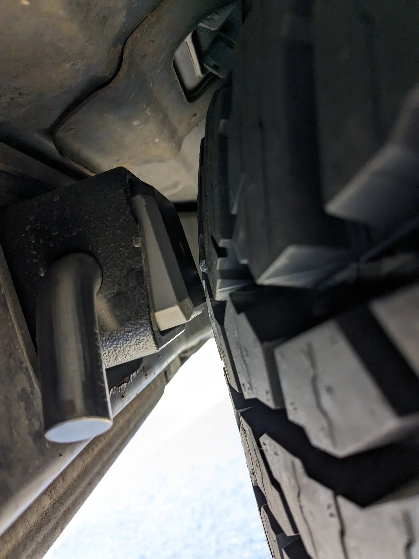

The LT version of this tire has 18/32" tread depth, and 275/65r18 is the largest diameter I would run with the OEM bumper hitch and stock spare storage location. See pictures below for how close this fits. First is an OEM Toyota hitch ball receiver, second is a Yankum Ropes Tow Points recovery bar. These are both known to be low profile, and clearance is still tight. Glad I didn't try to stuff a 275/70 in there!
Tires weigh a nominal 52.9 lbs each, which is more than the outgoing Defenders, but as I said--hiking boots.

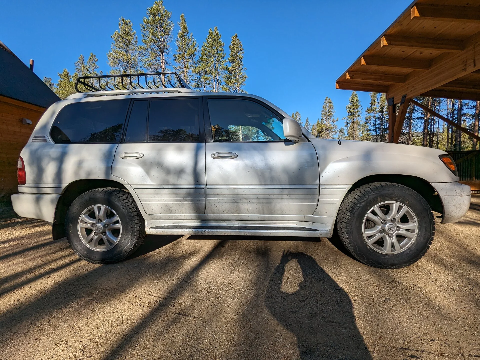

According to my shop, they balanced well and installed easily. And the look is fantastic.
These are shockingly quiet on road, with almost no additional noise compared to the Defenders at up to 90 MPH on pavement. I didn't push any higher than that...
Handling is actually improved, especially in twisties, which I did not expect. Steering is lighter and more precise, and lateral motion is far more controlled. The ride is firm, but not harsh. Acceleration should be slightly worse, but it's not enough to impact the way I drive.
Temperatures here are around 25°F in the mornings, warming to 70°F in the afternoon, and the compound seems to handle that swing very well. We will see how they do once the real cold and snow arrive.
I will update as miles accumulate and I get a chance to run these in more conditions. Very happy so far!
Tires are made in Dayton, TN USA.
Nokian is a Finnish company and their Hakkapeliitta line of winter tires are legendary in the northern US, Canada, and Alaska. They do a special model for Arctic Trucks.

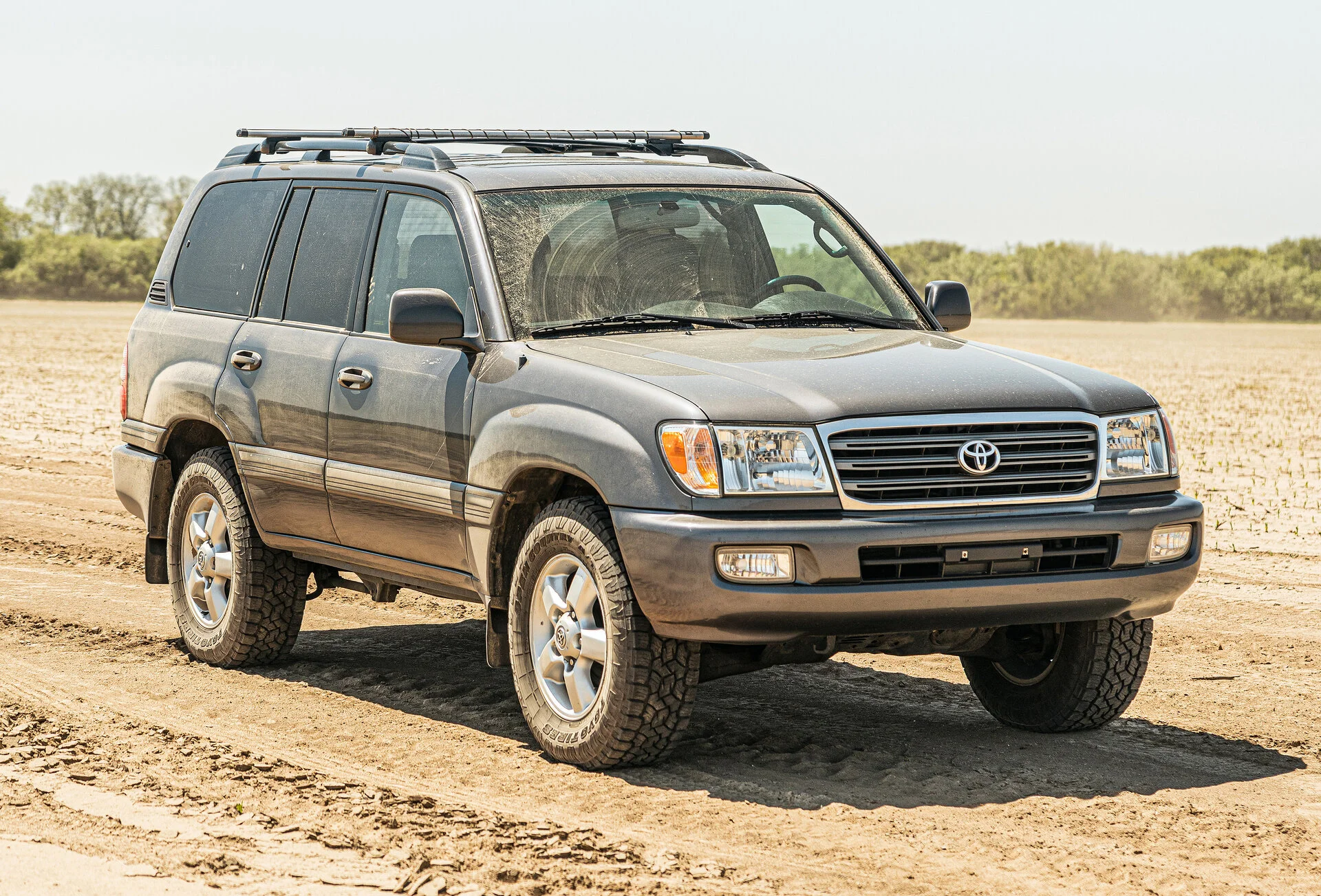

Thanks for the info sheet, I've been looking for as many specs on these as I can find and this really helps. I've been running the 265/70 r18 Toyos for about 3 years now and haven't noticed any real difference coming from some 275/65 r18 Continental Terrain Contacts (except the road noise). I wanted a slightly taller tire without the extra weight. I really like the Nokians you have and called Discount Tire yesterday to see if they had them yet – will know next week as they're so new and not in their system yet. You still liking the ride on road too?

You have a great looking truck! For the Nokians, 265/70r18 and 275/65r18 have identical weight in both P and LT-metric. Did you find the the additional height of the 265/70 vs 275/65 to be helpful off road, or was it more of an aesthetic improvement? No judgement on either, but I am curious how much benefit I'm missing with the shorter tire. Glad to know you didn't find a difference in on road handling.
Priority Tire is a newer company (15 years old, I think), but they had a great price and seem to be a legit outfit. They have discounts for teachers, military, and first responders, too, so this set came out to $1360 shipped. I think the major downside is giving up the physical location access and road hazard coverage of Discount...
You have a great looking truck! For the Nokian's, too, 265/70r18 and 275/65r18 have identical weight in both P and LT-metric. Did you find the the additional height of the 265/70 vs 275/65 to be helpful off road, or was it more of an aesthetic improvement? No judgement on either, but I am curious how much benefit I'm missing with the shorter tire. Glad to know you didn't find a difference in on road handling.
Thanks man! I really did not notice a difference on or offroad relating to the tire height. The Continentals were great for my usage but wanted a taller more aggressive AT to better fill the wheel well and balance out the size of the cruiser. I did crank the front torsion bars to get about another inch of height as it had sagged some over the last 20 years. Keep us posted on the Outpost ATs and once I get some I'll share my experiece as well. I did a thread on the Conti's a while back but wasnt as good at documenting the Toyos:

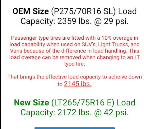

This tool HERE is handy for converting pressures for the same load rating when going from P to E for other folks out there.
Example for my particular tire specs
