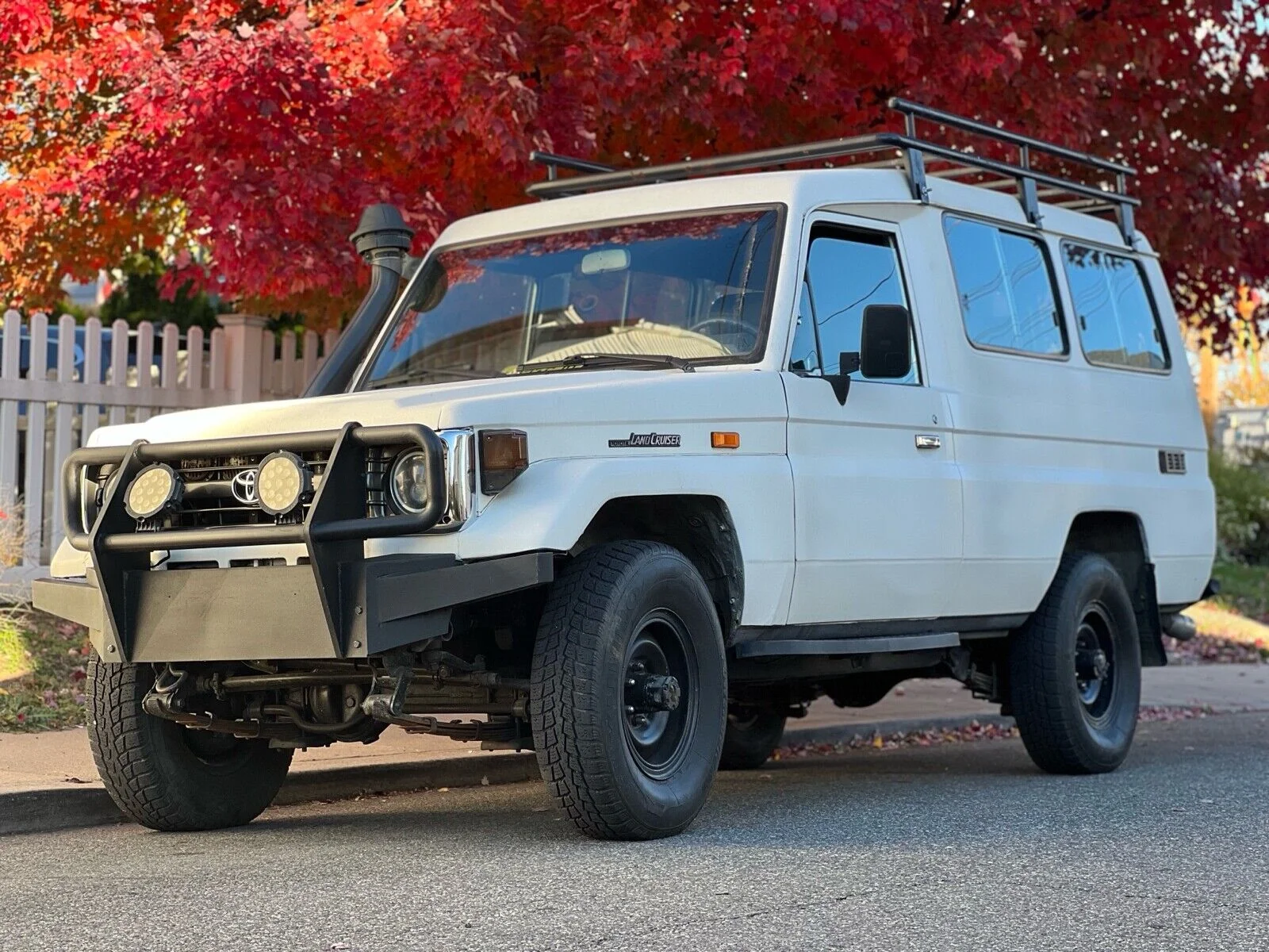

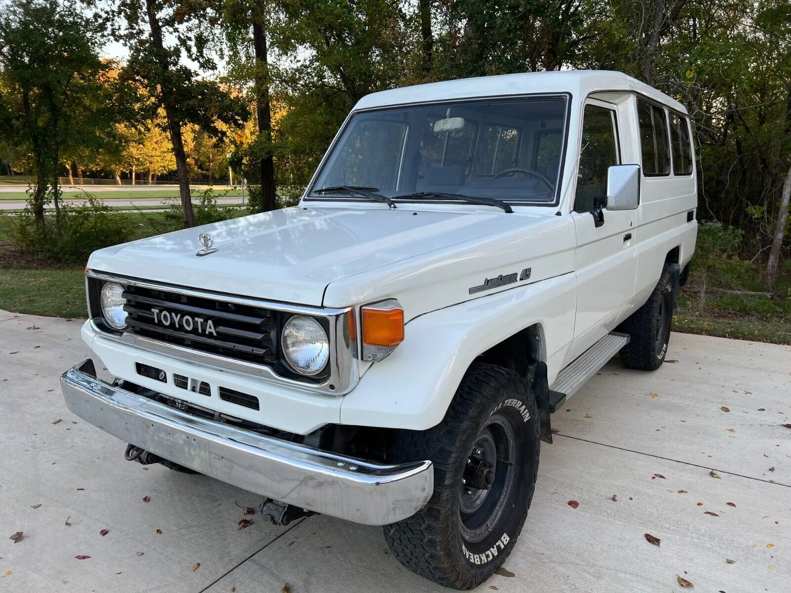

Hello, new to this corner of the forum, coming from a 100 series but want more room so looking into building a troopy. Can some of you who know what's up chime on on the merits between the two of these? One is a 1FZ with 250k miles, no rust or mods. Super clean in TX. The other is a 60k mile 1HZ out of NJ originally from Georgia, also with no rust. It does have a reserve tank in the rear, and bumper (the front is a bit clunky but good enough for now). It is also unfortunately fully raptor lined, but I can remove that later if it bothers me. I know coming from the UZJ I'm going to be going much slower, and the HZ is the slower of the two. Can anyone speak to which they would buy based on how they are equipped? I do a fair amount of highway so speed is a big plus. But so is longevity. And also most of my camping is done in the freezing cold (down to 15 below at times) and above 9k elevation here in CO in the winter, so I'm wondering which engine will be better for that. On price the FZ about 5k cheaper, and to drive home after purchase about half the distance or less. But I need to add heat because it is AC only.

You will hate the 1hz and want to turbo so add that or a hdt/ft upgrade.
Adding heater is pretty easy. Buy the fz.

Yeah I'm leaning towards the FZ, but a guy who has seen it in person said something about the paint hiding bondo. There is one on Mud I'm interested in that is well sorted but its 10k more and on the east coast. Hard to decide when not seeing them in person.

I inspected that particular "super clean" FZJ75 for a client and walked away . It needs a lot of work before it is up to US daily driving . Just go look at them in person and drive them to see what you are getting and what is right for you . I always been a diesel guy and 1HZ troopy would be my start

The HZJ75 has a hole in the door that should not be there. There are paint bubbles that may be from overspraying, or from rust. Hard to tell, and suspicious. The paint fairy seems to have visited the frame and drivetrain.
The FZJ75 looks like it needs work in the frame, body and drivetrain. It appears to come from a dry climate. No interior photos, which is a red flag. There are two charcoal canisters in the engine bay, which is suspicious. The altitude compensator valve is missing. The sparkplug covers seem to have been sprayed.
The 1HZ engine is slow but reliable. It is not made for American roads. You can add a high-altitude compensator, a turbo and an intercooler, which help a lot but comes at a cost if you want it done properly.
The 1FZ engine is powerful but thirsty. It can handle American roads in its carbureted form. A combination of lean mix and care with your right foot can help with the fuel mileage.

Thanks Juan! Great info! I am having a hard time with the Texas eBay 1FZ as it just seems like a Pandora’s box. The Jag has too much left for me to do including at least heat if not AC, plus welding new panels etc. So I am leaning towards this 1FZ in NC that seems to have been taken care of like I would have.
