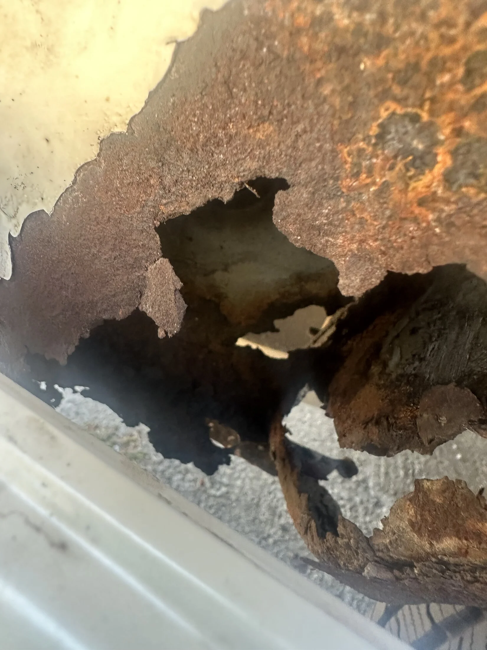

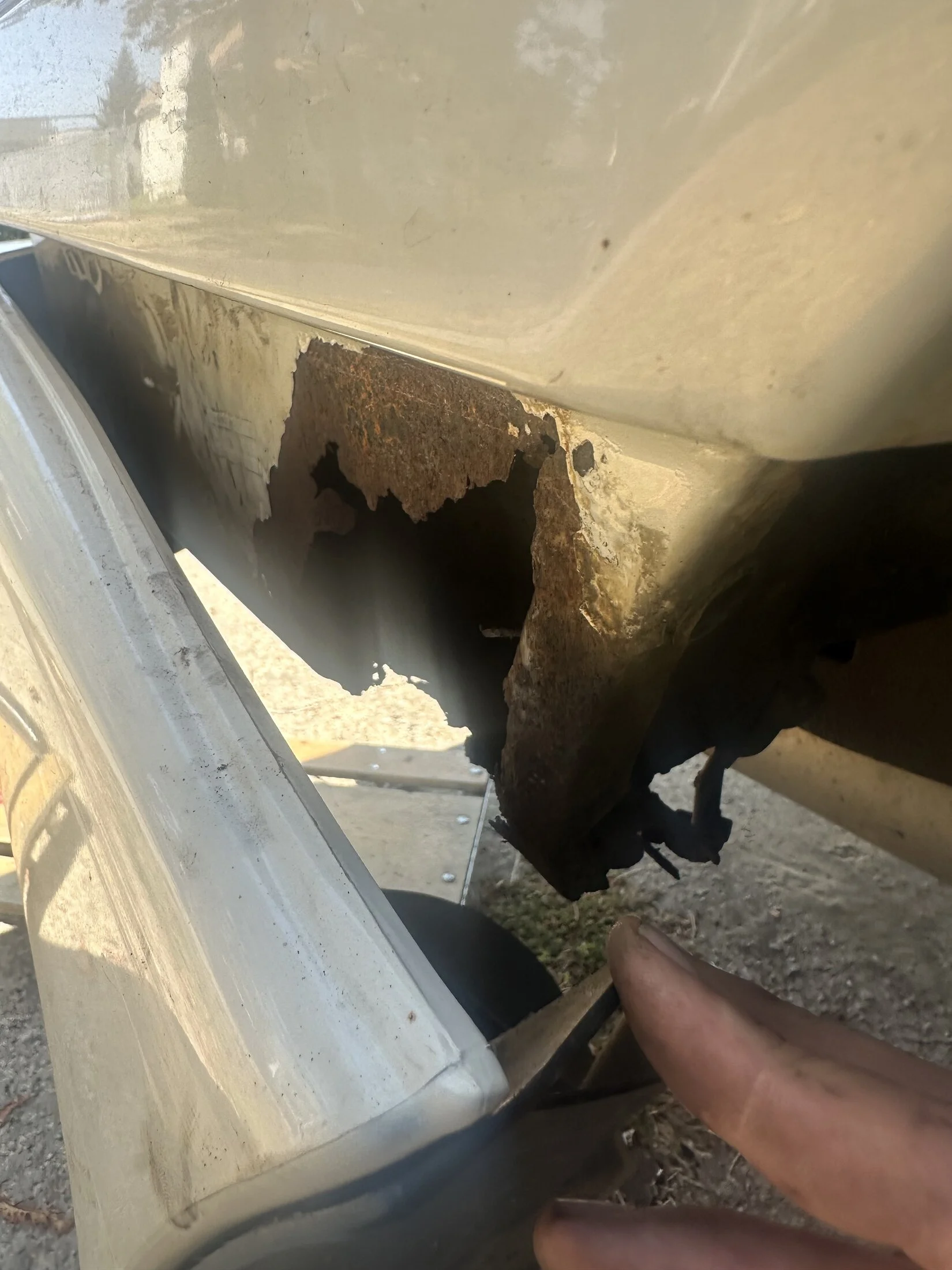

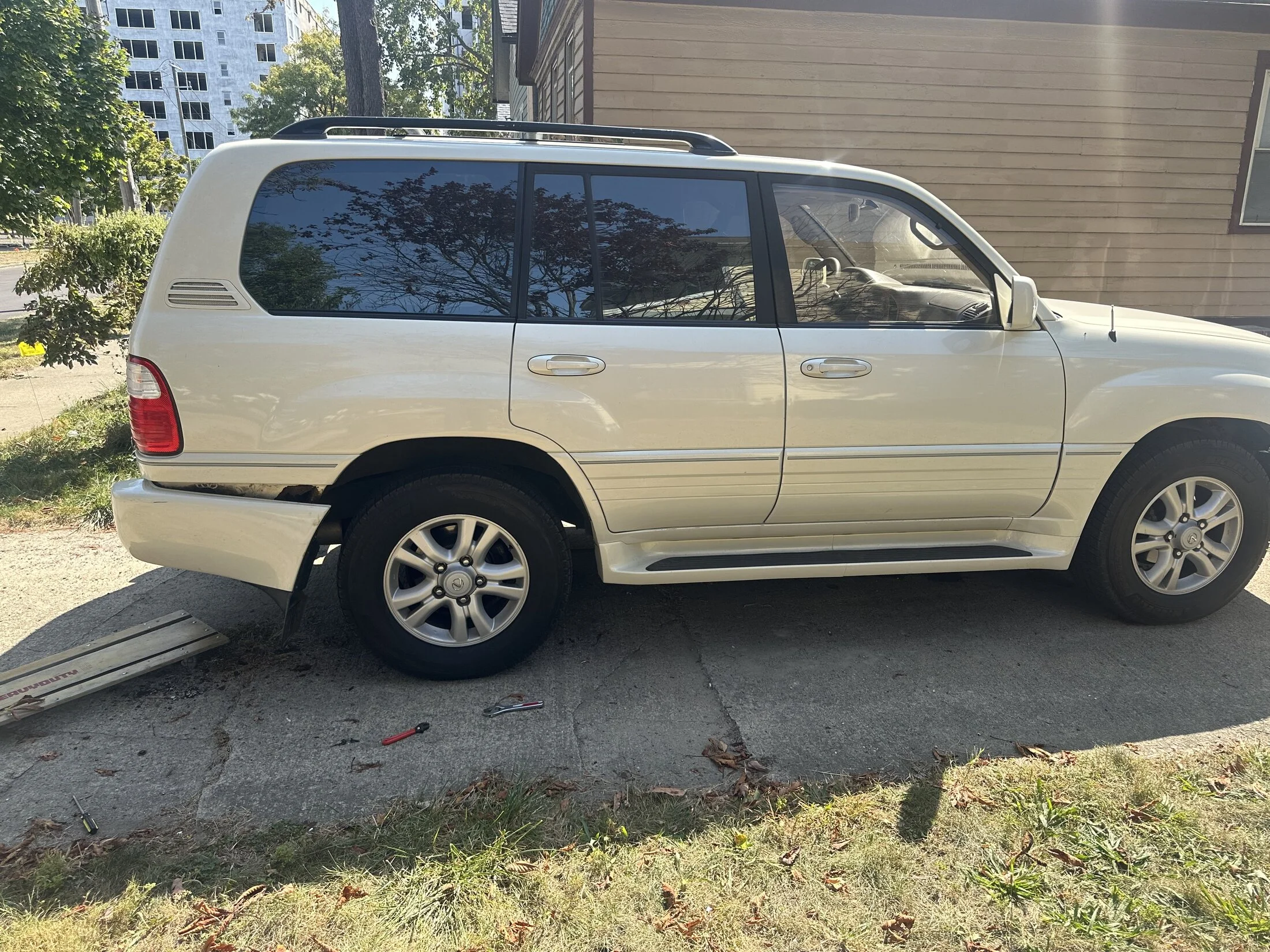

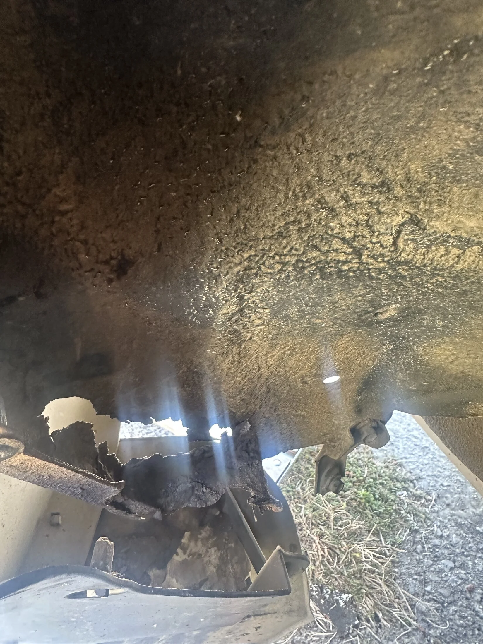

More pressing, and my reason for starting this thread, is the rear section of rust. I had erroneously believed it to be a small spot of rust originating from inside the cab (maybe a leaky rear ac condenser), and I briefly strayed from the iceberg principle of rust discovery -- that you can probably only see 10% of it without digging into things -- which is always a costly lesson.
When I believed this was just a hole in the back passenger side, I felt like I could patch it on my own time. Now, as the attached pictures indicate, I think I am running the risk of losing the rear bumper mounts sooner than I would like. So I'm reaching out here to see if anyone has any input on how I might approach this repair. What is this panel called?
Welcome. Mine rusted same spot too. Just cut it out and weld the patch closed. Good video on YouTube about it where they did it really well. You don't need to use a panel you can just cut sheet metal.

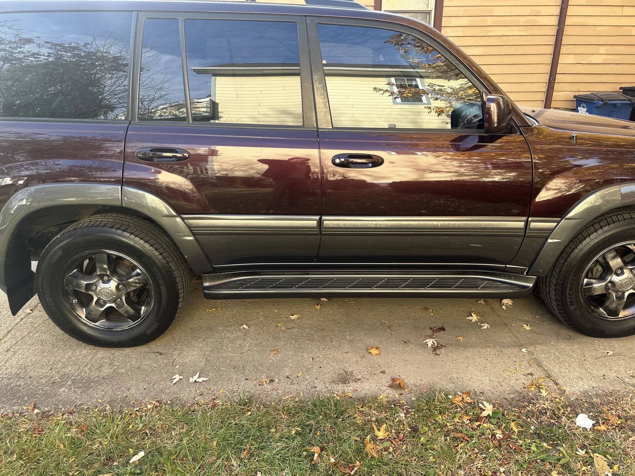

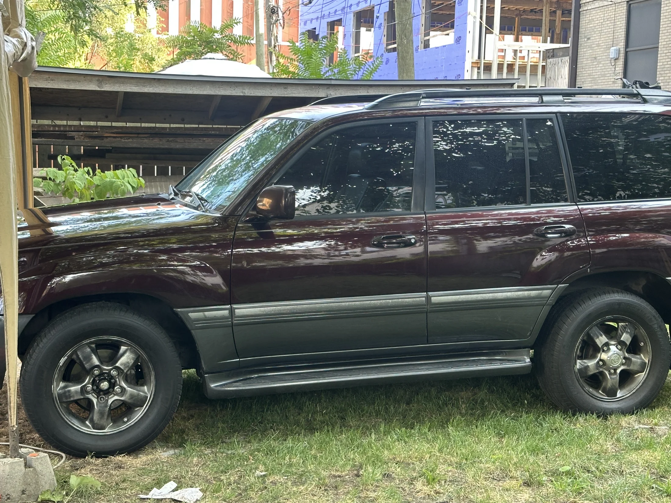

An 06 Landcruiser with 295k miles and factory AHC delete. No DVD players in the seats or anything, but has rear AC and NAV.
I followed a build thread of 2001LC on here where he titled a similar car Merlot. I am thinking of calling this one Franzia.
The service records on this leave a bit to be desired. It was listed at a dealership in texas for a bit over twice what I paid.

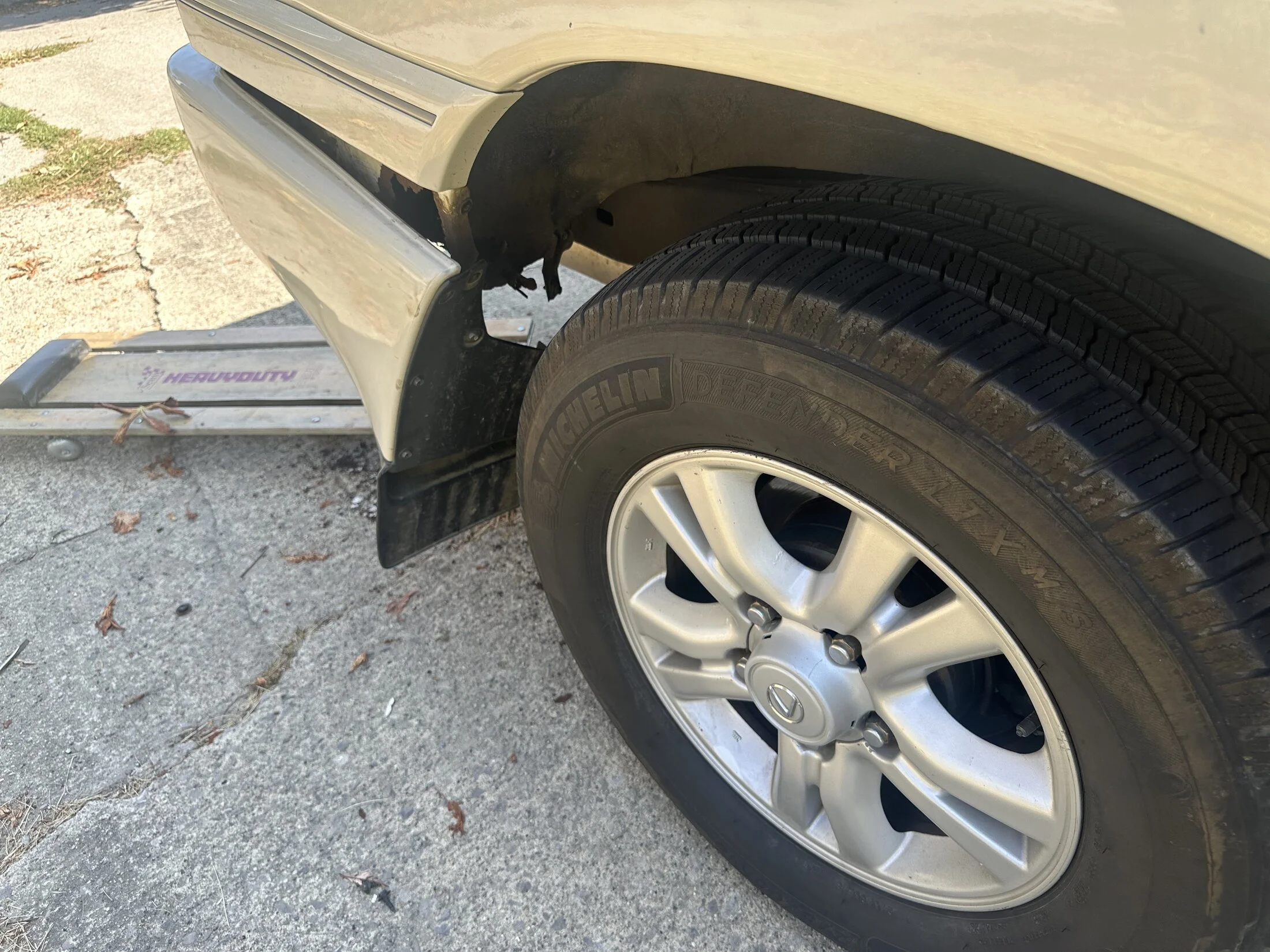

To start with, I was thinking of removing the plastic fender covers. In the Merlot build thread, when 2001LC posted about doing so, someone said something like 'be careful'.
Is there anything I should be mindful of?
Oh yeah, and it looks like someone was a bit too aggressive with a cleaner on the hypersilver wheels... I think I have sourced a better set of those, and I'll use these ones for winter tires at some point. I dont hate how they look... From the reading I did, it seemed like getting them repainted was perhaps not a worthwhile endeavor.
Nice find!! Good to start with a less rusty rig glad it worked out. I just removed flares and did not have much issue. Just time consuming as some of them came off clean and others left a lot of the adhesive that was a pain to get off. Not sure where you would need to be careful. Love the color.
I would leave them on until you have made a plan and budget for any upgrades and fixes it may need. Start with a Woolwax or Fluid Film coating, get all the mechanical issues sorted out and enjoy it for the Winter. Come Springtime, let the upgrades and mods begin!

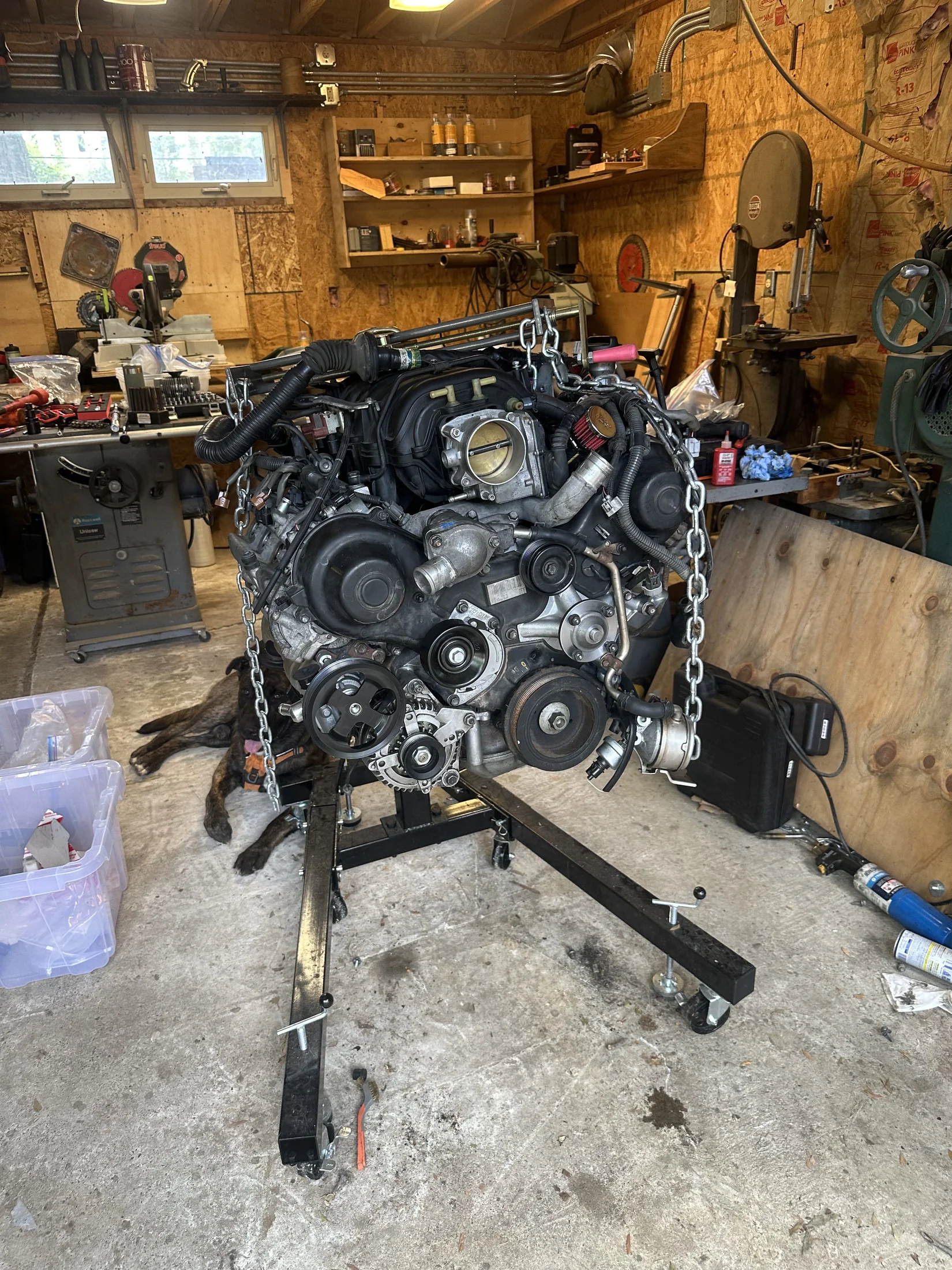

Then I moved Franzia into the garage to prepare her for surgery.
The plan is to do timing belt/water pump, cam seals, steering rack / hoses, valve cover gaskets, oil cooler o rings. This is kind of a shotgun approach based on things I saw that seemed to be leaking, and getting into all of this would give me a good opportunity to really familiarize myself with the engine.

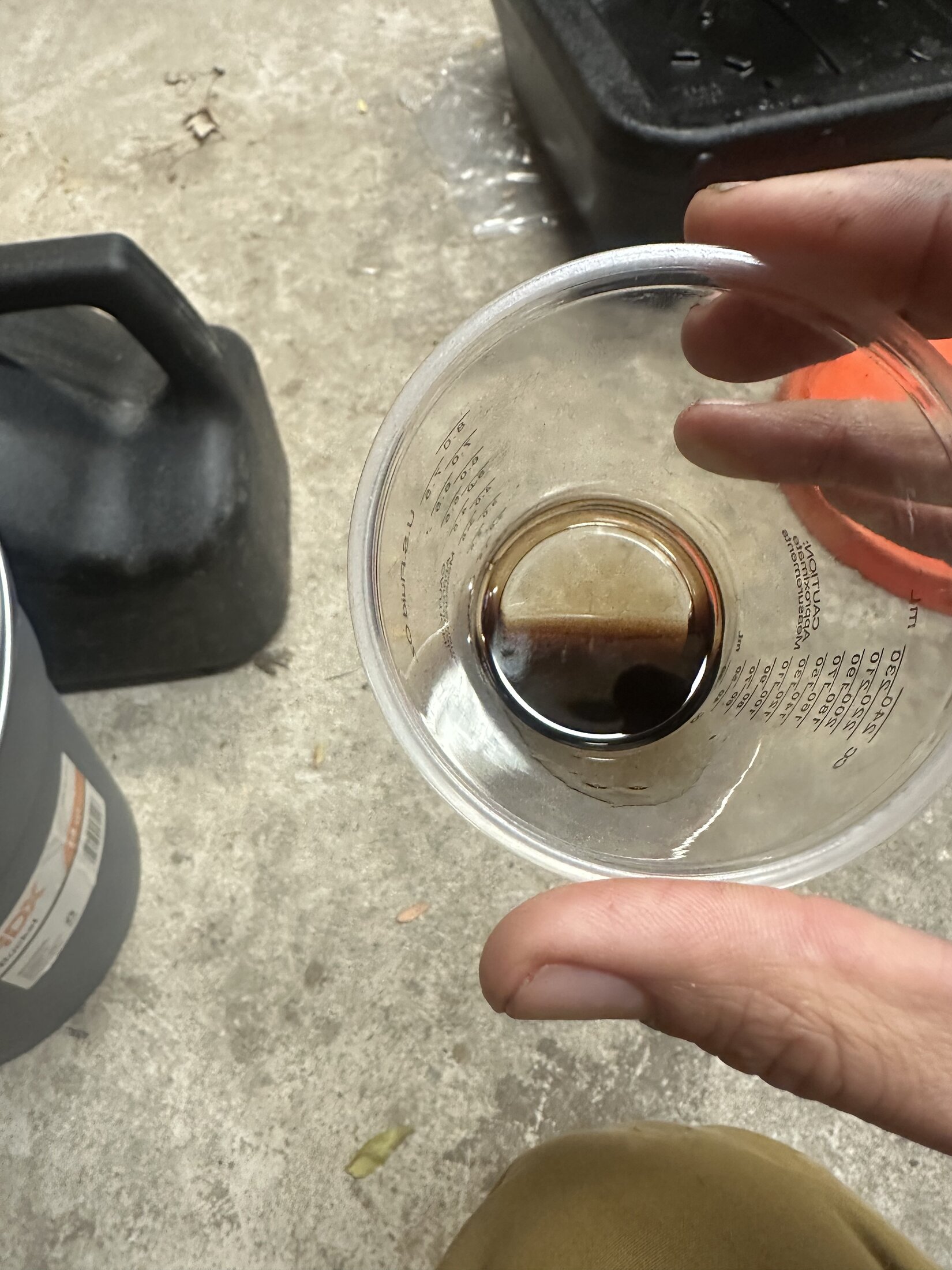

This was the first unwelcome surprise. The trans fluid smells okay (not burnt), but it's obviously very dark. Once Franzia is put back together, I will do the fluid exchange as described by 2001LC, and test for myself the limits of the possibility that this could shock and destroy the system. It pains me to say it, believe me, but if this spent fluid is the only thing holding the transmission together, I would rather bite the bullet now. But right now I'm still hoping I get lucky.

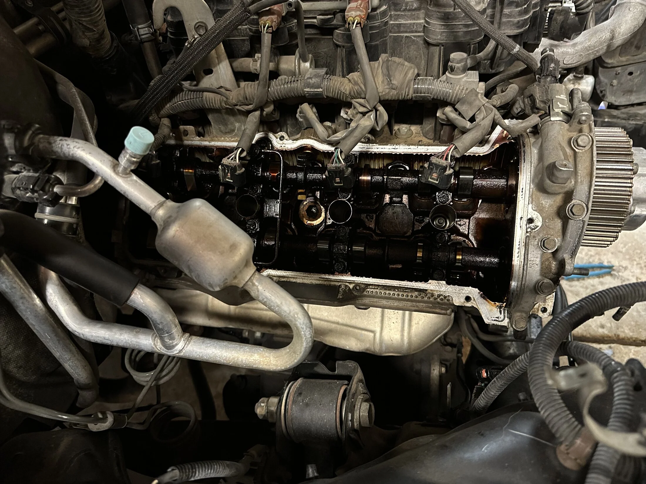

I decided to try and cheer myself up by looking at the valve cover gaskets. I just watched a video by a guy where he remarked on the cleanliness under the valve covers as being a good indication of engine health.
It's probably not a good sign that I immediately went and googled "valve cover sludge 100 series ih8mud" and didn't find many results.
For whatever reason, the drivers side appeared a bit 'better':
So I think the window has closed on anyone remarking at what a wise and prudent purchase I made. To me, the car drove great, so I am hoping that this is kind of like a C- student that will still be able to get a diploma and be driven, at the end of this. I would appreciate putting in perspective how bad any of this is, or if its not a huge deal, that would be encouraging.

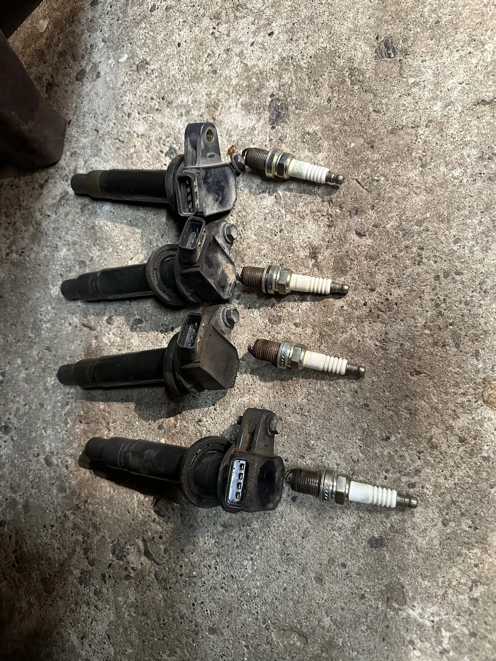

Above are the passenger spark plugs
The drivers side spark plugs are in much better shape.

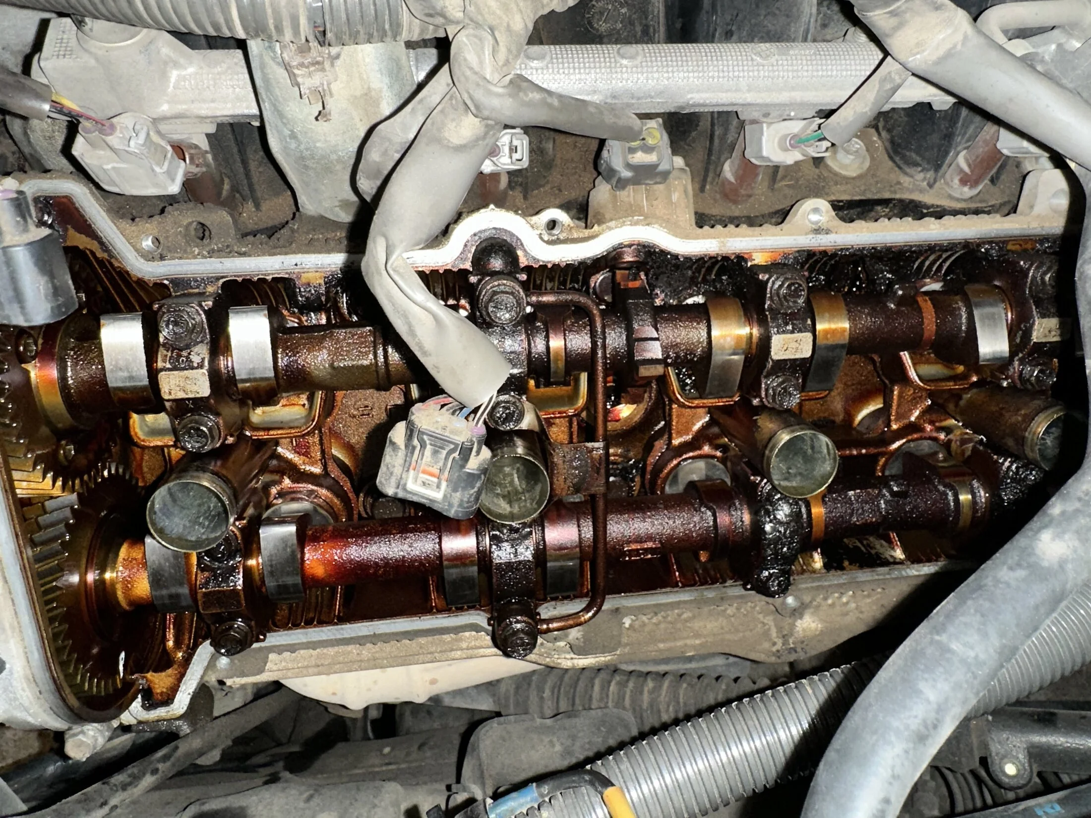

I am going to take out the cams to do the seals, and I figure that would be a good time to address the sludge thats present here. Is that true, and are there any pointers as to how to do so?

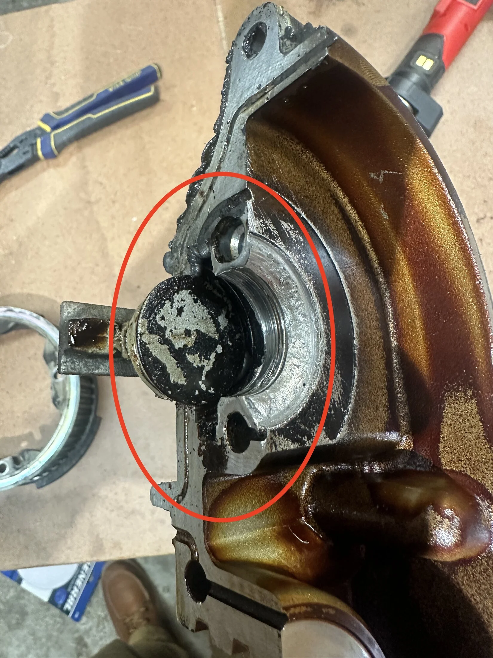

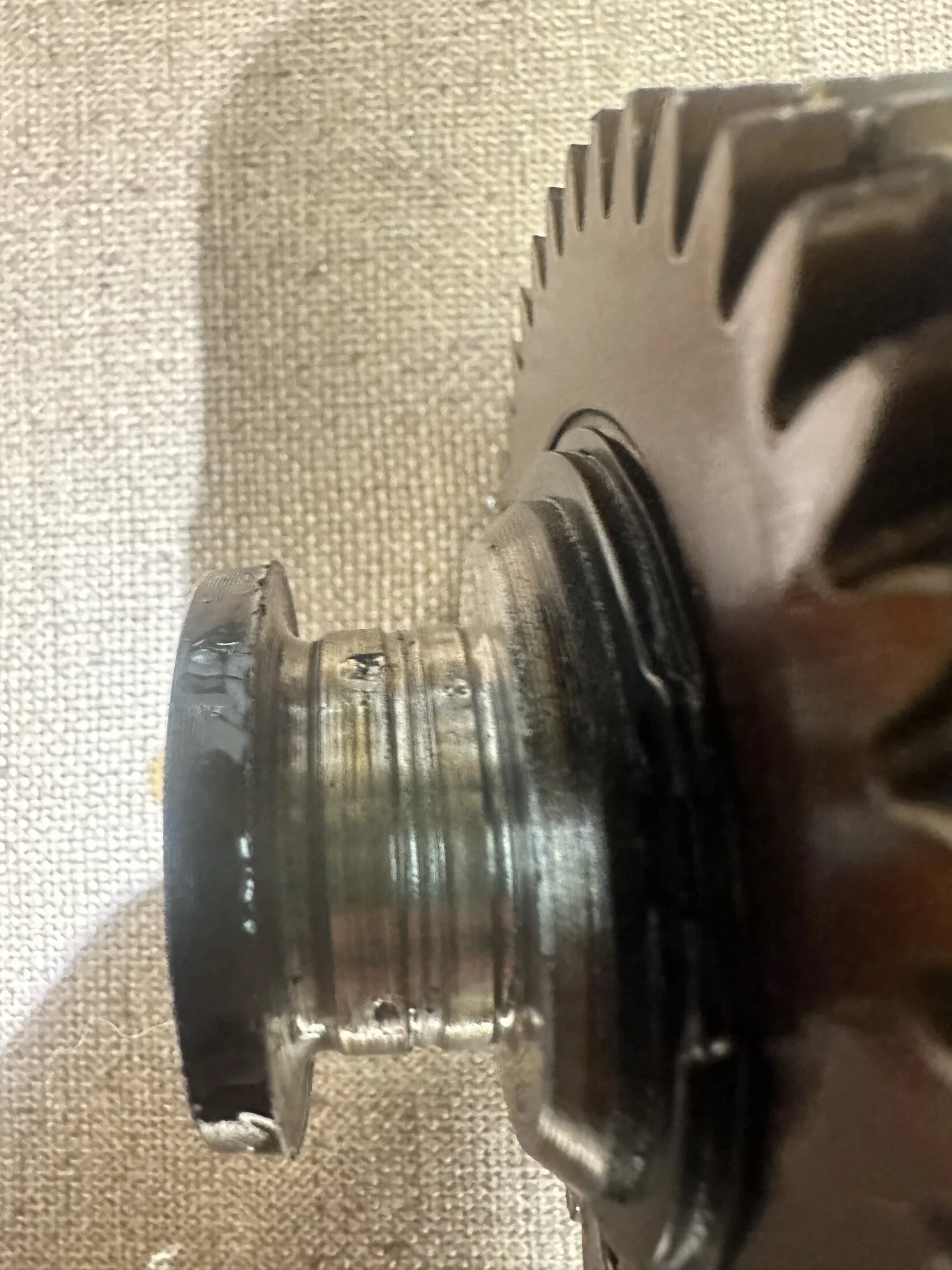

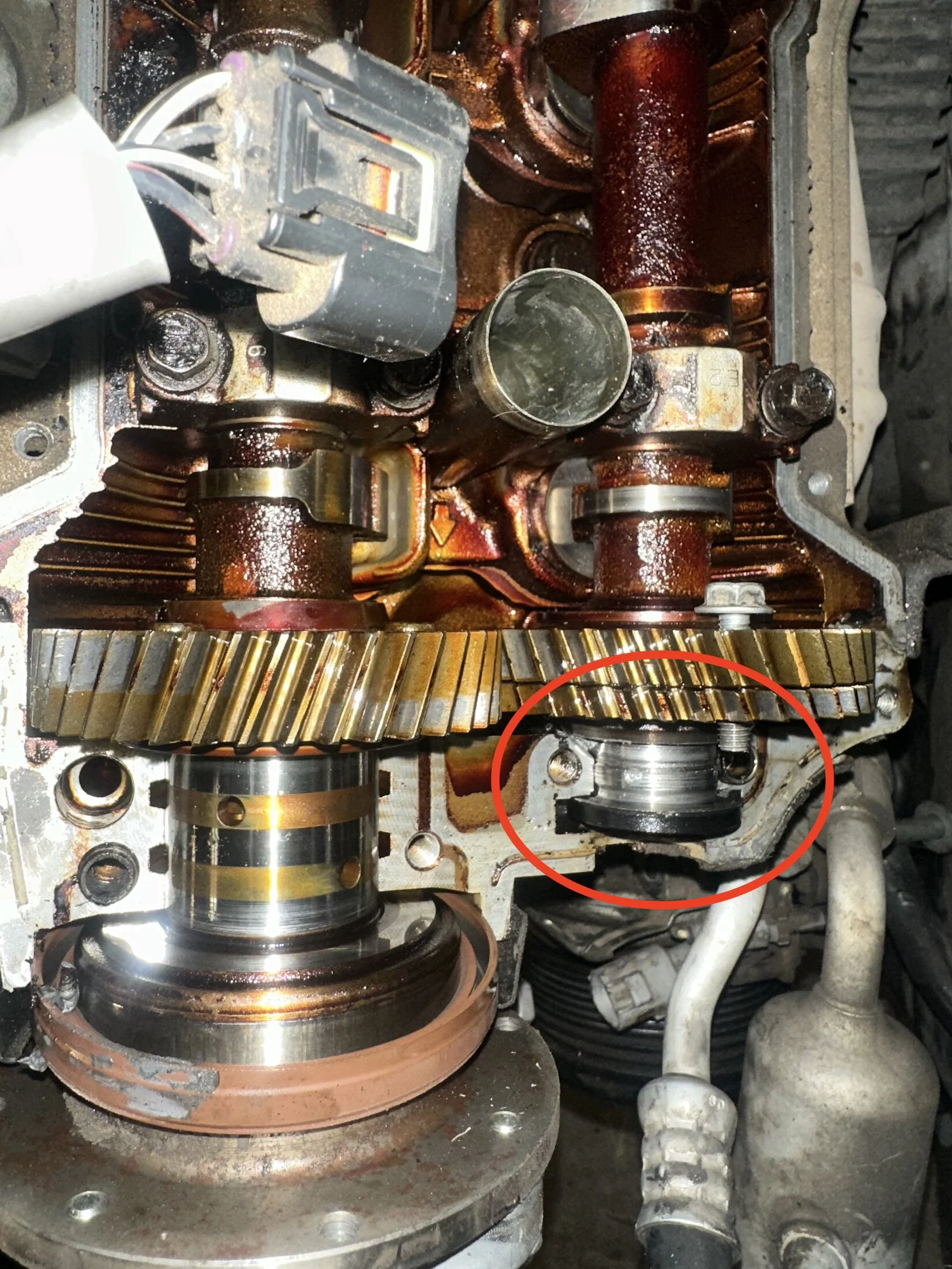

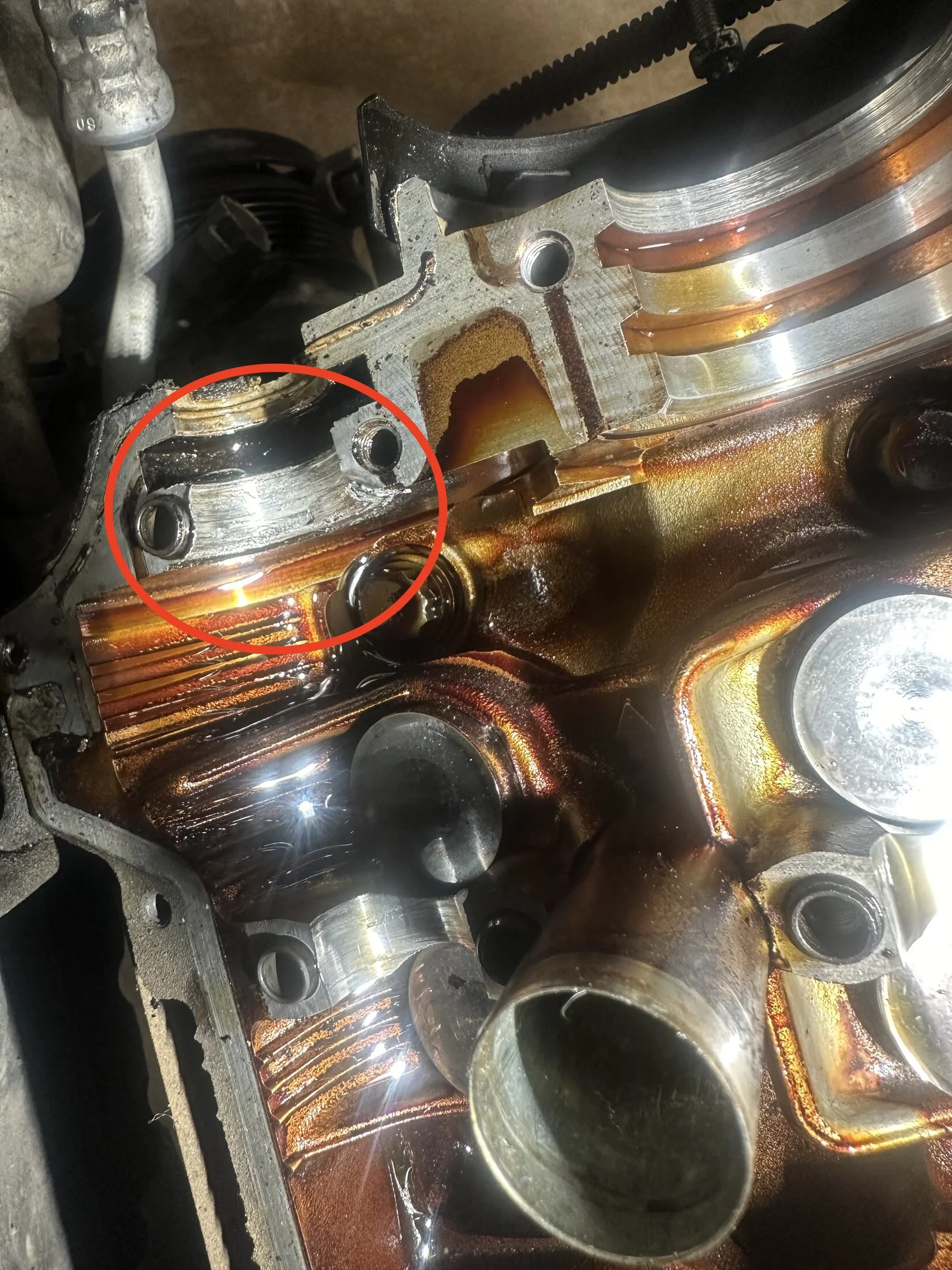

So I have progressed to removing the cam shafts to do the seal and clean the area. I've uncovered a problem I need some advice on:

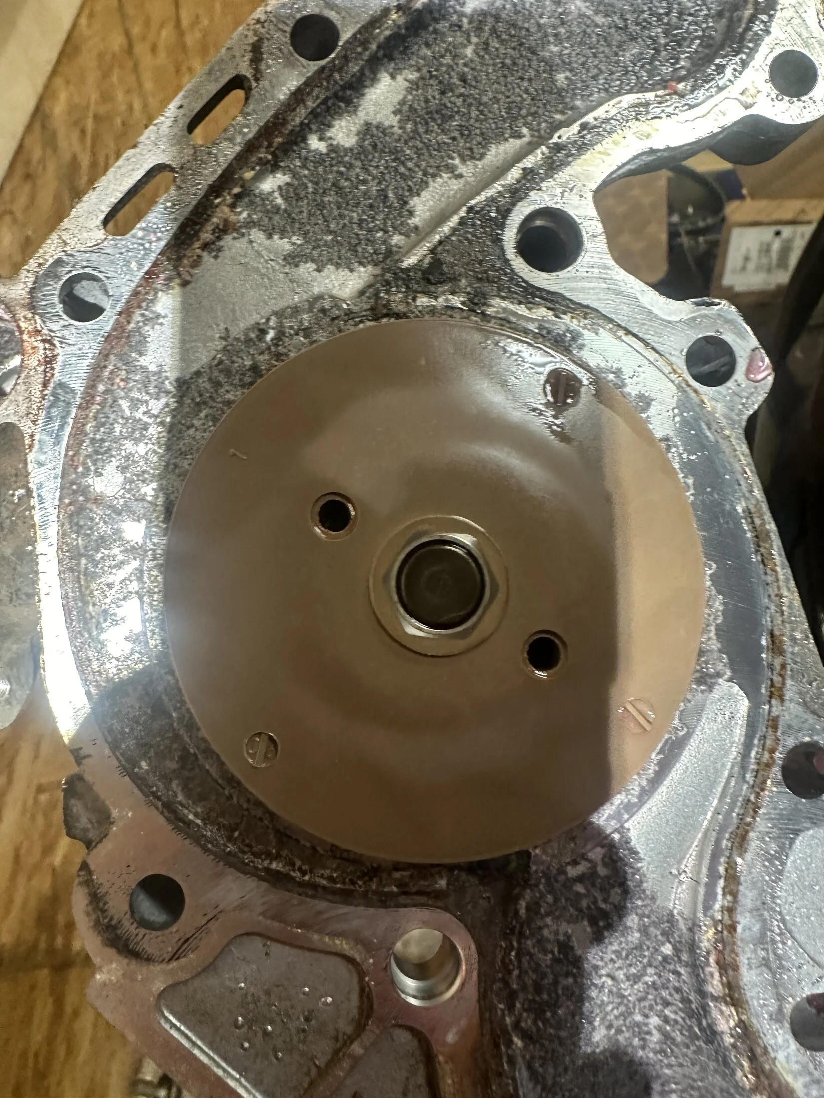

So, I wasn't expecting any miracles after the valve cover sludge eased me into this. However I am concerned by the damage at the 'front' of the camshaft.
I am tempted to replace the camshaft, and the scored top piece, as those would be 'easy' and I'm inclined to think that that would be a decent bandaid, but I'm not exactly playing with a full deck of mechanical knowledge. To fix the scoring on the bottom, I think I would have to source a new head, which, honestly after seeing all of this, I have no problem replacing the engine at some point. But I really would not like to do that right away. I am enjoying learning all of this, and accept that the lessons are often tough when you are dealing with this kind of neglect. So thoughts on how to proceed and how severe what I'm looking at is, would be very helpful!
Get to place where you've shop to work in. Replace the engine. It was run without oil change for 30, 40, 50K miles, and likely run low on oil. Crankshaft, bearings, cylinders, oil rings, oil pump and more likely damaged.
