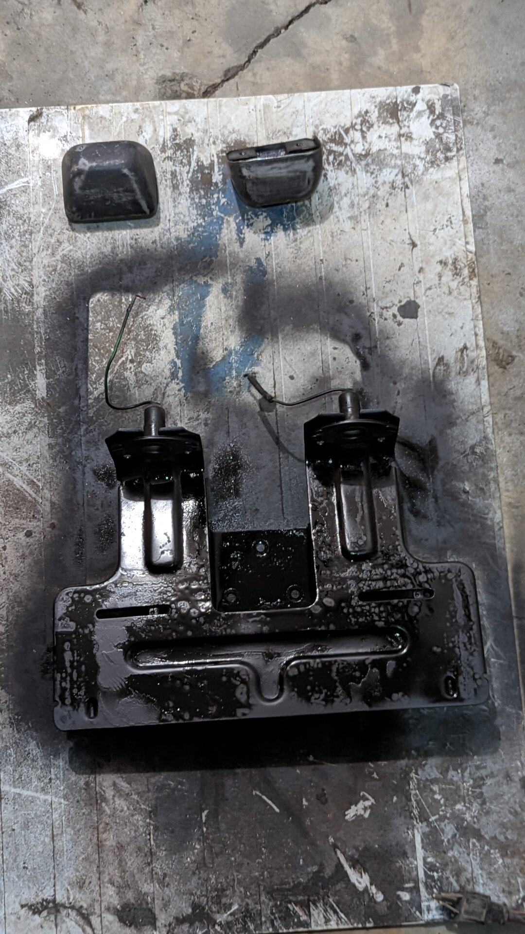

Pulled off the license plate holder and after wire brushing and rust converter I also painted that with the POR topcoat.

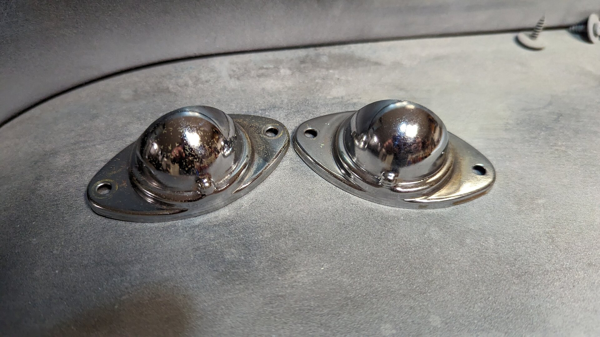

Got out my Dremel polisher attachment and polished up the license plate light bulb holder thingys. Turned out ok.

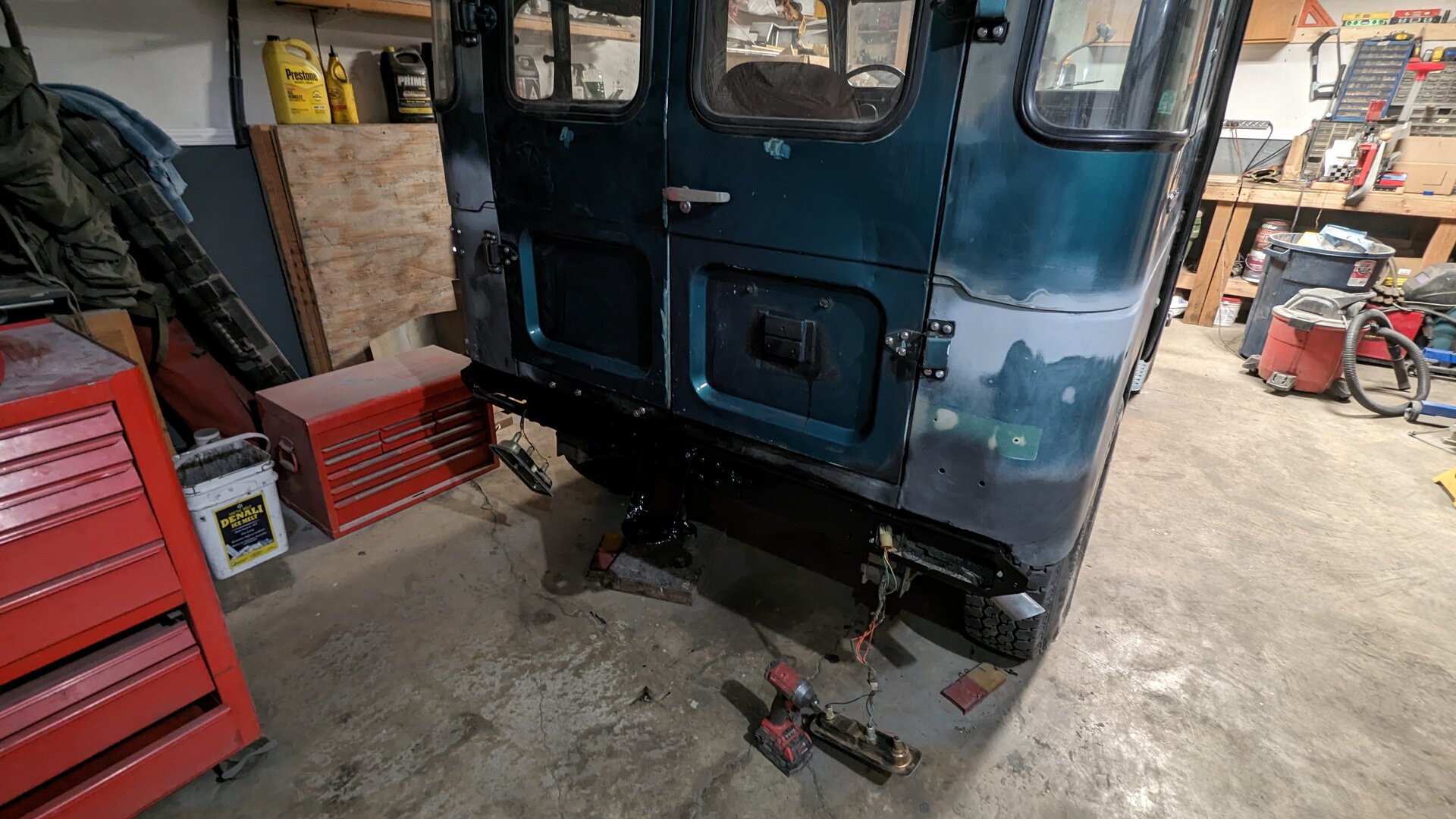

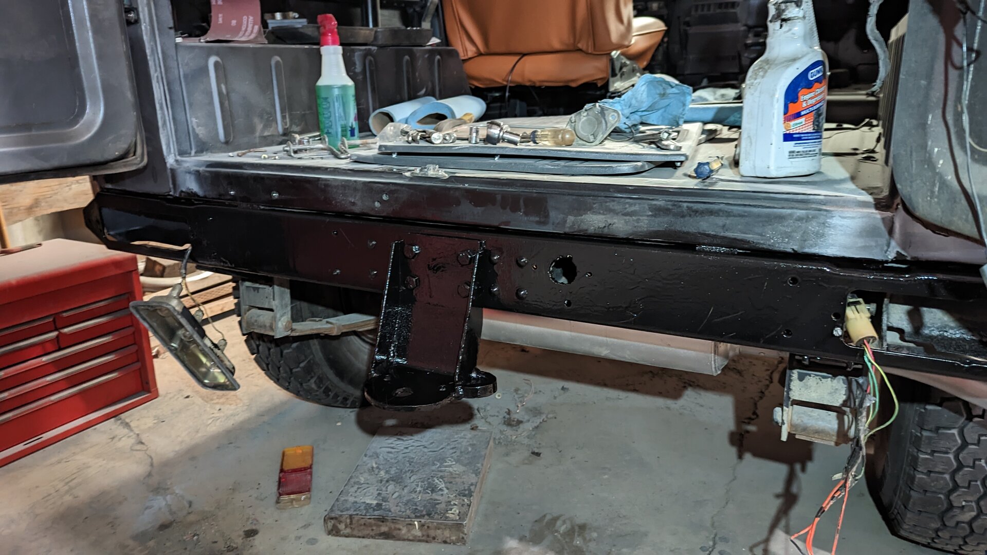

And to bring this thread fully up to date, here are some pics of the body as it stands today. New rear quarter panel basically ready for paint. Dented fenders pulled and filled and ready for disassembly, final rust repair, and paint. The hood is even more camouflaged than ever with black primer, green etch primer, white filler and the green under paint.
And I installed the driver's seat to mount the brackets, drill the holes and weld on the capture nuts to my new driver's side floor plan. Looks very sharp in my opinion. This is shown fully back as far as can go. About 1/2" away from hitting the rear wheel well actually. Also it's about 3/4" higher than factory. Much nicer for some much needed leg room. And it's fully convertible if you wanted to return to the stock configuration.

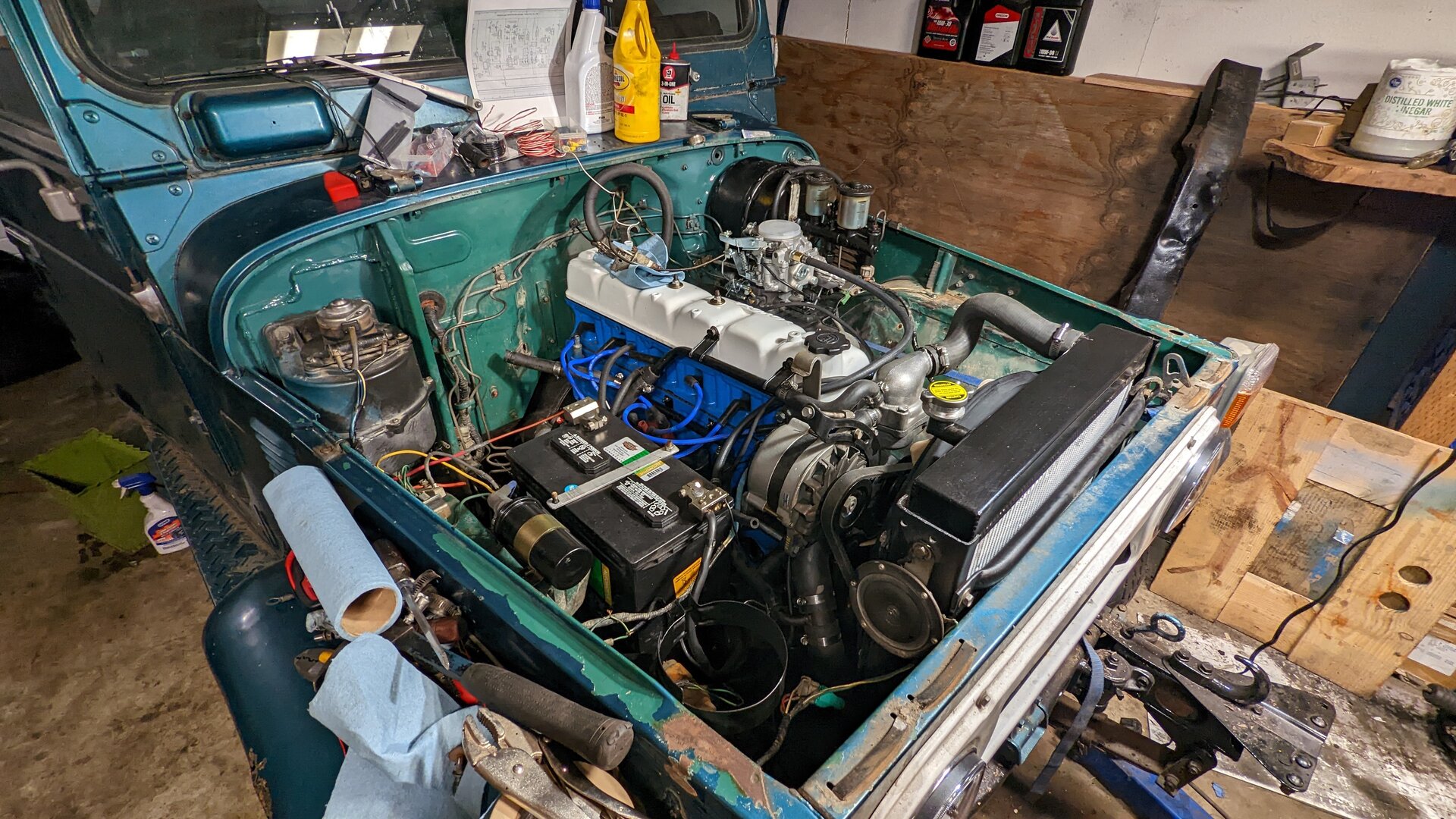

I then bounced back and forth between the engine bay and the interior. You can see in these pics that the engine bay also needed some new paint, so I ordered a single can of matching paint from Cruiser Corp and after removing any rust on the firewall and priming, I painted it to make it look pretty again. I did this behind the brake and clutch master cylinders and also behind the blower motor housing. It turned out nice, and looks brand new. It was at that point when the possibility of bringing the entire truck back to the Toyota OEM Rustic Green first began to nibble at my mind.

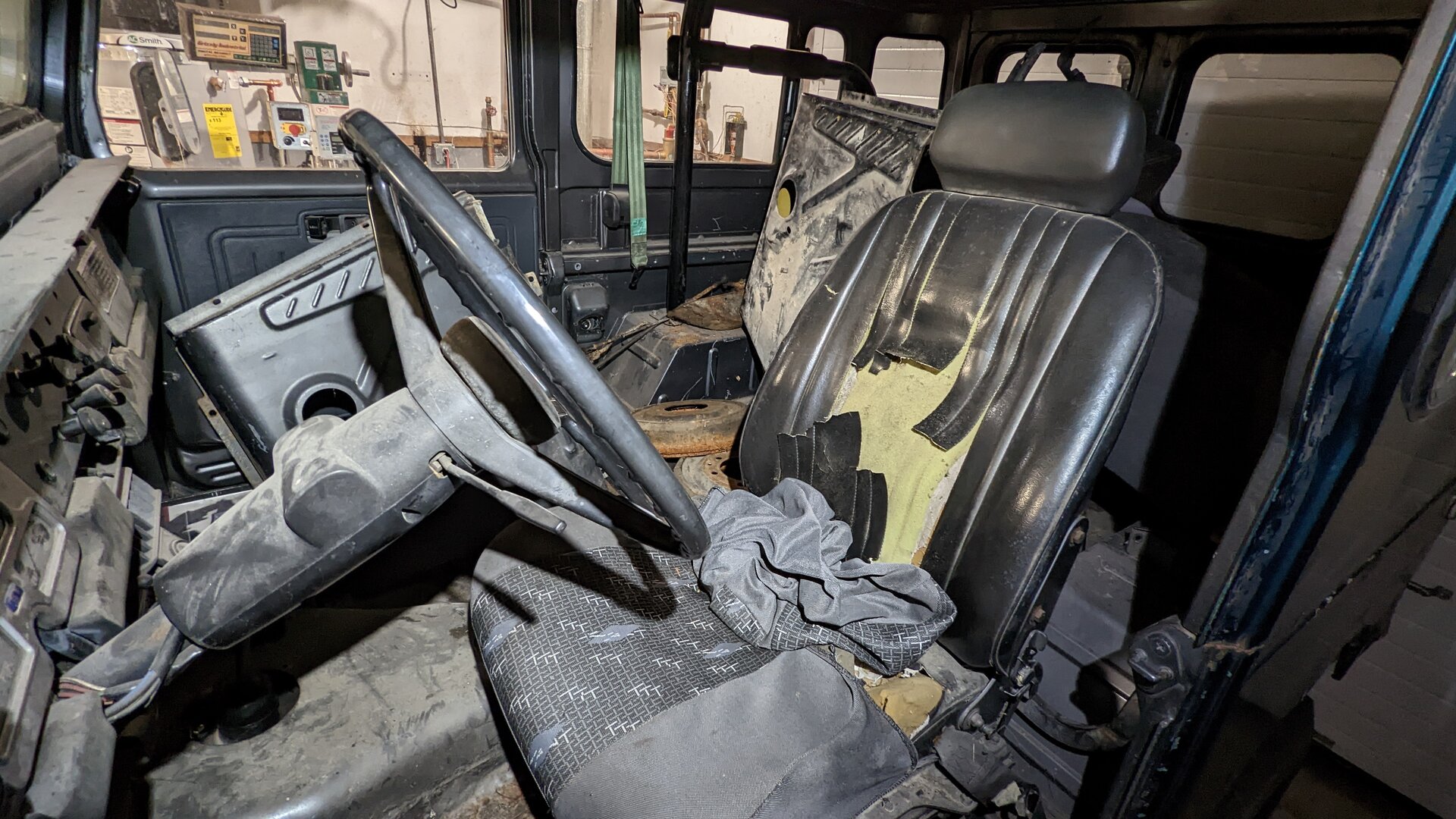

The seats will need to be fully restored. Both front seats are held together by aftermarket seat covers. I ordered some OEM stitch pattern Tan vinyl seat covers from Cruiser Corp that will eventually be used to restore the seats. The seat foam is trashed as well so I'll have to either acquire new foam pads or take the whole lot to an upholsterer to have them install my new covers over their hand crafted foam. I also ordered some heated seat pads and will have those installed as the new seat covers go on. Will post more pics once the seats in better shape.

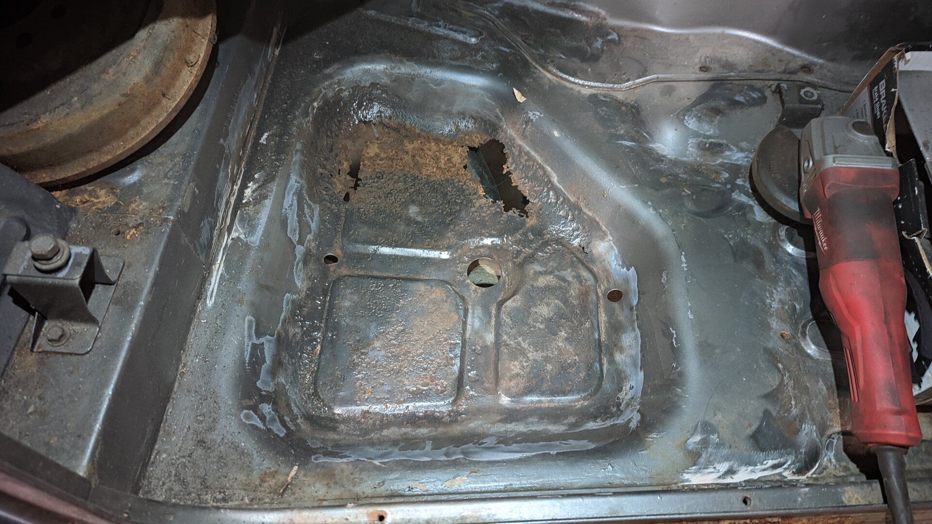

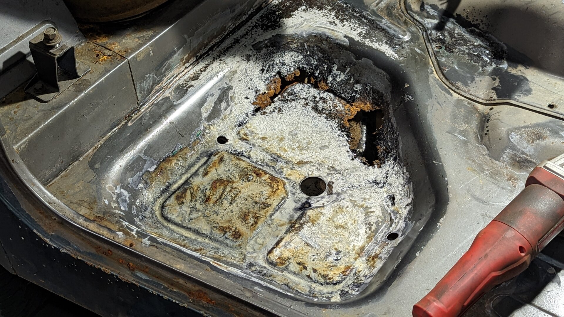

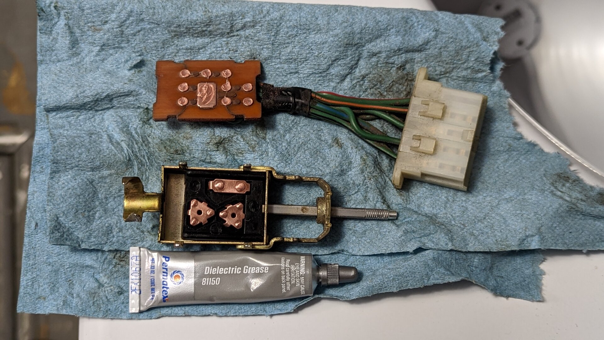

The floor under the gas tank needed some help with rust, and I began to chase electrical gremlins through the truck while rebuilding/replacing/restoring the control switches.

How well did the Cruiser Corps paint match? It’s hard to tell in the photo but it appears to be a different shade unless that’s just lighting differences and phone rendering.
