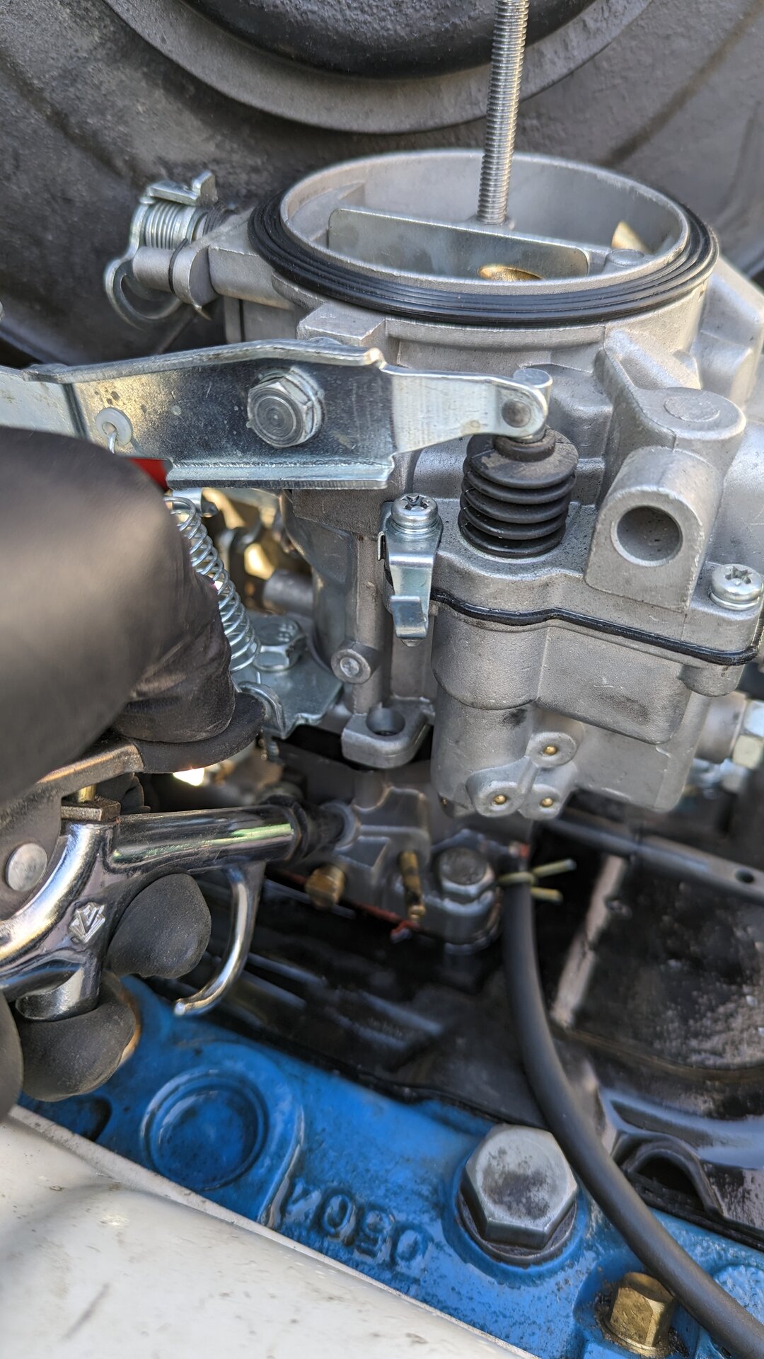

But... Hot starts are another matter. After running for 20-30 minutes and shutting the engine off. It is nearly impossible to restart. Starter cranks fine. Engine spins fine. It sputters but won't fire. I've tried the FSM hot start procedure, but it doesnt help. It's definitely heavily gassed and likely flooded from the smell, but the hot start procedure should fix that, so it's confusing. I'm wondering if it's an ignition issue that only rears its ugly head on a warm engine?
After 45 minutes I can give it two pumps, full choke and 5 seconds later it starts right up.
I set the air fuel mixture screw in conjunction with the idle speed screw per the FSM, and it's timed so that the steel BB is at the bottom of the little view window, so slightly advanced. I'll do more observation and testing tonight, but would appreciate thoughts from the community. Im wondering if my coil (new 12v internally resisted), no ignitor, and new fully electronic magnetic pickup dizzy setup is not supplying a hot enuf spark to ignite a super rich/flooded mixture.
Thoughts?
Thoughts
Ah, good ol' carburetors...
Try flooring the gas pedal next time this happens, and it doesn't start up hot.
DO NOT pump the gas, floor it and hold while cranking, when it starts let up on the pedal.
When hot, fuel can sipen out into the manifold (I believe from the idle circuit) causing a extremely rich condition.
(Don't know if this is the FSM Process you mention or not)

Yes sir. I've tried that and it does not work.
That's what the FSM calls for on a hot engine. 👍🏽
Carby is clogged somewhere
I really appreciate the responses @FJ907Warrior.
Since the vehicle idles fine, drives fine and starts (cold) fine. How could it be the carburetor? I've got it idling in my driveway right now waiting for it to get up to temp so that I can test out the hot restart after cleaning up my engine ground connections. Imo (whatever that's worth) the carb is operating normally.
Something is clogged or stuck. I don't honestly know this specific carburetor well enough. But I would lean towards something stuck open in idle, or secondary jet.
But that is in all honesty just what it's sounding like to me.
I don't think it's ignition.

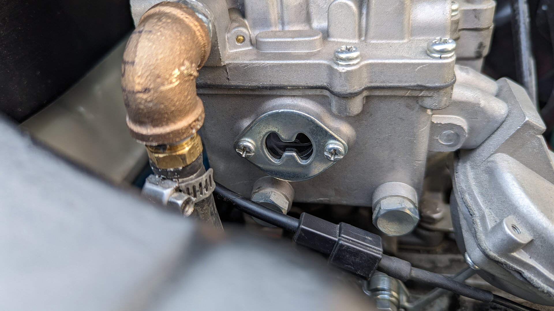

Really would be nice to figure out why it starts hard when cold (5 seconds of cranking at full choke and 2 pumps) and won't start at all when hot. I'm about to experiment with disconnecting the idle solenoid and letting the vehicle siphon all the gas it can before dying to see if that helps me restart it within a few minutes. Should relieve the likelihood of it flooding itself upon shutdown, but I'm open to ideas.

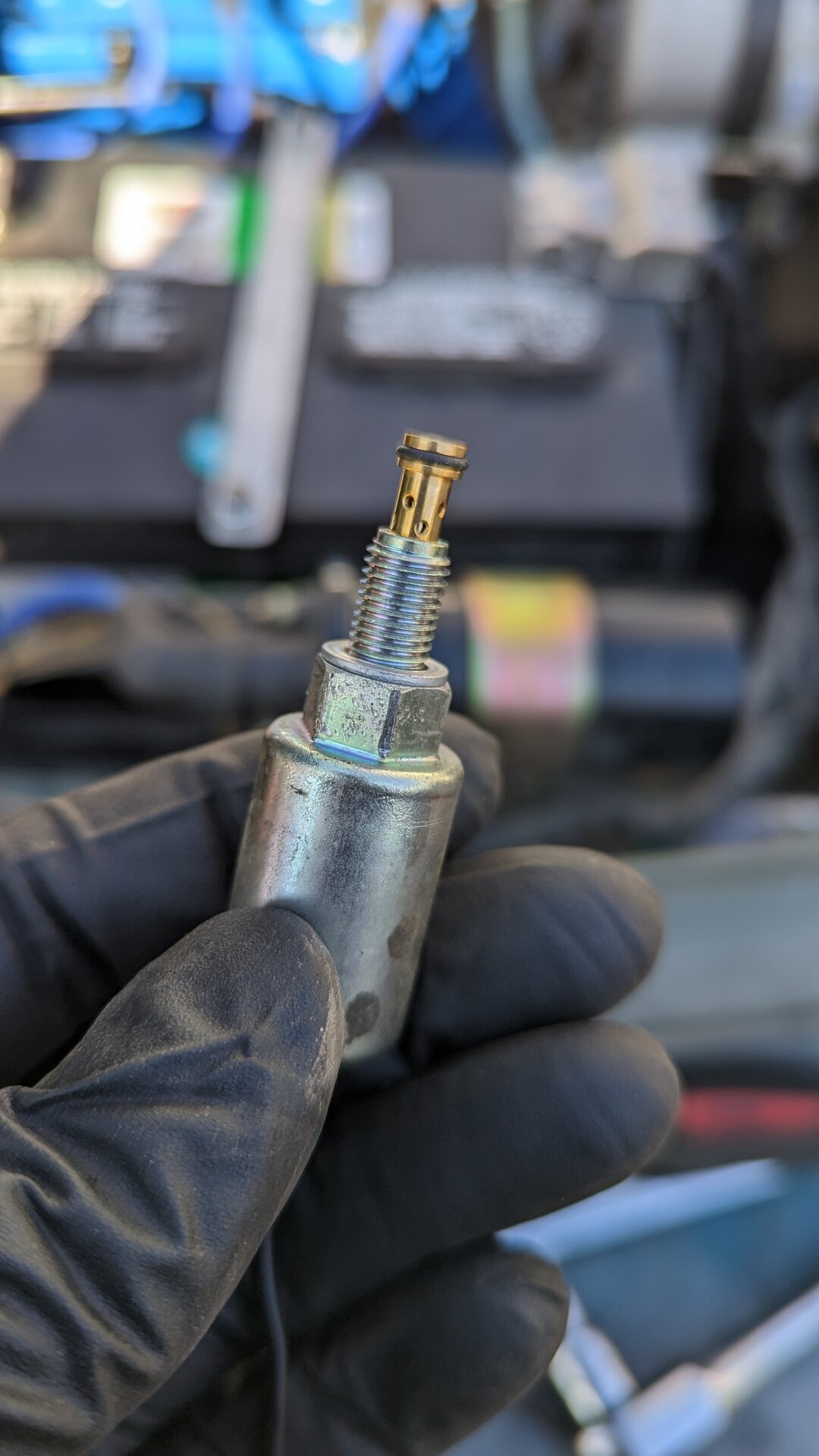

Had the FJ40 shut off on me as I was coasting to a stop and I suspected it was a blocked idle circuit. So I pulled out the idle solenoid and sprayed it with cleaner and compressed air. Did the same down the idle mixture screw hole. Seemed to fix the non-idle issue. That's the 2nd or 3rd time it's happened, but I've never changed the original steel fuel filter so that was the next fix. Went down to the local auto store and picked up a clear plastic filter. This is a temporary filter, so that I can see how dirty it gets and how quickly.
Changed the differential fluids. The rear differential was okish, while the front dif came out like old molasses. I also got around to checking my vacuum at 750 rpm and 400 ft elevation. Just under 21 PSI of vacuum from the brake booster line. Next I checked my oil pressure manually since the sending unit either isn't working or the wiring is shorted somewhere. About 40 PSI of oil pressure. I hadn't worried about the oil pressure since it was coming out up top by the valves so I knew (assumed) it was good but it's good to verify my assumption before too much driving around.
Was it super dirty? Obvious clog?
Getting consistent voltage at the idle solenoid?
1wire grounds through the carb, past the insolator via the mount bolts, doesn't hurt to throw a ground strap on the base.
I have the two wire on mine, not by choice, but it does allow me to ground it directly to the block.
I'd pop that carb open and inspect every orifice. Most of the low budget repro's have issues with casting flaws, chunks of metal, dropped emulsifier tubes, misaligned secondary passages. Then make sure your solenoid is reliably clicking everytime you connect to power.
While it is open make sure the float is set at 6mm and 1.1mm respectively and that the float actually floats (check in a glass of water).
Then pull the emulsifiers/venturis out and make sure the tube isn't dropped in the body. I've seen that more than once on repros.
Wasn't super dirty. In fact the idle solenoid looked sparkly clean. I couldnt see any clog in the idle mixture screw hole, but I assumed the clog was somewhere in there and blew it out well, sprayed carb cleaner down into it and then blew it out well again. Same ritual for both ends of the idle circuit and idle solenoid end.
My cleaning/blowing seemed to clear my idle circuit blockage, but my fuel level is a bit low and so I do need to open the carb back up at some point. Not looking forward to that. I'll do what you recommend while I've got it opened up.
