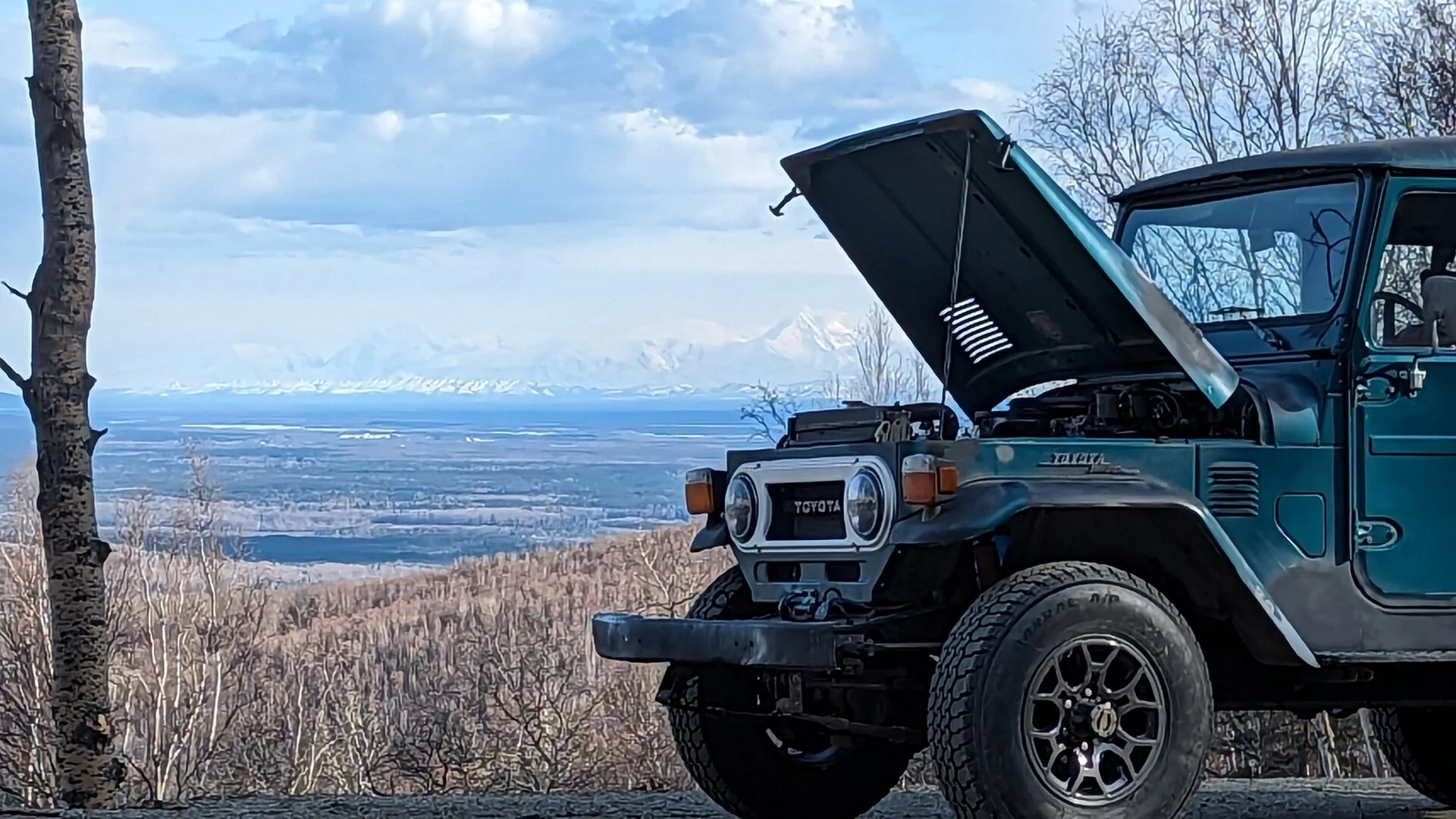

Any indication that this rig ever lived in idaho? I knew of one in the 90s that was this color in Eagle Idaho.
The only history I have for this rig was that it was "discovered" on an old (maybe abandoned) Alaskan mine site and brought to Fairbanks several years ago.
I traded for the FJ40 from @12112321AKYLE and so he may have more info about the history.
Its a common color to respray on these rigs, but I know I bought this one with another one that was in Idaho at one point, so it is possible that it was also there. These are pictures of the rig I bought with the blue one that @Aussie Alaskan has now. These pictures from 1997, I'm not certian if the previous owner had the blue one back then but he had my yellow one for 26 years and may have brought both up to Alaska. You can always check the VIN against registration history.

1997 pics rule out the idaho one I’m thinking of. Thanks tho!
The one from my last belonged to a really cool mentor for me in the fire service and also probably the reason i found interest in cruisers. His was beautiful and was an inspiration for me as I worked on mine back in 95-99

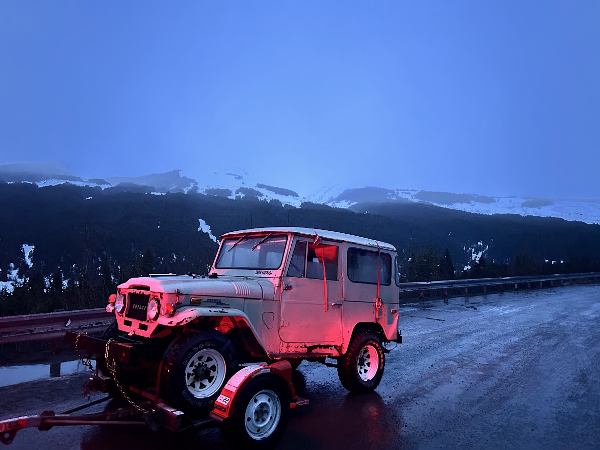

Where are you at sir? What year is your rig? Run/drive? What are you plans with it? Should be a fun project/ride/money pit/toy!!😊
Im in Anchorage, its a 1971. First get it running (fuel issue, then clutch), then paint over/stop the surface rust (any suggestions on paint/bedliner for the interior floor?) then probably run out of money haha. For now I just want it good enough I can throw some stuff in the back and take it around town/camping. The rest of the restoration stuff will have to wait until after I have a better place to work on it
