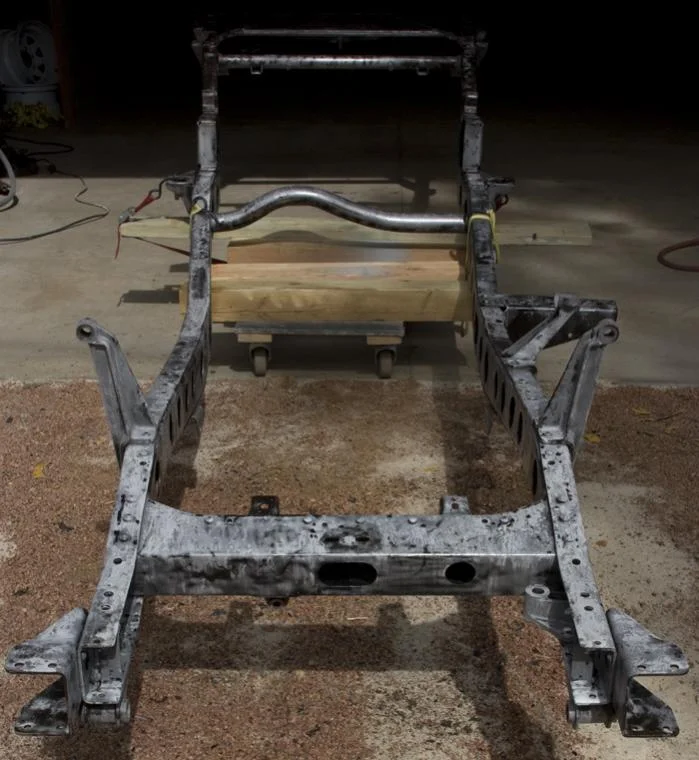

Slowly, but progress is being made. Found and rebuilt 2F and 4speed, frame is acid etched and zinc coated and ready for paint.

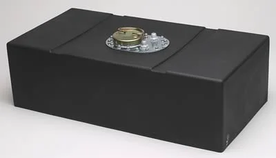

Searched and found some good info but no pics of a poly/plastic fuel cell located under the front portion of the bed.
Was thinking this 22 gal tank from Summit would work, and then as Mark suggested just run the fill neck up into the bottom of the bed.
Thoughts?? :confused: Comments?? :confused:
I've got an H42 w/t-case, never been split! Sitting in my garage. I think they're out of a '74. I also have a 45LV gas tank that will fit under the bed in the factory spare tyre location. Everything is in Leadville, let me know if you're interested.
Might be kind of pain to fill the truck with fuel if you have your bed full of stuff---I would find a way to run it through the side of the bed. I am sure there are many options out there with a side fill.
GlacialPace Build

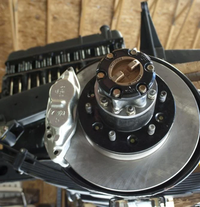

Couple pics of progress

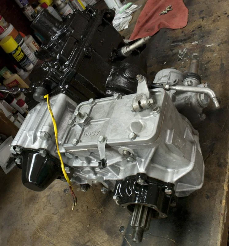

Rebuilt 2F

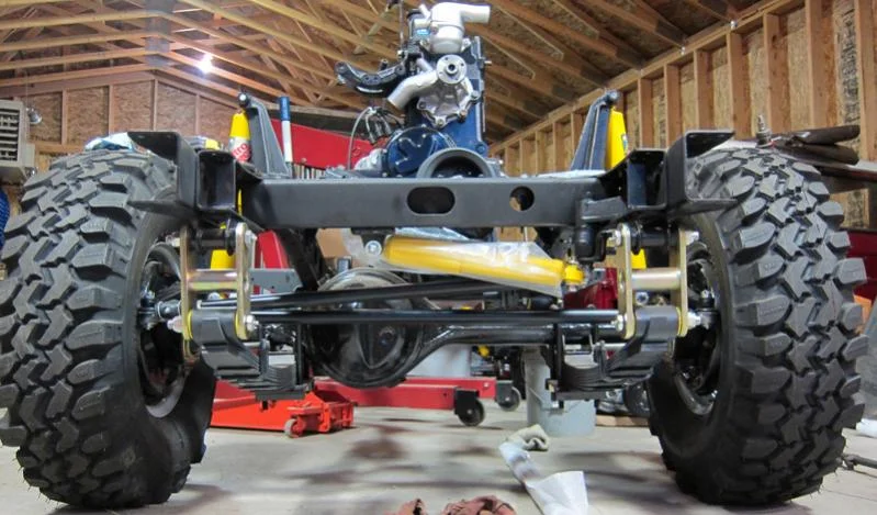

Blasted and POR Frame

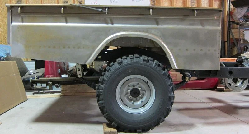

Bed from Kevin

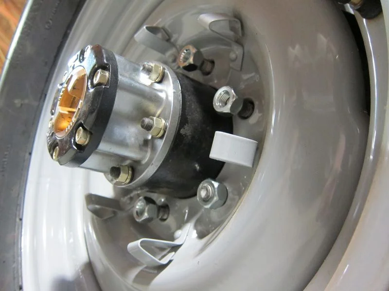

Powder Coated Steelies
LTB's
OME
4 Speed
Couple More
Beauty.....

Body went off for media blasting and epoxy primer
Pics to follow...
