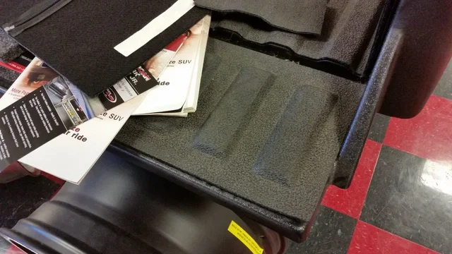

1) Here is a photo of the bedtred pro series product I think would be a perfect addition to the cargo area. My luck turned a bit and they are selling me a 6 foot wide cut of it. I also found the plastic snaps to secure the tailgate material, but I need to narrow down the precise size. it's a kooky but very effective little plastic snap and they are sold at most auto parts store. Just need to figure out which size is best. Though I'm honestly ok with letting an auto upholsterer(friend) handle this as I trust their carpet cutting over mine.

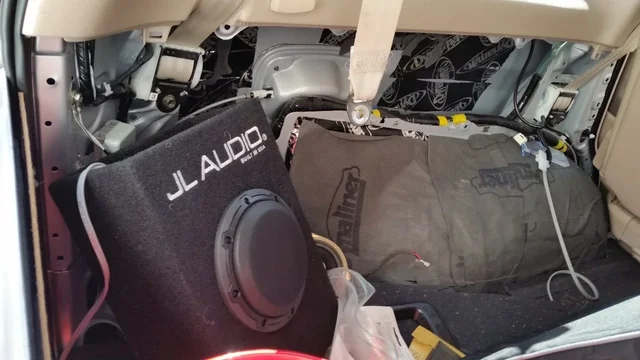

2) Here is a very rough photo of the JL sub sitting in the back of my LC. Gives you and idea of space/fit. Weather finally turned, hope to finish out the wiring for the remaining subwoofer over the weekend. The hold up is that I want to wait on the upholstery and I want to dress up the sub once it's in to hide the annoying JL logo. But bottom line, that sub fits in the very back corner very well. It sounds great and I think those are the smallest aftermarket subs that will fit for the most relevant value. It will mean you only have to make some modifications to the wiring. Very easy.

These sub enclosures are as big as I think will reasonably fit behind the third row. Even with one in, it sounds great.

I had been hitting up a few truck bed places in that never ending search for the perfect texture and found one I really liked. http://www.bedrug.com/products/bed-liners/bed-tred-pro.html
Problem is Bedrug,(which is based near Knoxville), only wanted to sell kits that 'fit' particular vehicles, so what you'll have to do is contact them directly, ask for a 6x10 cut of their product(cost was ab $100) and have them ship it to you. The material is excellent. It's slick plastic on top, soft fabric attached beneath.

Here is a quick photo of the tailgate...I was insistent about a couple of things: 1) I wanted trim around the tailgate edge 2) I wanted a tight fit around the plastic snaps. We went back and forth on the snap pieces that secure it, I think you could go either way, but I'm thrilled that we found a way to use screws, which are a better result.
After getting this 'right' and getting the bedrug in place, I'm now undecided whether I continue with a utility or luxury carpet throughout the rest of the vehicle. Iv'e found a nice boat vinyl, but the carpet in the LC gets so much foot traffic, I may continue this..
A word of caution, the really thick products are difficult to cut, are too thick and arent' flexible enough to fit around the plastic edges. The Bedrug is really just a carpet with a plastic topliner..but it flexes just enough.
