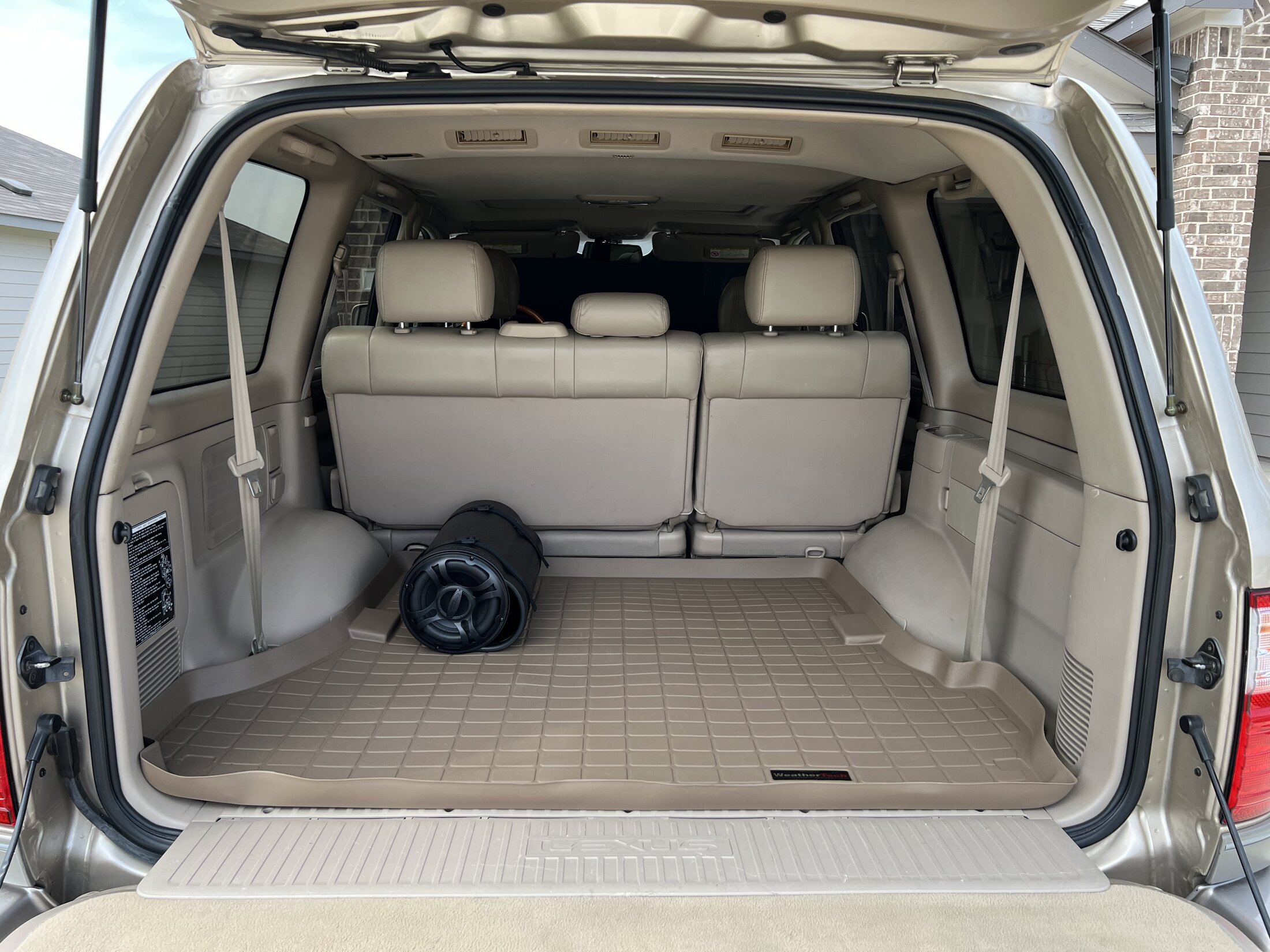

Another option if you don't mind having a speaker permanently in your cargo area, would be adding a 8" Bazooka Tube (4 ohm, dual voice coil). You have to rewire the interior of the bass tube to make it be in series (8 Ohm) like the SKAR 6.5" sub and extend the factory sub wiring, but it adds quite a bit more bass when compared to the 6.5" SKAR sub. I had upgraded from the factory sub to the SKAR 6.5" sub replacement and didn't think it really put out any bass. The 8" Bazooka Tube is alot better.
Thanks for responding but I have said a few times that this is not the solution I want. Guess you didn't read through the thread? I hate low bass fq not to mention having no room anyway and a solution has already been found.
