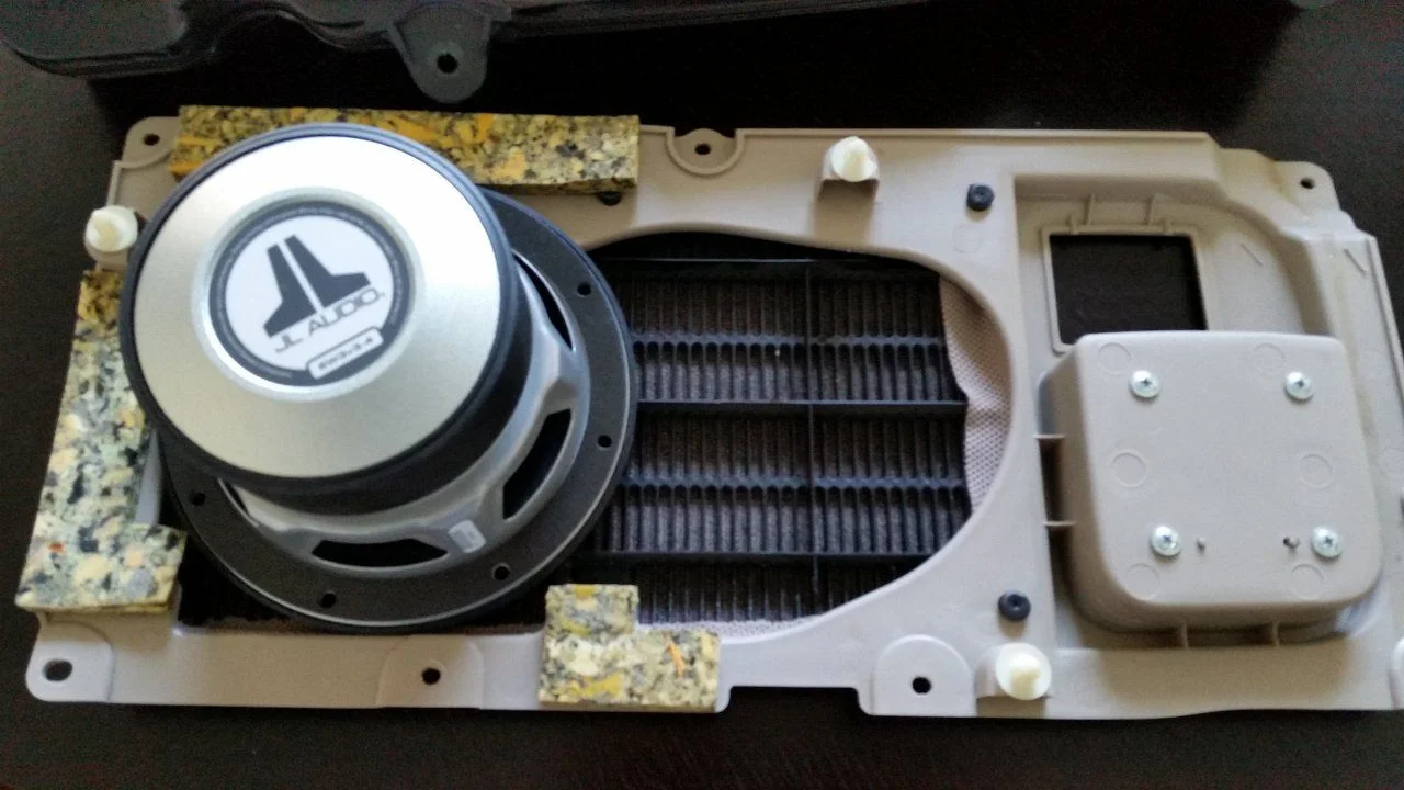

Photo#1- New sub(s) sitting on the grate from the plastic. It will fit! (Twice, hold your comments) But there will be cutting on that plastic it will be a challenge..

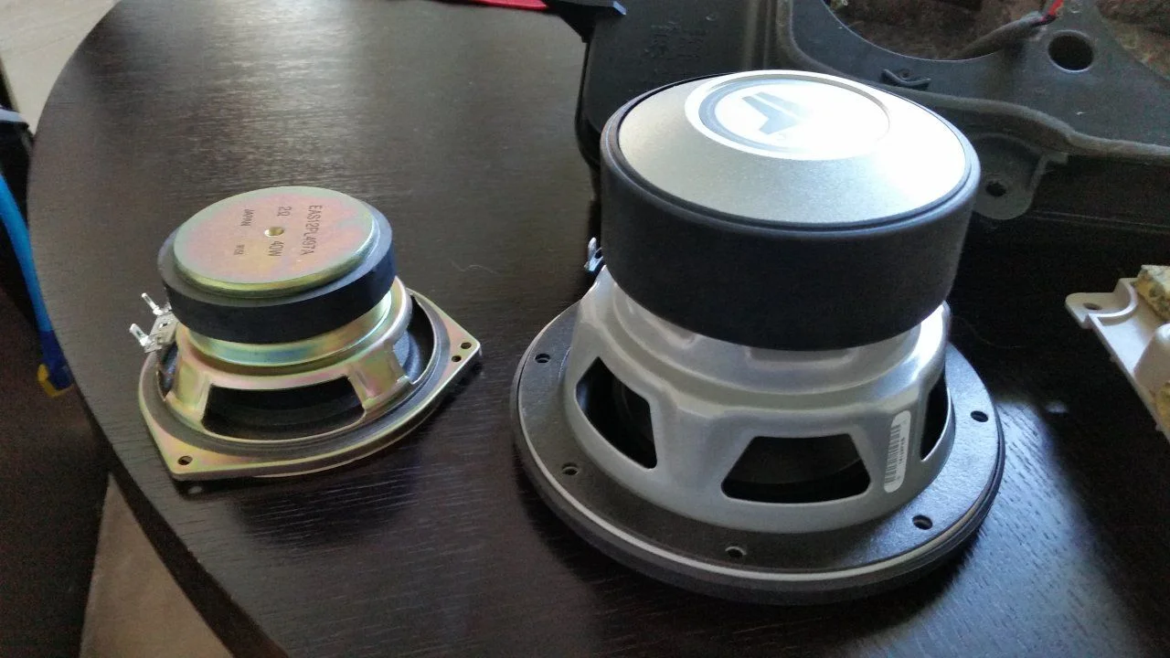

Photo #2- Old vs. new sub. JL Audio 6w3v3-4. It's quite a bit heavier I might add.

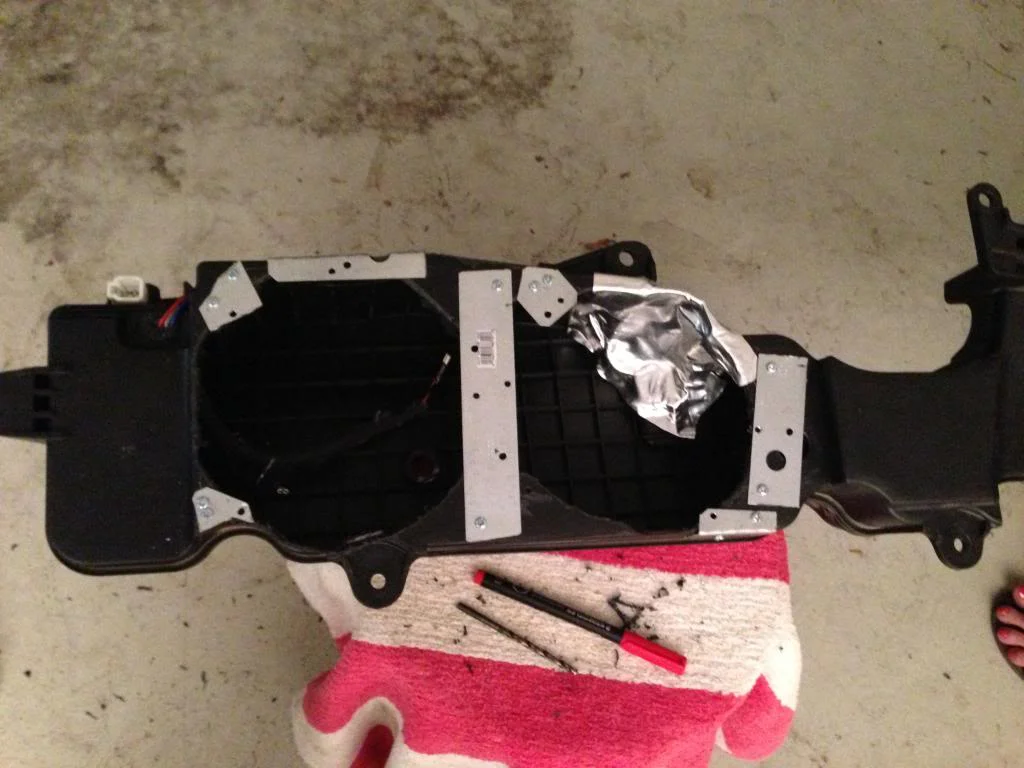

Here's the key: The more difficult task here is modifying that plastic grate. It has to come out a bit to accommodate just about ANY new sub. Sure, there are subs you can pop out and just replace, but I don't think it's worth the effort.
One could ditch the stock enclosure and build their own and I'd by lying if I didn't say I'd given it serious thought. The pros of the stock enclosure are that it's durable plastic and the mounts are already drilled. If you still wanted your own enclosure, I'd suggest stripping that enclosure of everything but keeping a flat frame of the mounts and building that into the enclosure.
The cons are that it's designed to fit a really, really crappy subwoofer. This enclosure & sub are bad design. Too small to be of use and then too intricate to fit the part to be modified.

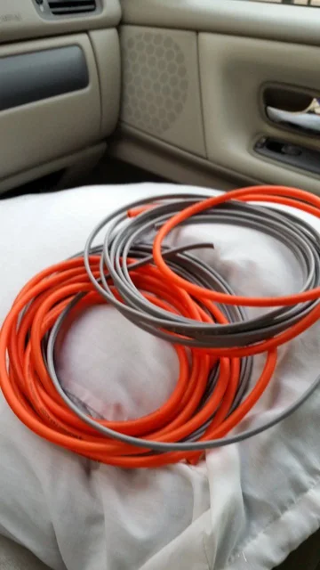

Just a heads up, you'll have to upgrade two wiring legs while doing this...
Connections:
The connection from the head unit to the amp with 8 gauge wiring
The connection from the amp to the sub woofer with 16 gauge wiring
By this in 25-50 foot increments, it's cheap..
