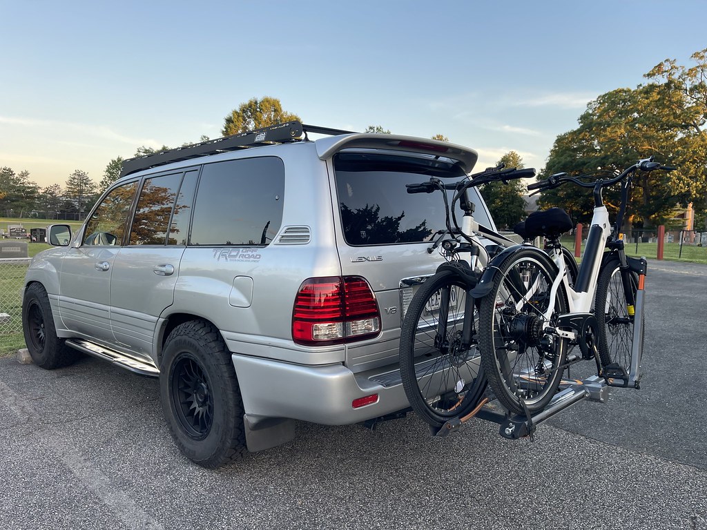

I like the stock 06-07 wheels too but didn't wanna run spacers so i opted for aftermarket wheels with 25 offset, works great with 275/70/18 only rub slightly on mud flaps. AHC in low mode to get the heavy azz ebikes off.

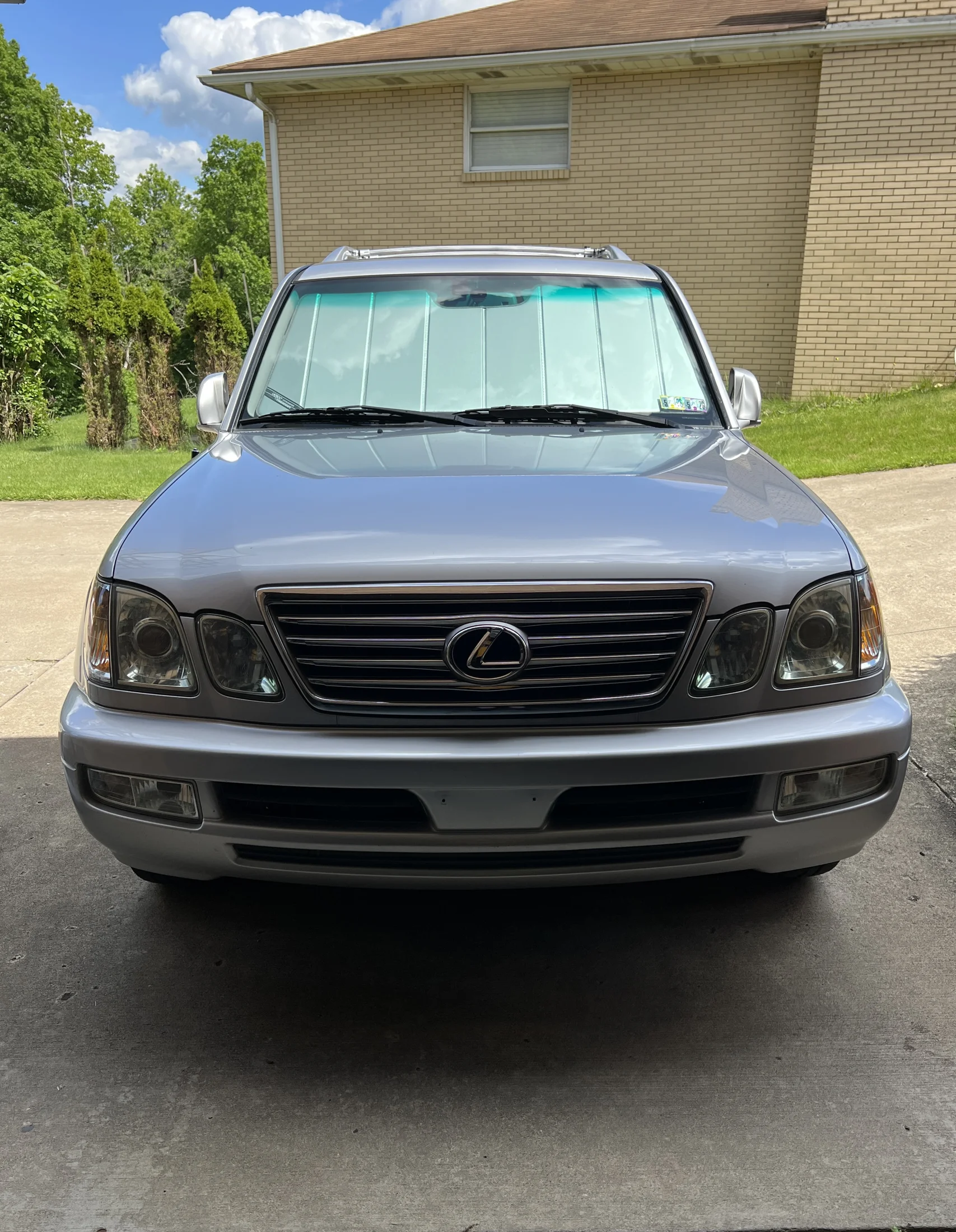

It’s been a quiet 3 months of ownership. Can't complain as it's been a pleasure so far. Enjoying it more the more I drive it. I've done nothing but wash it once and change engine, diffs, and t-case oil
In two weeks I'll be taking it to a Toyota specialist to do the timing belt, service the AHC, and diagnose the ABS/vsc trac/vsc off lights issue. I'll feel a lot better about putting miles on it once those are taken care of
Have to say, this is the first vehicle I've owned where engine breaking is a MUST for regular driving in the hills around here
Makes a big difference. It's hard to believe how smooth the gear selections coming from the A/T in my Accord 😆

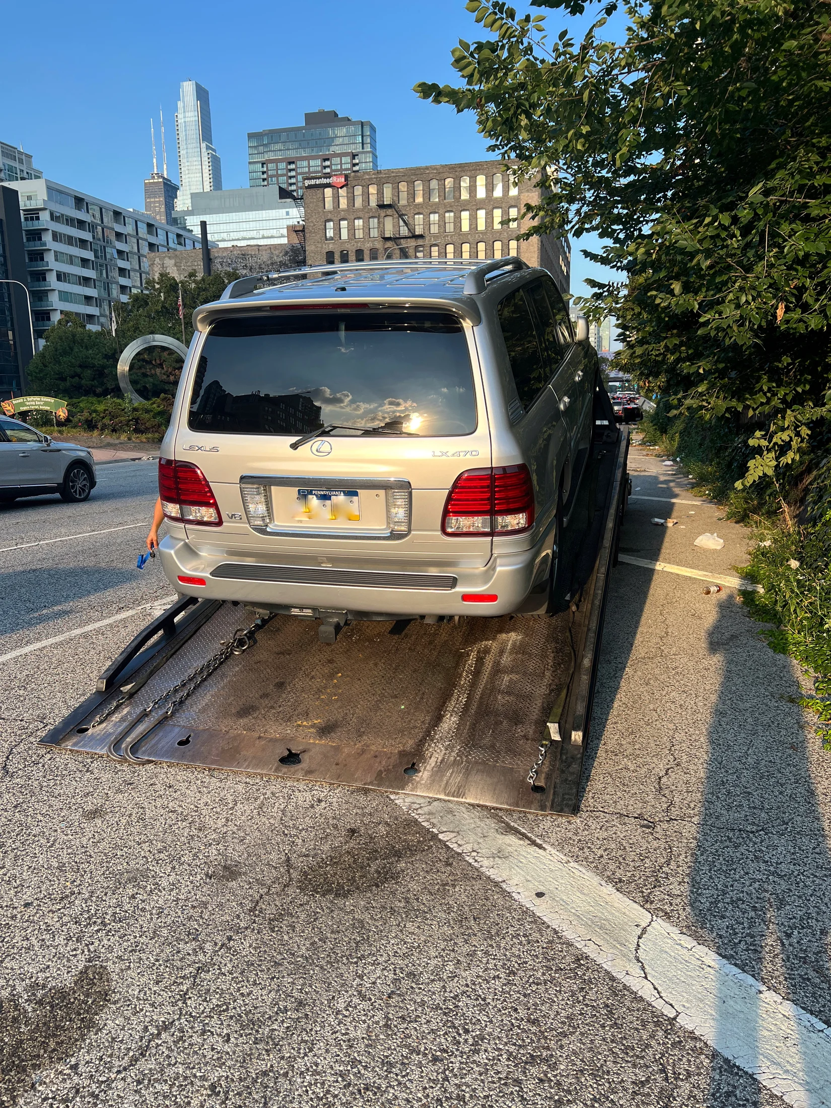

Went from quiet to less than quiet fairly quick. Posted about it on here but I had what was likely a fuel pump issue at the end of a 450 mile trip to Chicago.
We'll call it both good and bad timing if the issue was going to present itself. I had it towed to a shop that I was scheduled to take it to the following Monday (this was Friday evening)
Misfiring/No Start After Long Drive

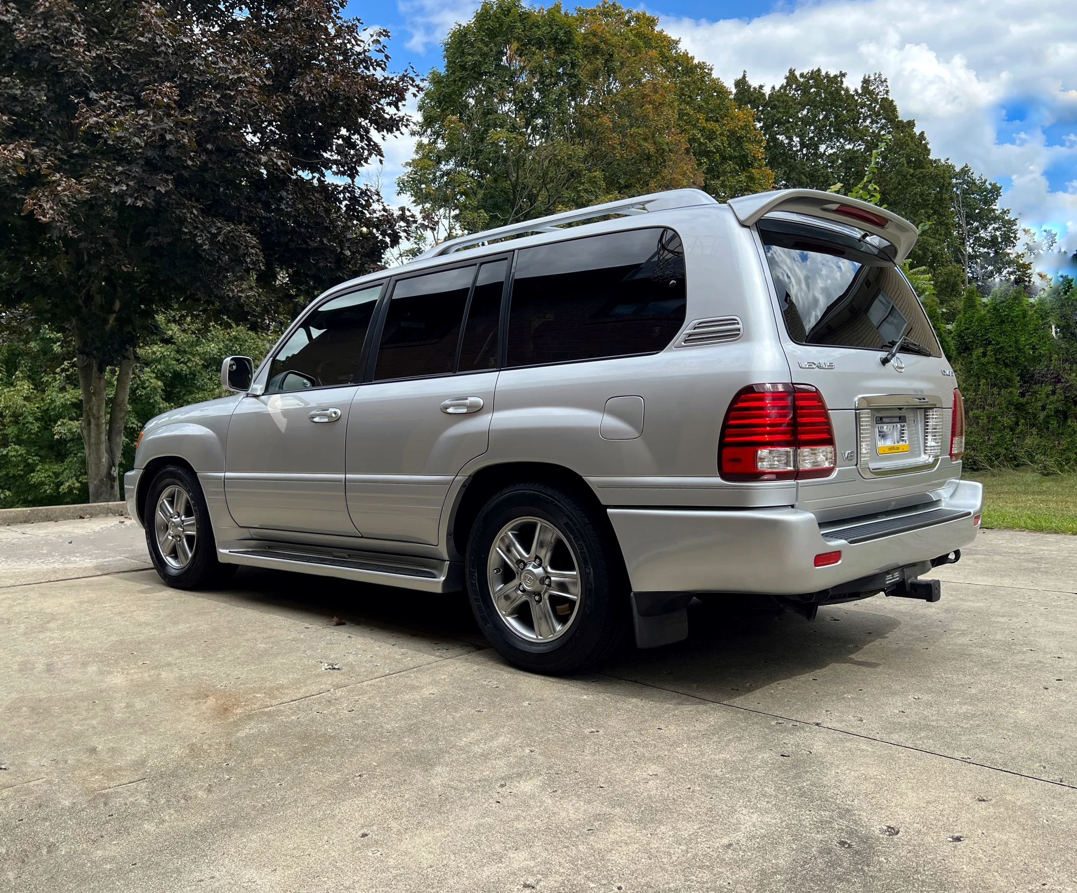

I picked it up this past week after:
-New timing belt, water pump, idlers, tensioner, thermostat, drive belt
-New radiator, hoses, heater t’s
-New fuel pump
-AHC fluid and A/T fluid flush
-Greased driveshafts and alignment
It has been GREAT driving it without that original timing belt on the back of my mind
I still need to diagnose the intermittent ABS/vsc trac/vsc off lights. The shop said the lights weren't on for them and no codes. I will try to connect with techstream when the lights are on and see if the abs/vsc module is communicating with techstream or not
That is hopefully it for a while until brake time. Front left CV boot and rear right axle seal are leaking a little
