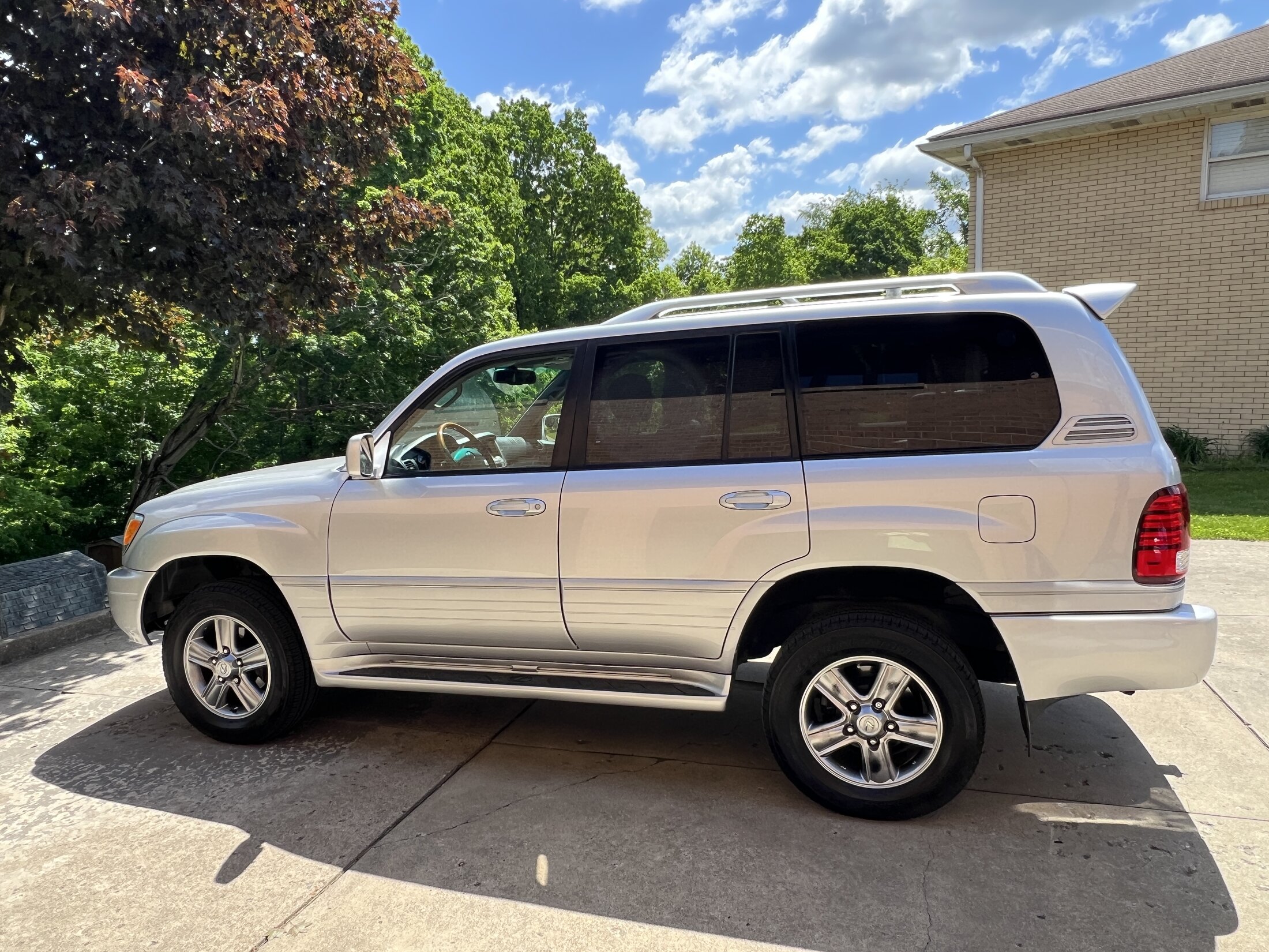

Purchased a 2006 with 92,000 miles, bone stock, clean frame, and generally flawless inside and out. Flew out to pick it up and promptly drove 900 miles home against better judgement
Not a fun drive but it handled it like a champ. Very pleased with the comfort and smoothness of the AHC. The power of the VVT felt adequate and managed a modest 19 mpg cruising at 70
It's not clear when the timing belt was last serviced (if ever), so that will be the first thing on the list, along with AHC service, and the rest of the 90k mile items. Also need to add a Gromm unit ASAP
Overall very pleased with it and happy to be finished with the search

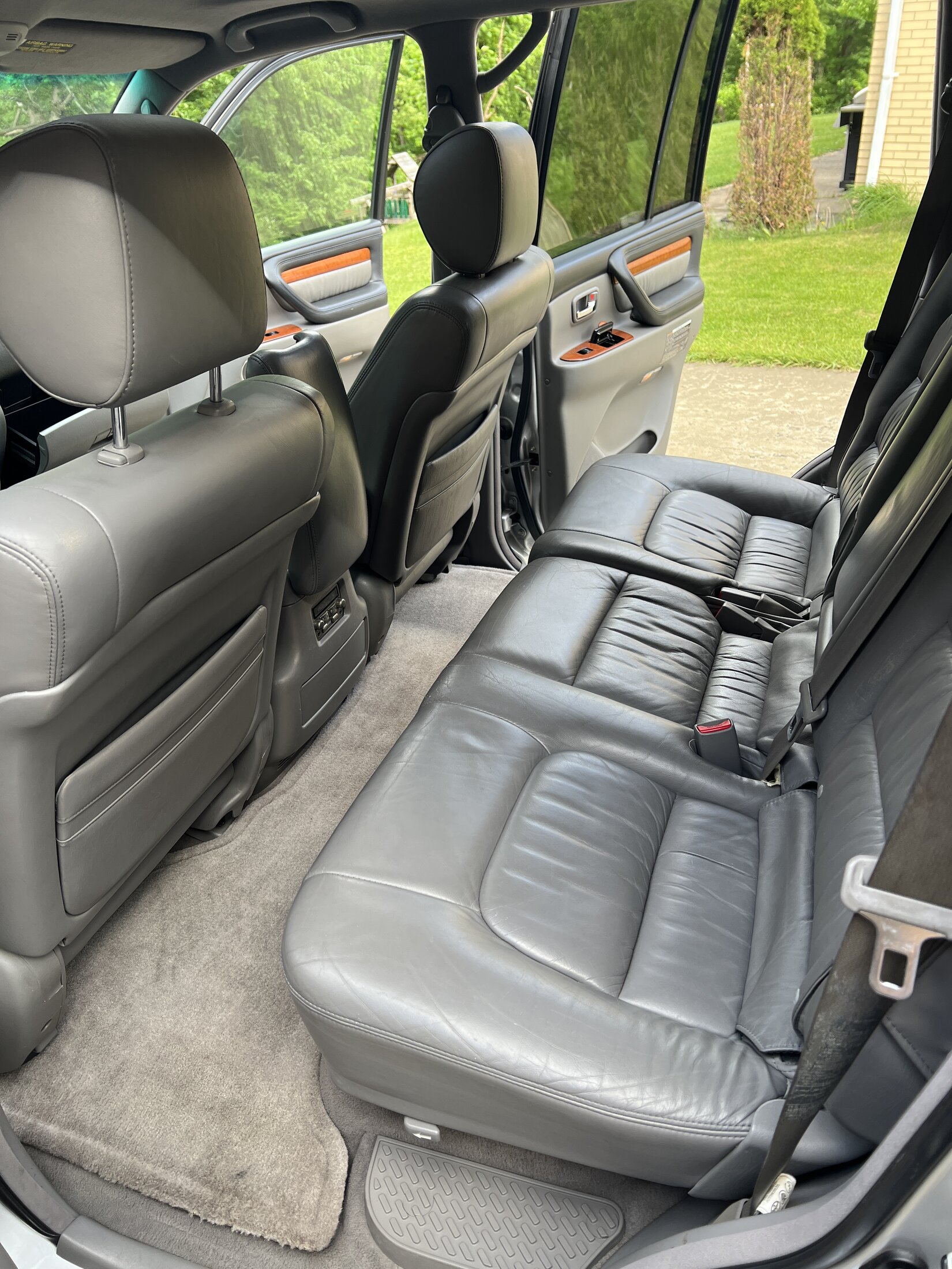

Will have to agree to disagree. While I never anticipated finding or buying a 100 series this clean, I have no regrets. Legitimately looks and feels like a brand new vehicle
Not exaggerating when I say there are 1-2 year old trucks driving around with more cosmetic flaws. No idea how previous owners kept it so pristine
