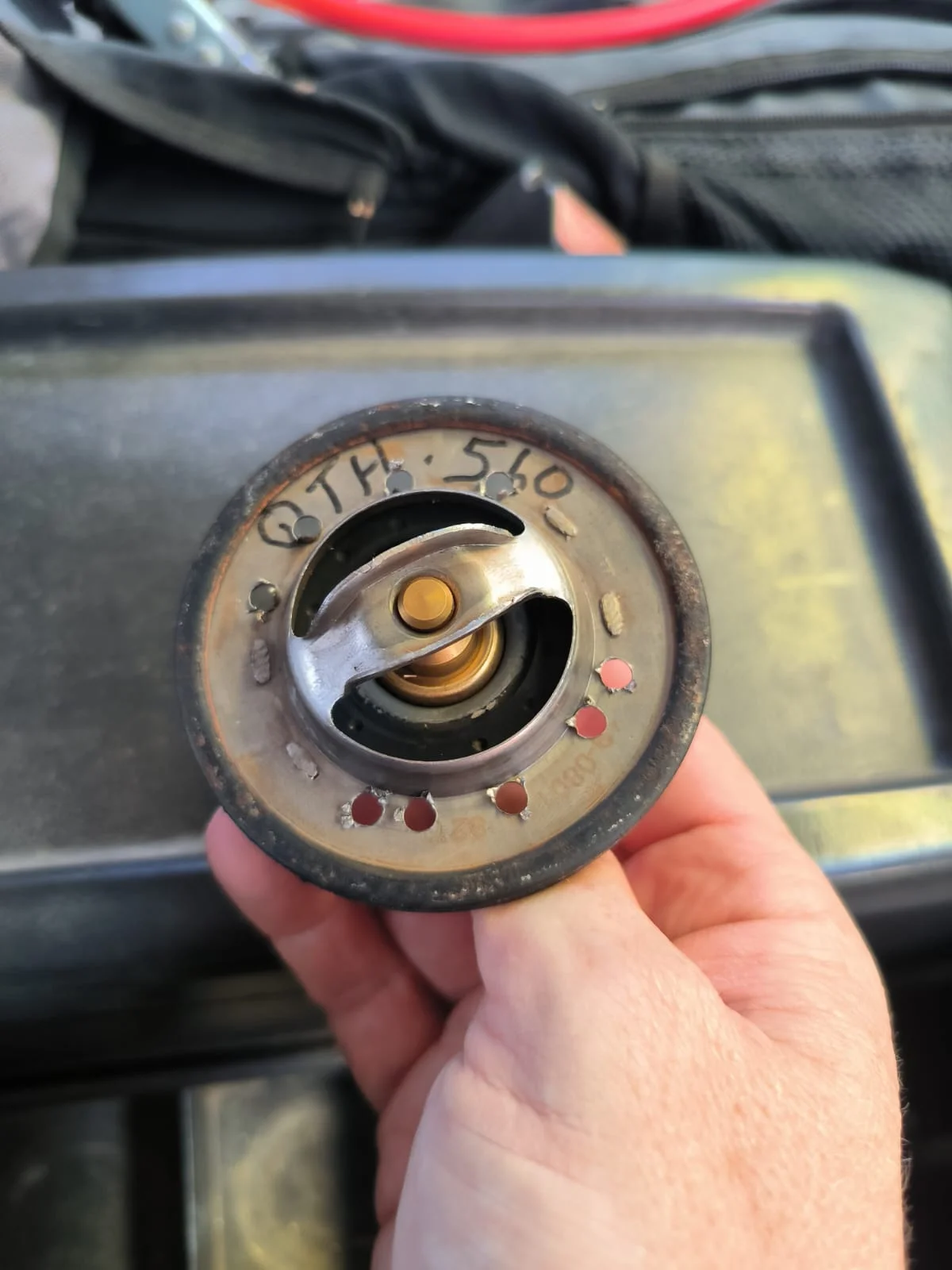

3) Replaced the Thermostat... I did find a number of holes drilled in the old thermostat (pointing me to think this is not the first time this engine has had overheating issues). Replacement is OEM from Toyota, and the parts guy said it was tested at the factory before they dispatched it to me. (We have not tried running the car with no thermostat at all... but the holes drilled in the old one - see pic below - make me think its not going to solve this issue)

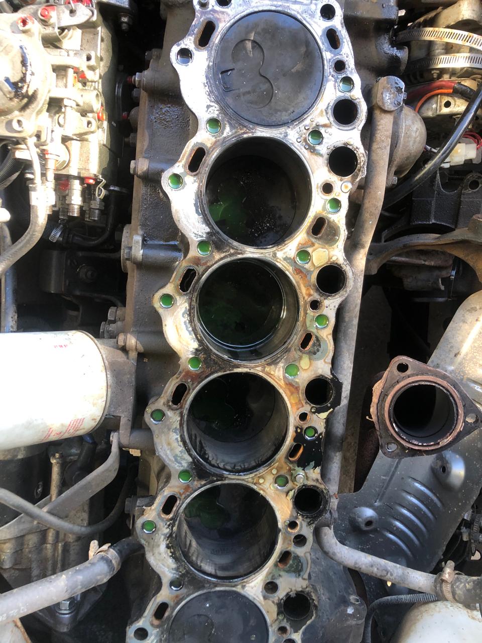

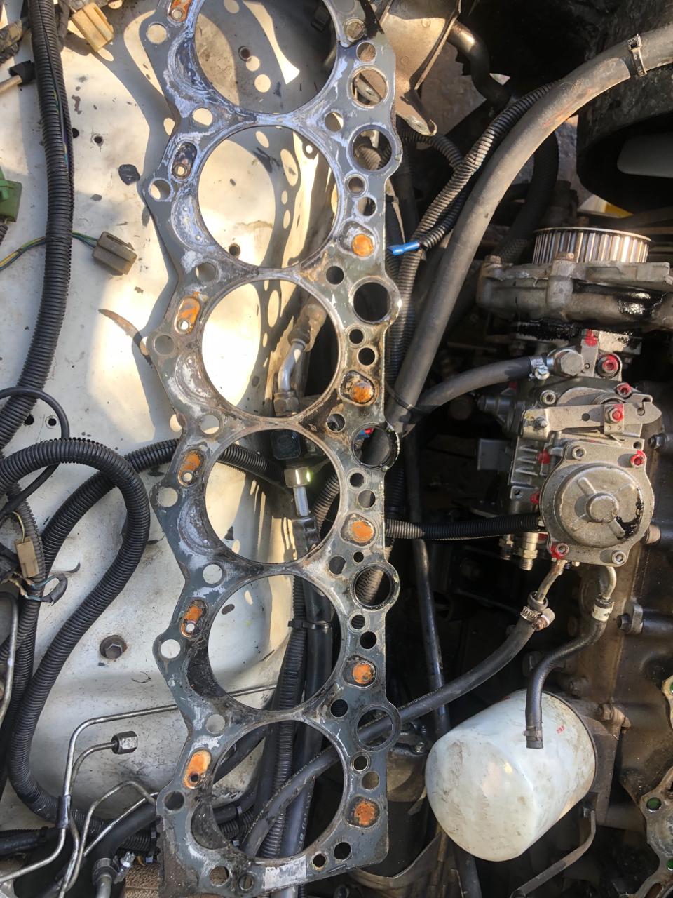

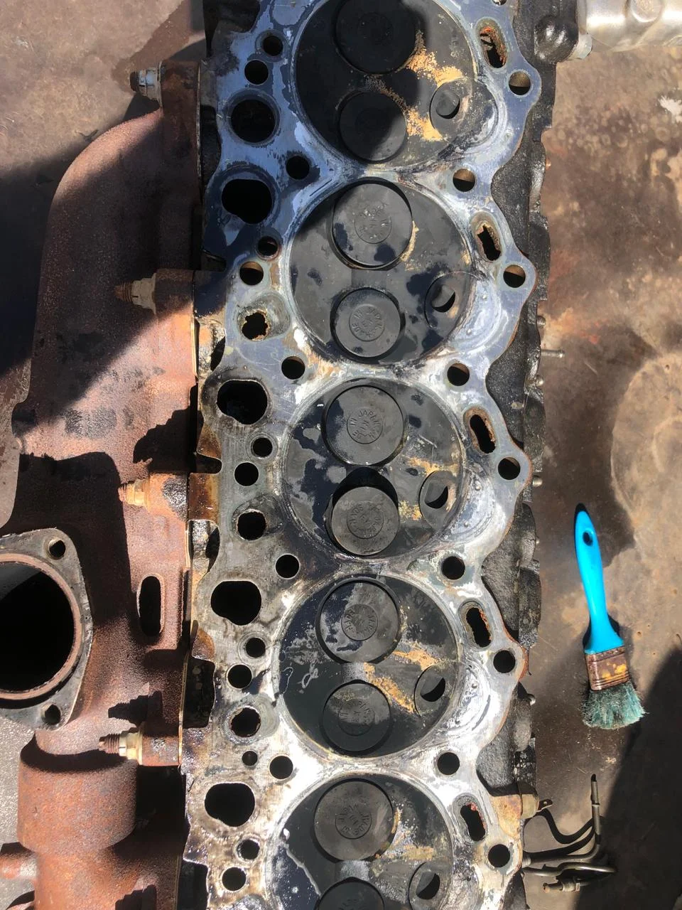

6) finally removed the head... there was a leak in the head gasket (see images below)... so we skimmed the head to get it smooth at an engineering shop and put the head back on with a thick gasket.
7) Sent the cruiser in to an Injector Pump specialist to check the timing was all good, and we were not overfueling. He did retard the timing some what, but the same issue remains.
I hoped no. 6 was the final step, but alas she is still overheating on sustained up hill drives at high revs... The car starts first time on a dime, and runs smoothly.

I attach some pics below for reference of the Thermostat removed, and the head off the engine

100c is fine going up a hill. however i would never take a 1hz head off and skip pressure test and MAG check it for cracks.
I would lock up the fan and retest.

Mine turned out to be a cracked head.
I found that by the time the gauge but the red, it was too late, the engine has overheated already
While you have the head off, strip it, hot tank it, and crack test it.
It's also possible for cylinder walls to have tiny cracks

i had a head gasket that didnt seal up and it would overheat very easily

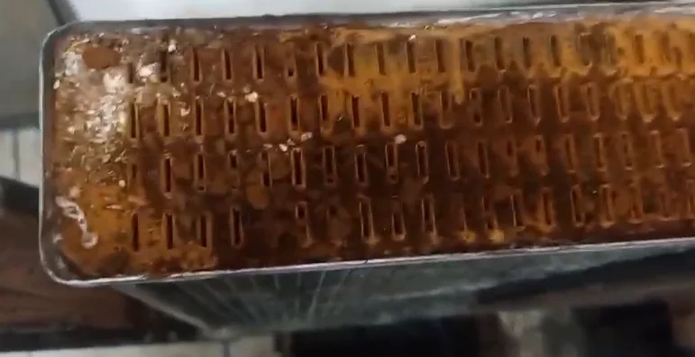

Thanks for all the Input... we stripped the radiator for a proper check and there was a bunch of rust visible once the side frames were off...
Going to fix that and see if this solves the problem, as there is not space for a bigger radiator than this it seems.

- did do the pressure tests, and the engineering shop that did the skimming said it was not cracked, but just warped. I will have to find out exactly what tests were done and if a MAG test was done. I hope I didnt miss that step.

If the radiator cannot keep up - nothing else will fix the problem he's having
If it doesn't have adequate air flowing through it, no radiator will solve the problem he's having.

thanks for all the input... I got the radiator back after cleaning the rust out. So fingers crossed this is the cause of the issue. Will revert when i know more
I thought you said you'd had the radiator recored?
I did have it recored about 15,000km ago... and recently we tested the flow rate and it was seemingly fine as part of this diagnostic process, so it seemed a fools errand to strip her again and inspect the core. Yet there we were with the bottom clogged up with rust. Not sure how that works. Maybe it was done badly. I am truly hoping this is the issue... its been a bit of a frustrating process.
