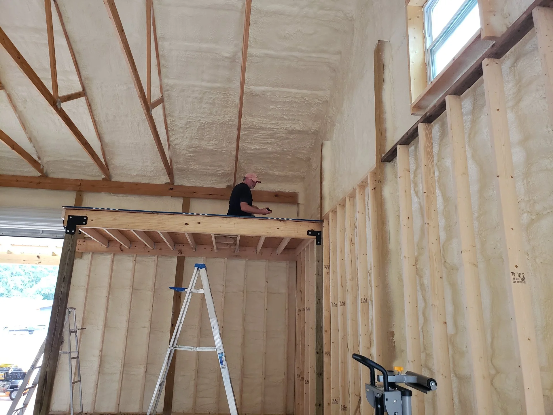

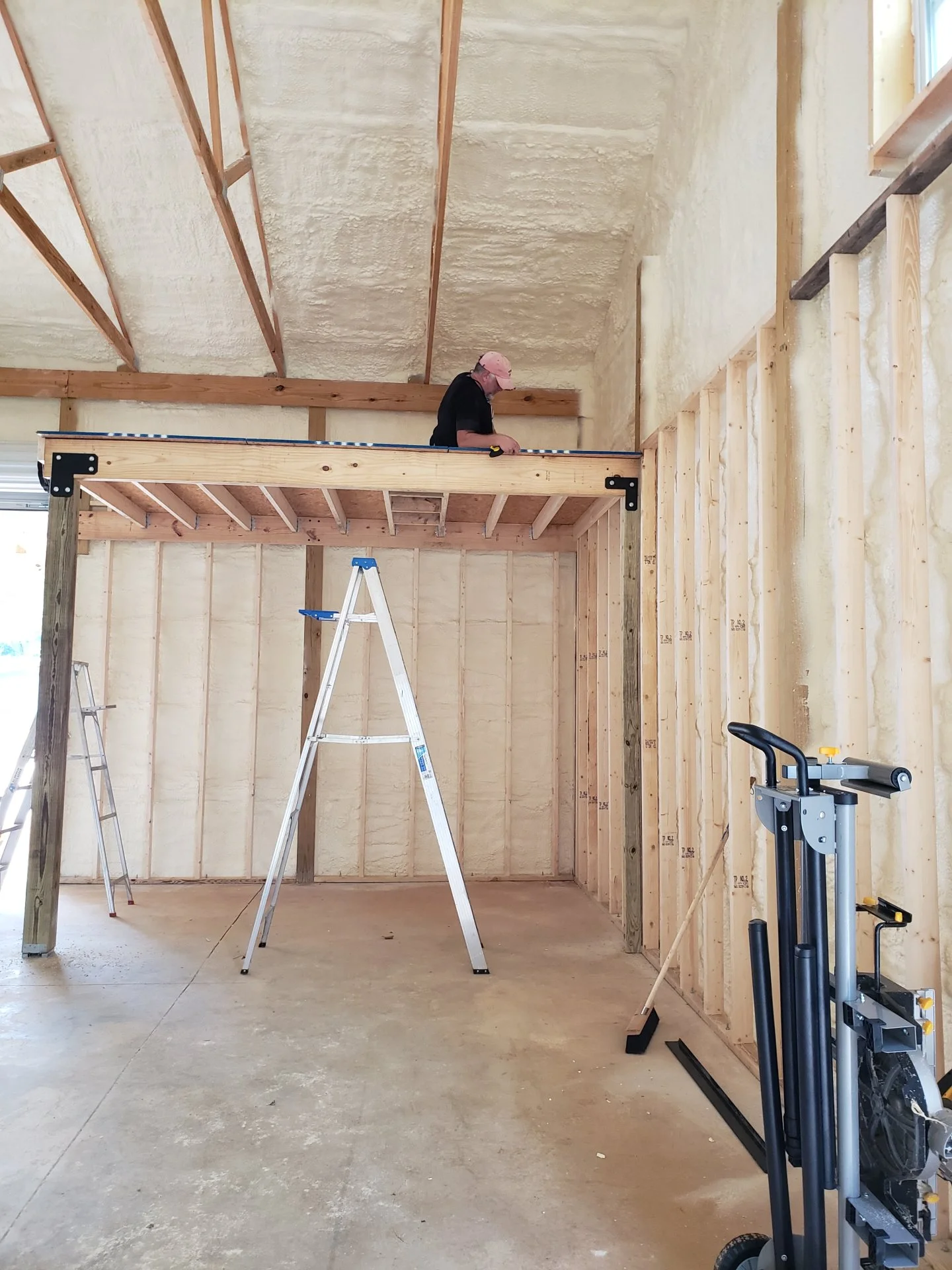

Got the shop walls studded for peg board and a wall cover in the work area and got the frame of the mezzanine done. Still need to hang the joists and get plywood but it is 6:30 and laborer (aka the wife) is headed out to hang with the girls.
The mez floor is 10 feet. I think I should have come down a bit but whatever. I had planned to make it tractor fork height but that is under 8 feet so punted that idea. Stuff that is up there will be stuff I will likely never need - spare axle housings, course birfs, crap like that.
Feel pretty good about it. I need to come up with a stair idea. If I could get an old aircraft maintenance platform or Home Depot stocker stairs that would be cool.

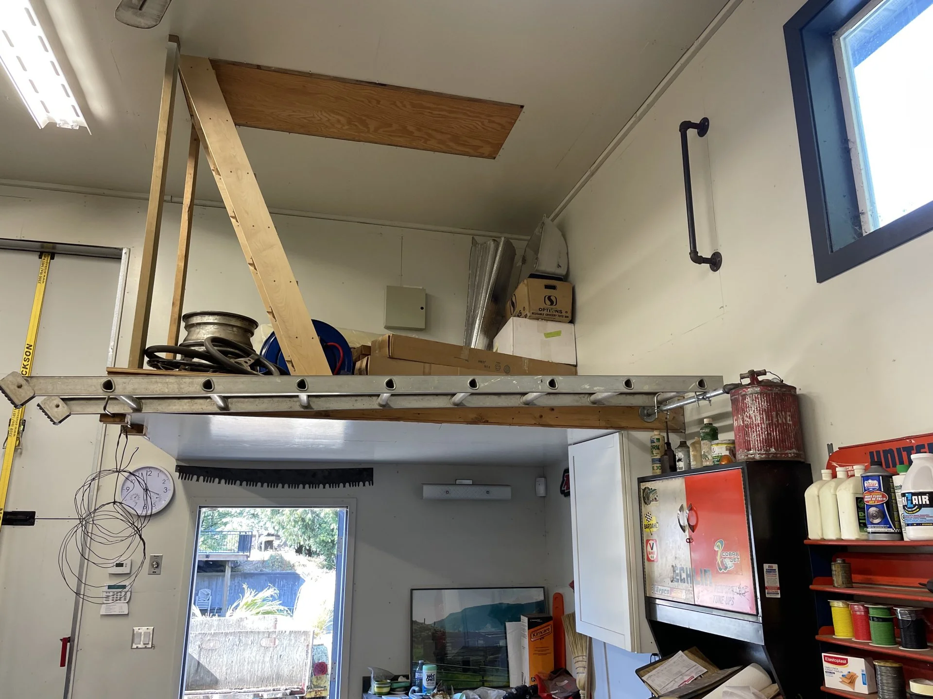

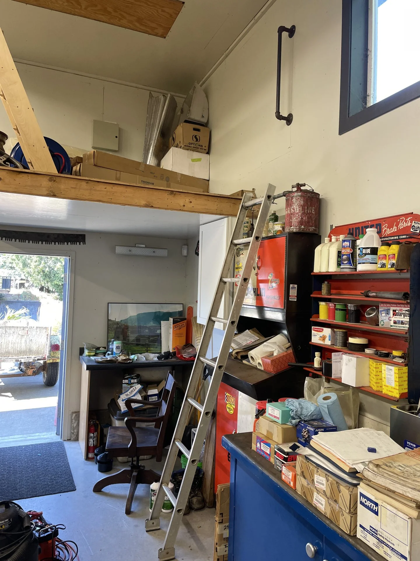

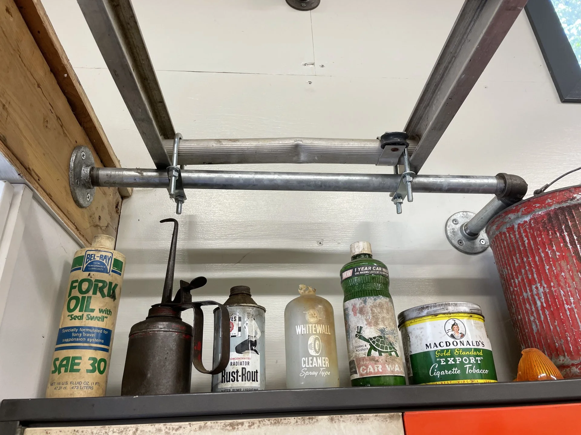

I took bottom half of an old alum ext ladder and hung it from the wall, it folds up to the mezz height so it doesn’t rob floor space.
I’ll get a picture that explains it, I’ve had it for years now and very happy.

I find 97" clear height to the underside is a good height for a mezzanine. Seems I have a lot of things on wheels that are about 8' tall so that height works for me.

Go lower while you still can. I had a mezzanine in my old shop that the idea was same as yours - storage of stuff I wouldn't need often. Shop didn't have tall walls so I didn't have much choice when it came to height but I frequently found myself up there crawling around or hunched over trying to move/access stuff. You won't regret stand up height if you can do it.

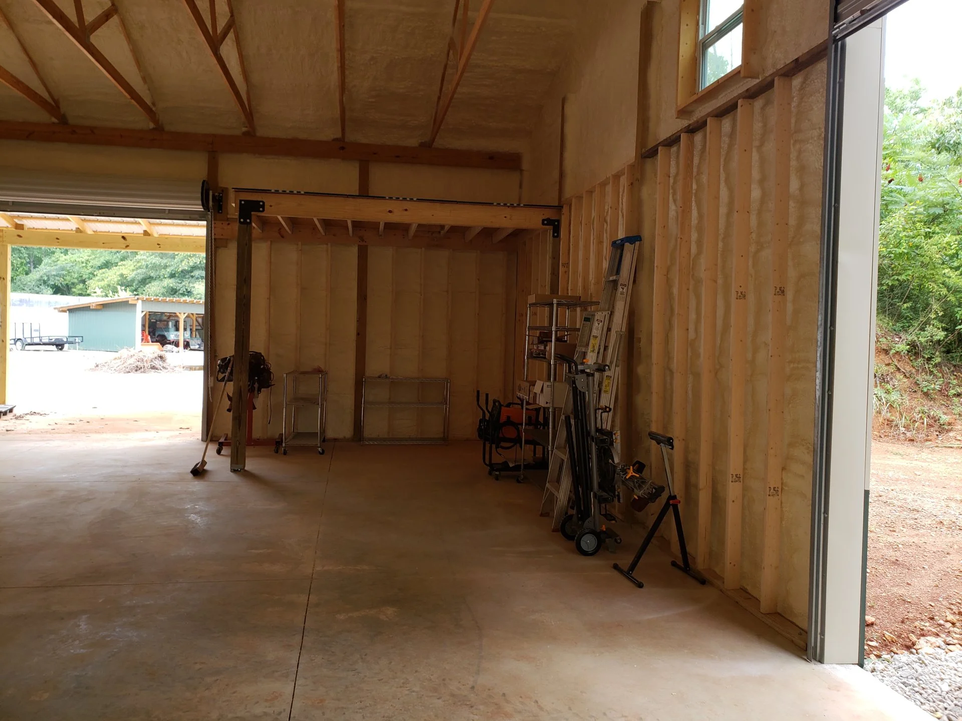

Finished it today.
I also went ahead and studded that last section of wall near the roll up door on the right. That is where the electric panel will live eventually.

Here is my repurposed ladder setup, I’m 13’ ceiling so the mezz is just a spot to hand stuff up to and then carry on up the ships ladder I built to the attic.
Is that a 2x12 joist?
Two 2x10s. I found a deck calculator that said it was good to span something like 11'4". Since there is no dynamic load (and nobody will be up there but me and some totes) I feel like I should be good. The alternative was three 2x8s. The joists are 88 inches 16 on center. I know the span is maxed out...or a bit more.

Also, where did you get those snazzy plates connecting the post to the carrier beam?
@jynx - I just happened on those plates on an endcap at Lowes. They were not too expensive (they had several brands and these may have been close out - yellow tagged). I started with a couple framing straps but saw these and thought they would look snazzy.
