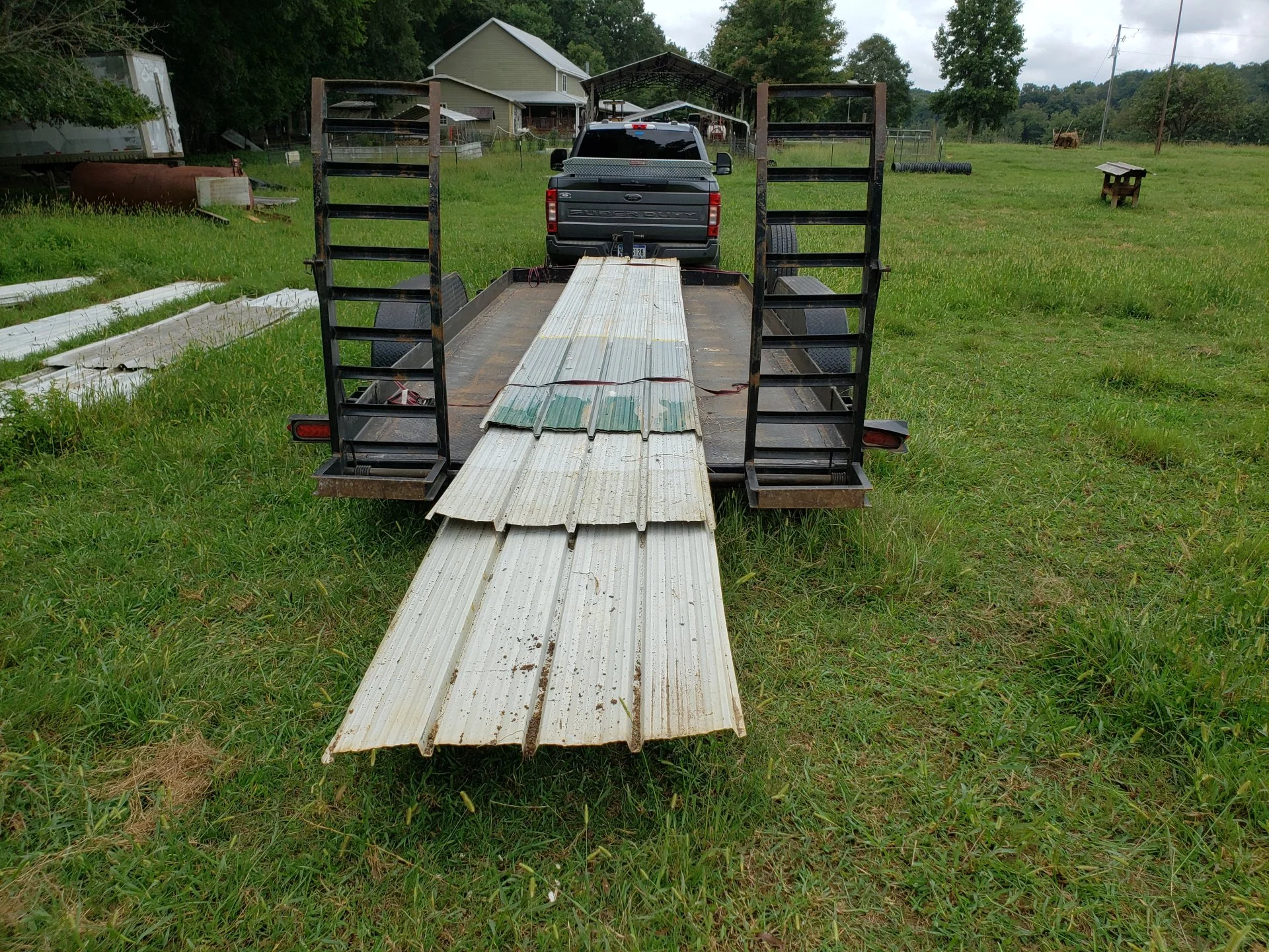

Scored some metal from my buddy's farm today. Friend and family discount. His in laws are trying to sell it for $1.50 a foot. He told me get all I want for $100. I probably should have taken more.
This is an idea evolving in my pea brain. Standby for what it becomes on the shop walls.

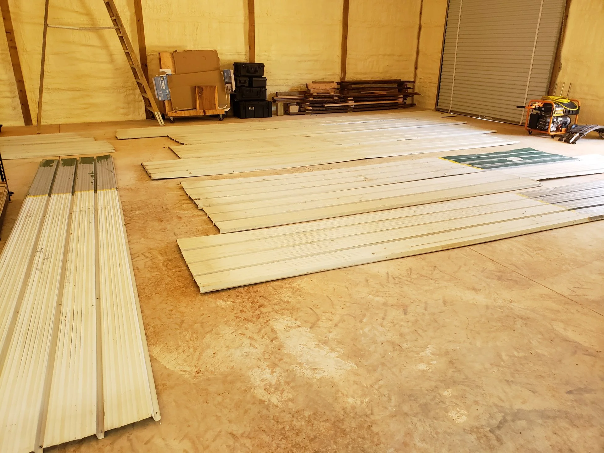

No pic but when my diff rebuild failed miserably today I pressure washed all the old metal I picked up. Front and back. It is all laid out on the floor of the shop.
It was a messy job but I am glad it is done. If I waited to long it would have been miserable to do when/if it started getting cold.

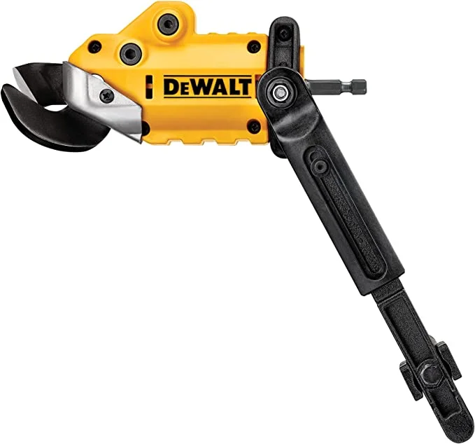

I am going to have to figure out the best way to cut it . I have a small plasma cutter. I need to cut pieces both directions width and length.
You need a sheet metal sheer attachment for your cordless drill. Lowes sells them for about $35.00. It works like a champ! Don’t buy a nibbler. They are too difficult to use with corrugated metal or sheets with ribs.

Was just shopping for that stuff. HF has an electric shear for $45 - and this weekend I get a free bucket :lol:
I'm not usually one to advocate supporting HF tools, but I have one of those $45 shears. It made all the small cuts in the 8K sq ft of roof on my shop. Still works just fine.
For straight cuts you cannot beat a metal blade in a skilsaw. I have Skil 7-1/4" and 12" wormdrives with metal cutting blades and they are very useful for cutting thin steel fast and straight with a very clean edge.
Although it is primarily cheap Chinese BS (aka CCBS in my house) I have gotten some good stuff at HF on occassion. I got a Bauer power planer and it has been fantastic for the price. I have put it through its paces. And the replacement blades are super inexpensive compared to the better more popular brands. Of course it is a great place to get something you may only use a couple of times too.
Got the shears. They are awesome. So easy to use.
Pile o'cheap old metal:
Becomes walls with a ton of peg board. That crap is expensive these days.
Not too bad for 6 hours of work. Had to stop near the end as my circular saw cord shorted out at an old break and I had to repair that.
I still need to throw some more screws in. I left a framed opening for my electric panel at one end and plan to run conduit on the walls. This is the work area. I need to find/build a nice big table in addition to my work bench that will be coming from the old tiny garage.
I still have plenty of metal to finish around the man door and make a spot to hang jackets and coveralls.
The metal looks great “backwards” like that.
