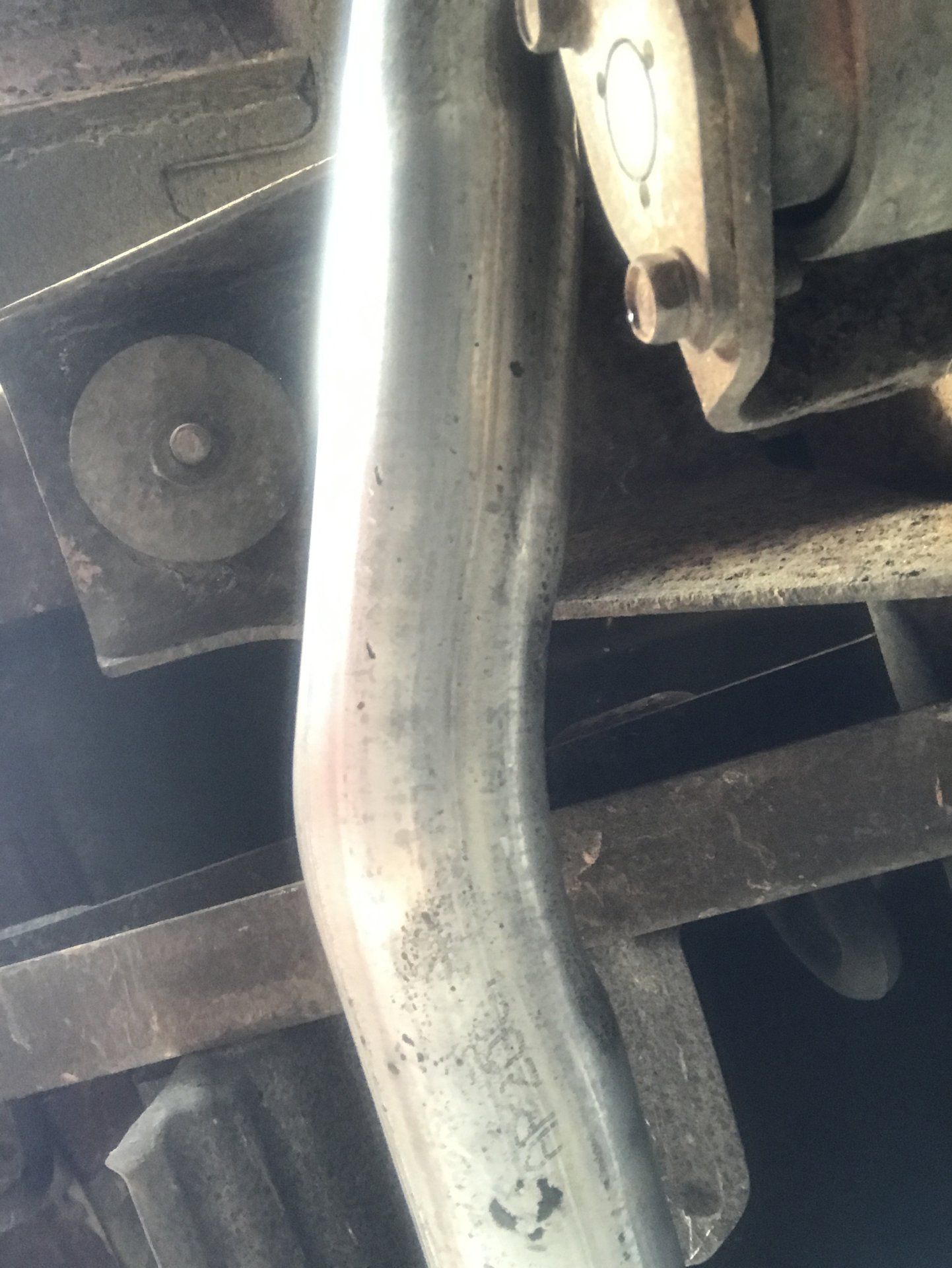

No progress by me this week as I am still awaiting the exhaust to be finished... found a couple of leaks and a clogged cat. Reusing the stock muffler, heat shields and hangar as they were in good shape.
Hopefully it will be done this week.

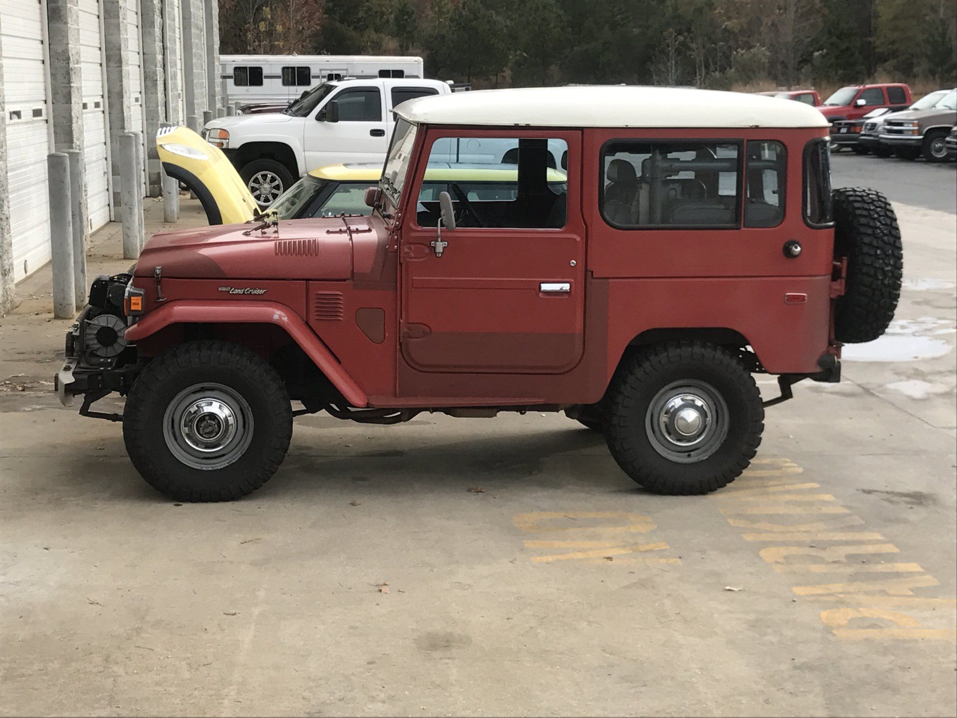

Here's a driveway pose from last week though as well as the work in progress exhaust.View attachment 1581108View attachment 1581109View attachment 1581110View attachment 1581111View attachment 1581112

Almost out of the woods. A lot has been done lately...

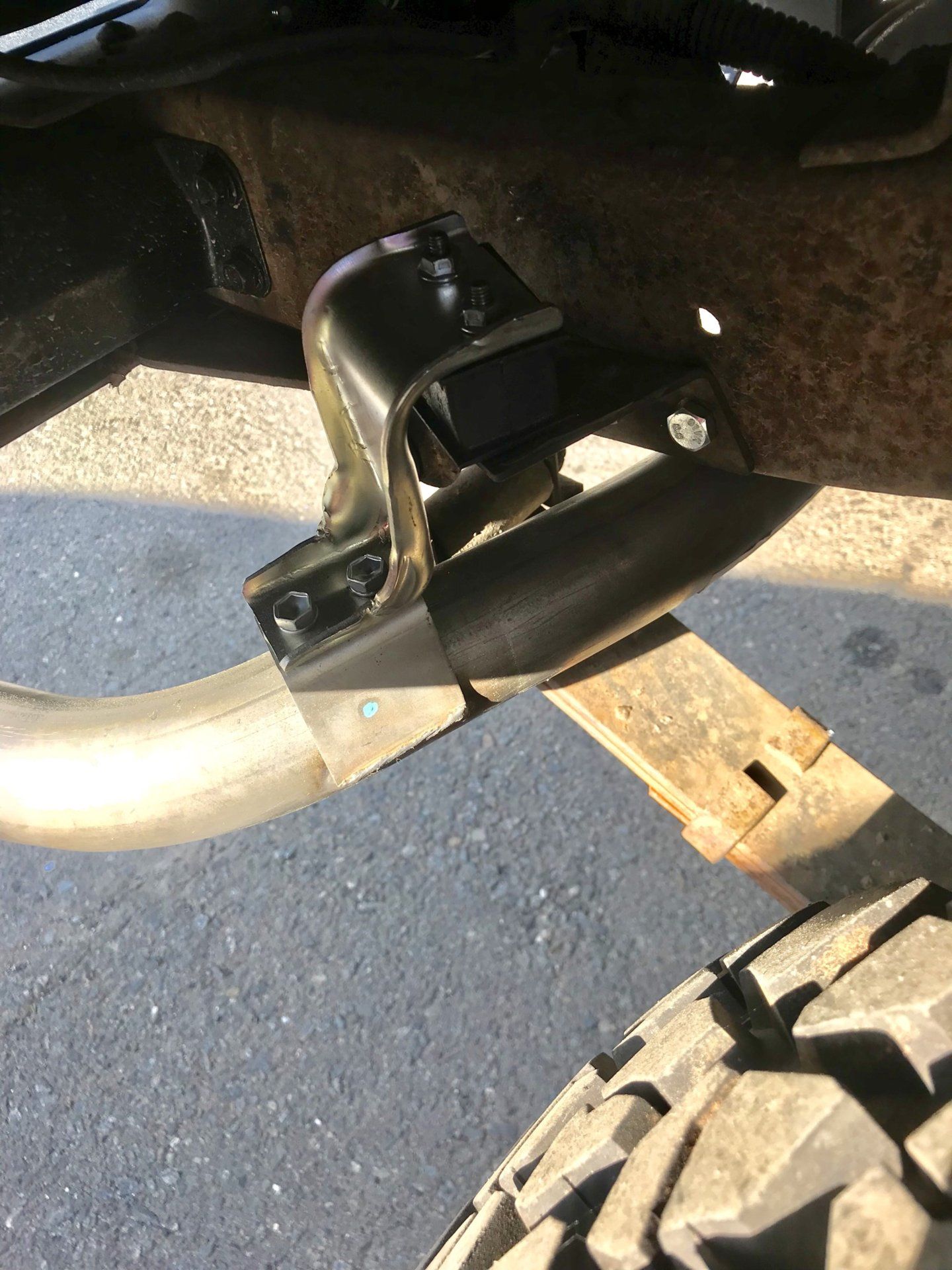

New Toyota muffler exhaust pipe is bolted up. Intake and exhaust leaks fixed, exhaust horns sealed and intake welded.
She's running, although not very smoothly. I'm just awaiting a new VSV and gas filter.
Still a lot to do before the Relic Run...
Next up, replacing; spring eye bushings, firewall grommets, rear main seal, brake caliper overhaul, new AC compressor, condensor, evaporator & dryer.

New OEM Toyota exhaust muffler.

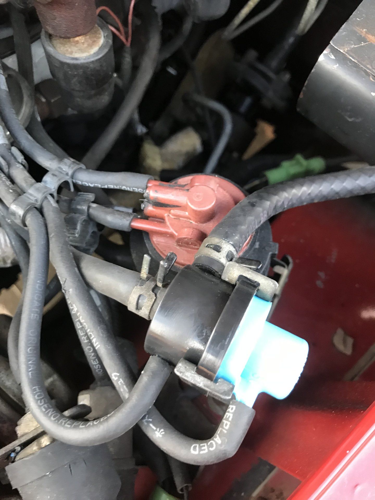

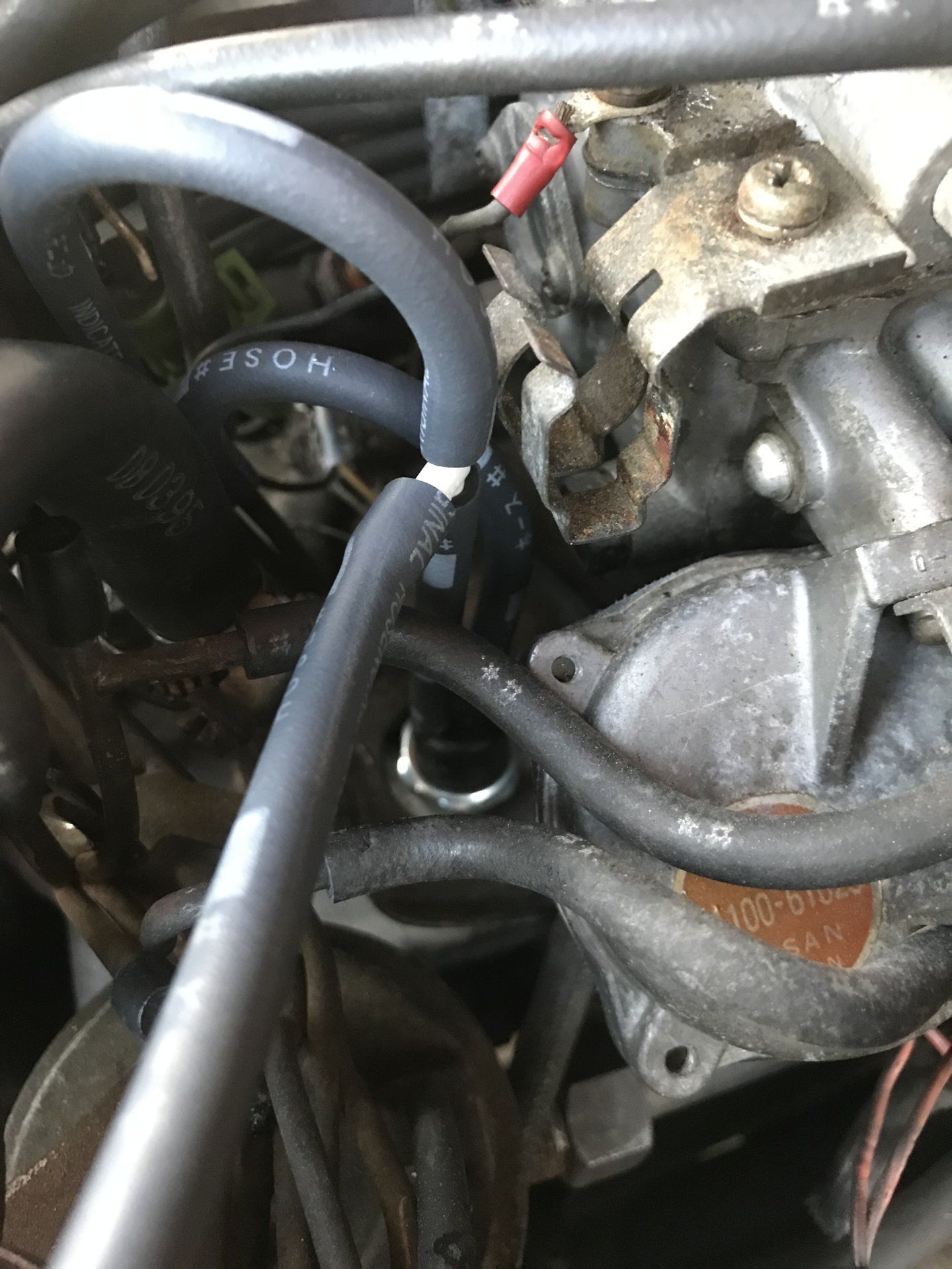

Well I got some new VSV’s in today from @CityRacer.
The evap side was simple as I just replaced the original one but the distributor side was missing when I got it. So after searching for a complete vacuum routing diagram I plumbed it like this thread My Desmog Keeping HAC Lots of Pics
The 60 has an intake manifold gas filter port with 3 nipples but the ‘79 40 only has two nipples on the gas filter. So I just placed a tee in between.

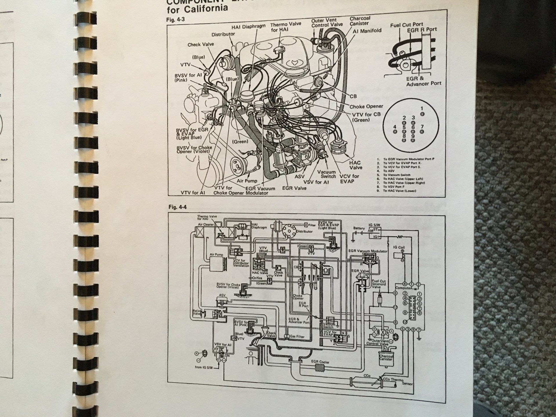

I have a 6/79. I’ll take some pictures for you this weekend. It would be very helpful to buy a emissions manual. They where available at SOR for maybe $25 a few years back.
2/79 through 7/80 are the odd balls. Welcome to the club. :cheers:
I have downloaded the 1981 Emissions Manual from Trollhole's website but don't have one for the 79, yet. I used this vacuum parts diagram for the 79 FJ40 but it clearly leaves out one of the vacuum lines on the VSV at top center of the pic
