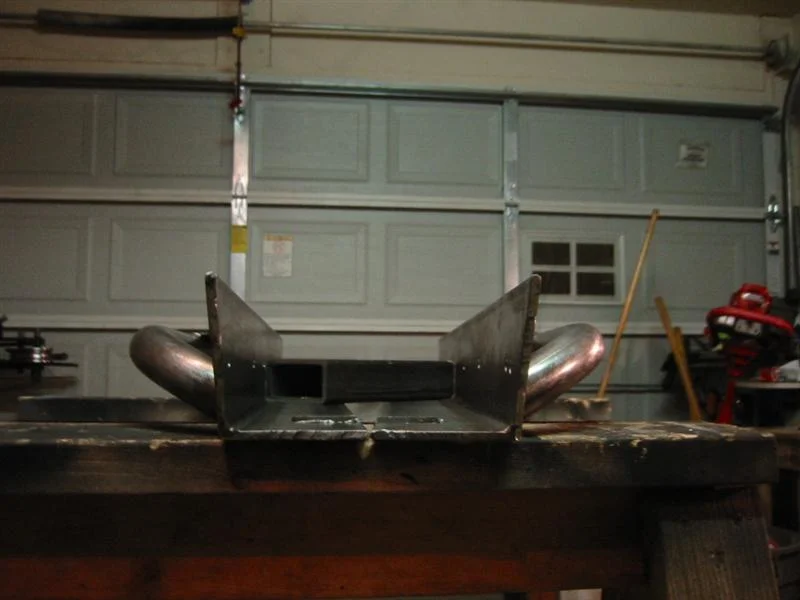

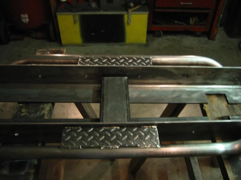

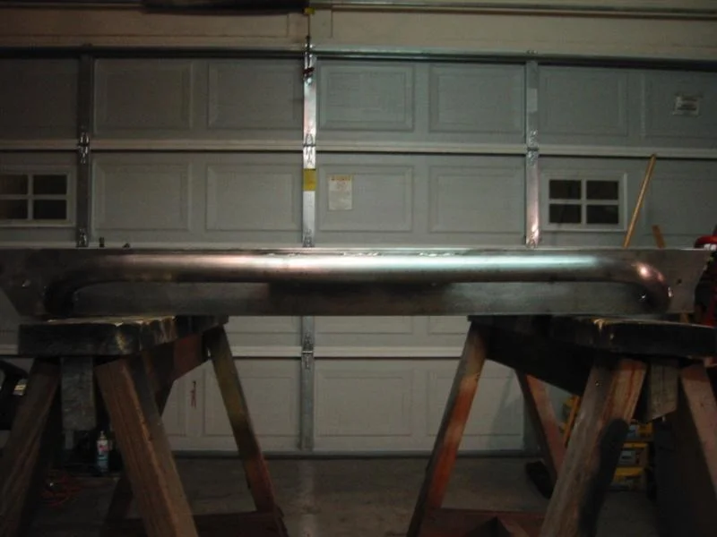

Hey folks,

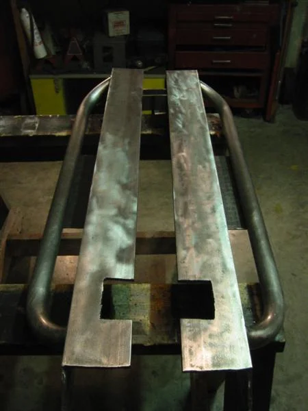

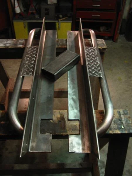

Finally got around to buildin up the sliders. They're my first so they're not perfected yet but they'll do the trick and give me a start to base future builds off of. I like the DP step but I'd like to also try just adding 2 evenly spaced tubes in place of the step to get that "totally tubular" look
, we'll see.
Just used 4" x 1/4" angle and cut out a hole for the frame's body mount arm extension thing, and 1 1/2" tube with some 1/8" thick DP. I had one bolted up and jumped around on it and it was super solid (being on fiberglass even
) and I think it'll be tough enough. I'll go plant em on some rawks and do the ol Hi-lift test here soon, pics to come.
If I find that they need some extra support to the frame I'll likely just use 2x2 tube welded atop the lower part running to plate bolted to the frame. I'll post up some pics of em installed asap.
Whaddya think?
Whaddya think?
