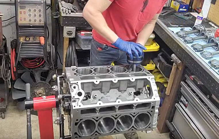

After everything checked out fine I final washed and painted the block.
Ready for assembly. Pistons installed, ring gap adjusted. Not shown, but I also weight matched new pistons and rod assemblies to the old ones to end up with the same bob weight and avoid costly crankshaft balancing.
