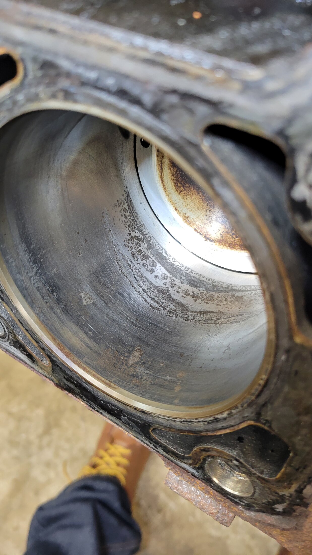

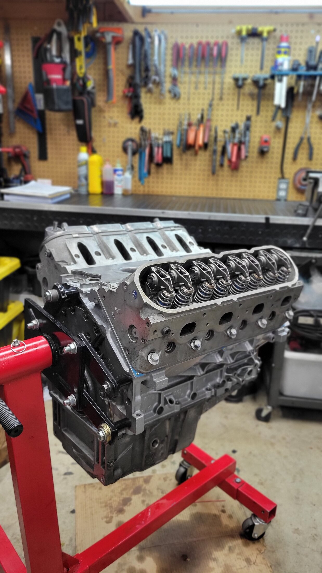

Initially I planned on using the engine as-is with a small cam/springs upgrade, but I noticed something in the #7 cylinder with the bore scope that didn’t look right. When I removed the head I found some strange damage/scoring on the thrust side. That triggered a full rebuild (block bored 0.030 over for new pistons, new rings, cam, rod and main bearings, heads resurfaced, cleaned, valves lapped, etc.) I have a new engine now and can actually call it 6.0L, and not 5.96L!
LQ4
Cylinder #7
Rebuild Completed

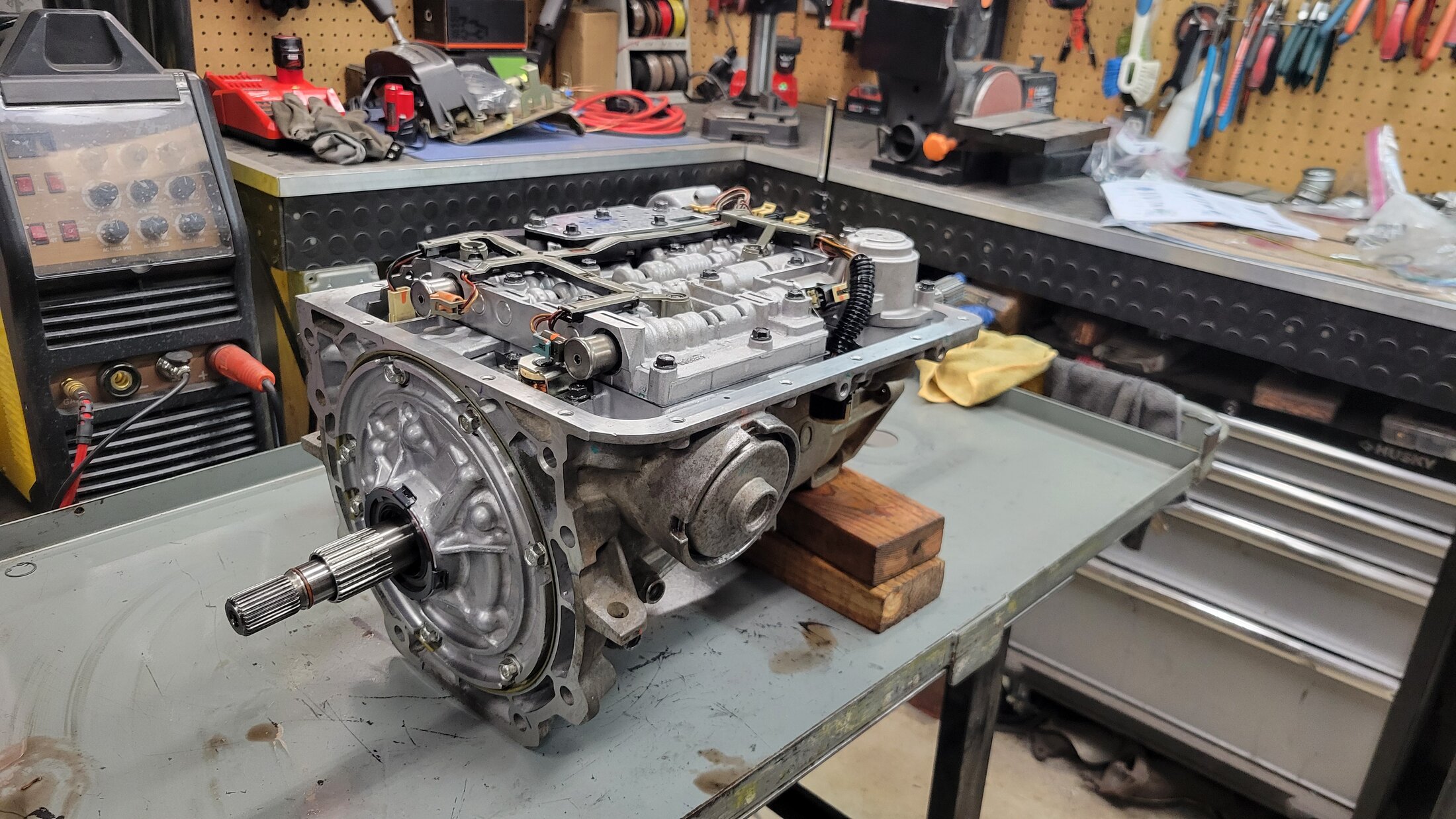

For the transmission I went with a core out of a 2008 2WD Silverado that lost 3rd gear. I rebuilt it myself with upgraded parts, shift kit. It should be good for the power I am planning to put through it.
4L60E

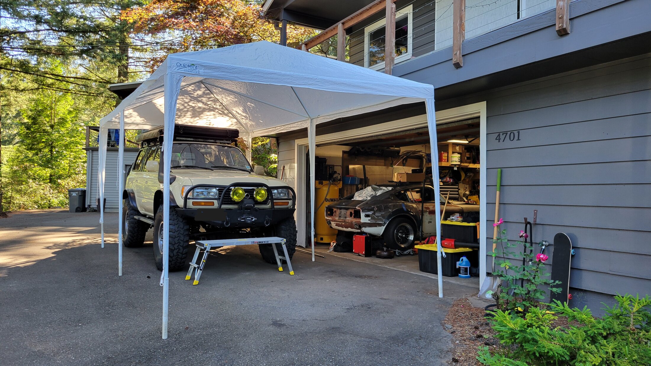

So at this stage I have engine/transmission Marks adapters, engine management ready. Almost all other parts are lined up as well.
This will most likely be a slow moving process, I barely have 4-5 hours a week to get this done. I am determined to finish this in 3 months and hopefully, contribute to this group.

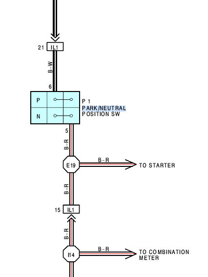

1) Ok, I had to go back and review the wiring diagram. I am using the LX450 EWD. IL1 = IH1 on the Toyota EWD.
You need to replicate the P/N switch, which was housed in the Toyota transmission.
I have to look at what I did (if I did it..😁) when I work on the truck next. I am using SwapTime's muscle car module which provides P/N output when my 6l90 is in those positions. The 4L60e should have something that produces a P/N signal.
I should have made a power relay that was activated via GND ( Relay pin 85) from the SwapTime's muscle car module and a 12V ignition source (Relay pin 86).
Relay 85: Park/Neutral Triggered GND
Relay 86: 12V ignition source
Relay 30: IL1 pin 21
Relay 87: IL1, pin 15
