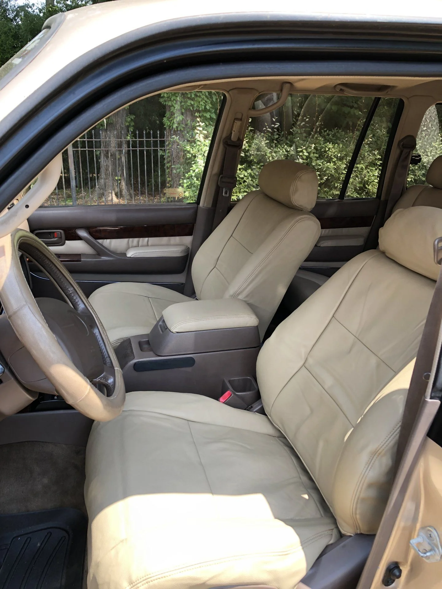

I am pretty happy with the FINAL RESULTS. The LSEAT product seems pretty good, obviously 15 years from now will really tell the tale... but so far so good. Even the local uphostery shop guy was impressed. There were a few imperfections, most of which would never been noticed by anyone. These are SMALL complaints. Nothing that would deter me from ordering from them again.
Some of the stitching wasn't perfectly straight,
There were a few "gotchas" that involved hole cutting,
The seat back top area seemed just a tad thinner backing material than OEM,
A couple areas seem a tad bit loose, but I believe this will get gradually better as the seats see some summer heat and use.
All that said, I am very happy, and the interior of my truck truly looks amazing now. What a DIFFERENCE!!!!!
What color Lseat covers did you get. I have a 97 LX450. Bisque seems a bit dark but is what they recommend. I am still waiting for samples. I've heard that the ivory is closer to the correct LX color. My outside color is white.

Cool! The leather will stretch and shrink over the seats a bit more with time/heat. Mine has nearly no ripples in it now. Tight!
