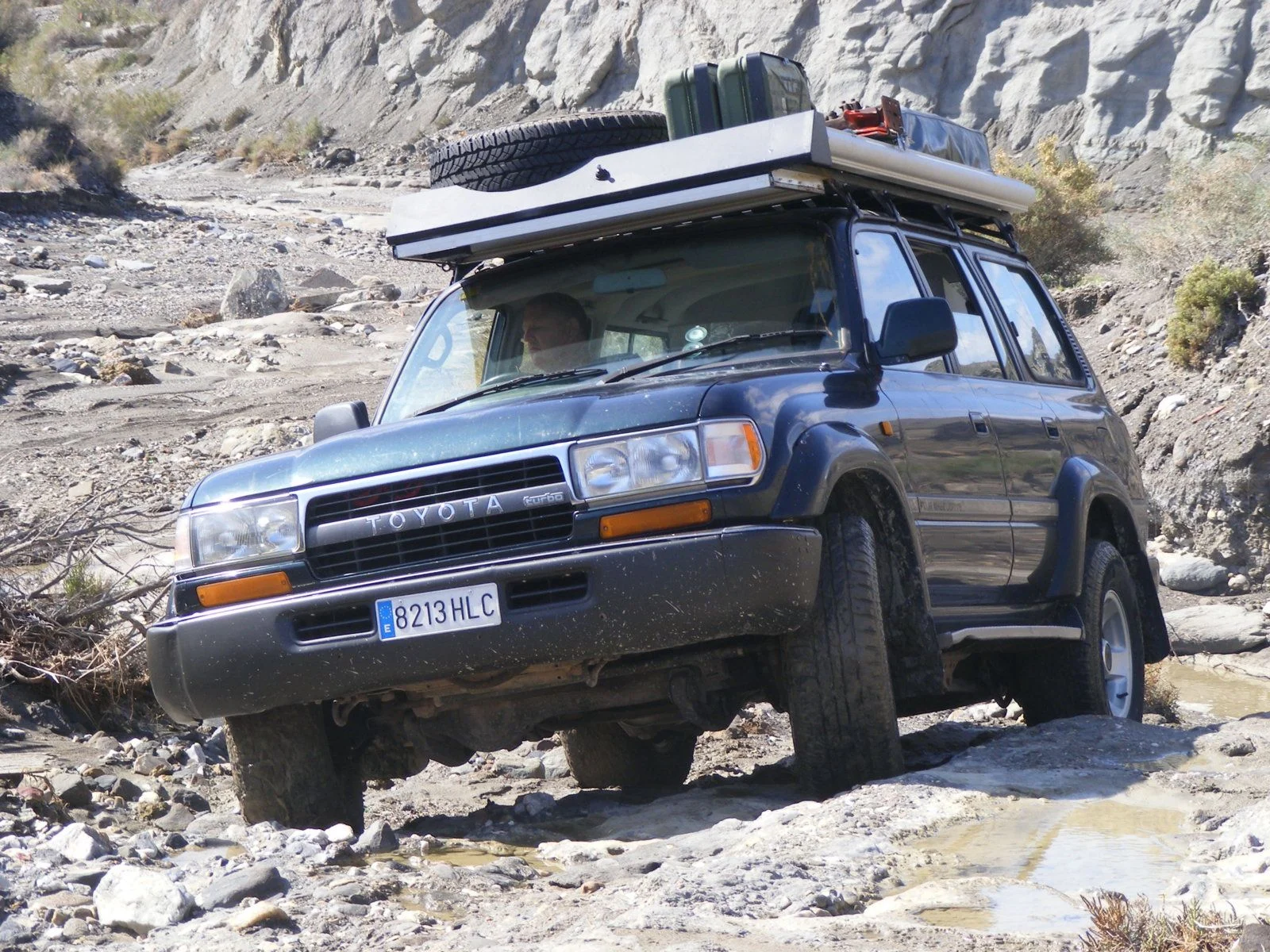

Quick update. Well the rain did give us some stick on the first day out but we were big and brave. 😀
I made good use of the awning for the first time, and a groundsheet tied to one end took care of the wind, we were all a bit damp and cold but by the morning all was good as the sun warmed us up. As there was no sun the first day I plugged into the site electric, and noticed in the morning the battery charger had stopped charging. Both batteries were still in good shape but it was noted. We went out on a couple of known trails and we got through but they had changed dramatically, I crept through a couple of side slopes that had become rather 'iffy' sphincter clenching was the order of the day. Plenty of mud about and I was extra careful knowing I was missing a locker. We got back to the site, and given the changeable weather it was a good call, hot showers etc. The following day the battery charger had again uncoupled, I thought it was a problem with the charger so decided on a test when I got home, the replacement Blue Seas 7622 performed as it should. So today we went to a known river bed and due to the 'Gota Fria' and the storms it brought with it the landscape had changed dramatically. What were flat and dry river beds had now been washed so extensively they exposed rocks of different sizes, blocking what was a path up to one of the film locations for the Clint Eastwood movies from way back when....no it is true I really am that old, anyway, we went for some rock climbing, nothing major but it really does expose how a front locker that I did not have would have helped, without it the wheels spinning and pulling the car off the chosen line, and of course a spinning wheel allows tyres to get cut on the slippery and very sharp rocks, my companions who had not done rocks before found them easy in their well prepared 40, it's short wheelbase helping it bridge gaps that the 80 bottomed out on.
There was also a rattle on the roof rack even with the chains and padlocks removed, it was more of a click than a rattle, it only happened when on the move and never whilst stationary, with the engine running, I need to look into that. Anyway, after the rock climbs we headed off to a favourite lunch spot and whilst still on a dry river bed I heard a noise coming from somewhere outside, I stopped and opened the door looking to see if I had a puncture, I then found we had company, it was the Guardia Civil above us in a helicopter, they moved in front of us and landed so they could have a chat with us. Unbeknown to us the government had changed the rules about 4X4's were no longer allowed in the river beds, the wreckage we saw earlier of a car caught in a flood had to be part of the reason. He did not read us the riot act but did take details of our vehicles and personal papers, he then asked we leave the river at the next exit which was about 4km away. We did as we told, at this time it is unknown whether we will be fined but hey it was different. I had to get back to work the following day and my friends had a social event they had to attend so at the end of the day we headed in opposite directions to our respective homes.
So what did I find after the long break with the 80 off the road? Well the relocation of the support bar that carried the sand ladders and Hi Lift jack has made getting the weather proof cover over the RTT and strapped tight a lot easier. Re the battery charger, since testing the charger it is fine, it simply does not like the fridge coming on and disturbing it's bulk/slow and then float charge routine. With the fridge off it does as it should normally, this is the second 'modern' charger I have seen with this facility and it causes the same problems, perhaps an older 'normal' charger may be in order? The final module of the camping gear inside was for various odds and ends and included food storage. As pretty much every form of canned food/soup comes in tins of the same size, I decided to capitalise on this by having the lower section sized to suit cans that can be inserted the right way up, they would have minimal movement to bounce around, and with bagged products (pasta for example) tucked in there all should be safe and sound. So with various cans the access was tested before the install........but did not work when the module was installed which I did not find until I was on the way to meet Rodger and Corrine with the 40. It is daft that when tested the module was on a workbench and the drop down flap opened a full 180 degrees, but when installed in the car the hatch did not open fully as it stopped against the carpet, this was enough to prevent cans being inserted unless on their sides, the complete opposite of what I wanted, anyway that will be address asap, it was one of those :doh: moments, :D
