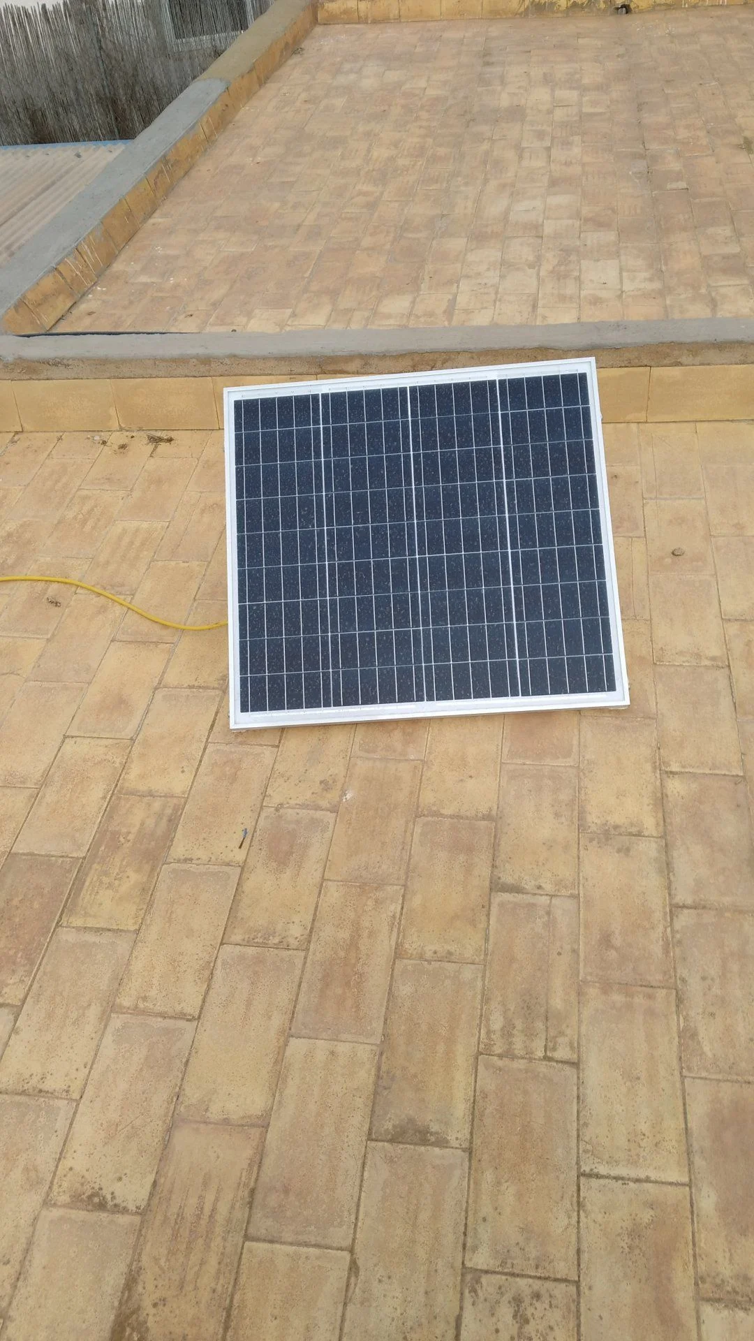

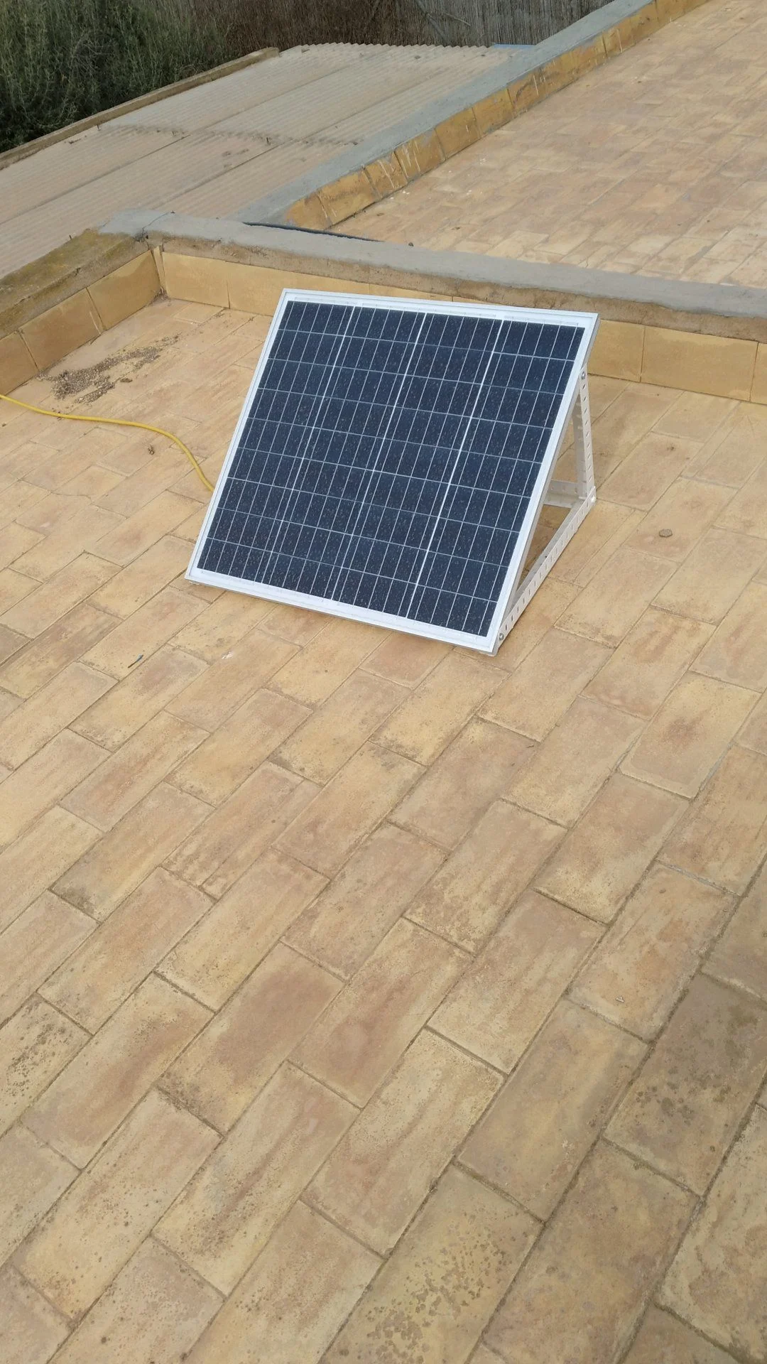

Well the solar panel arrived safe and sound and yesterday I made up a frame out of 'Dexion' to support it at around 45 degrees. I gave the framework a few coats of white 'Hardcore' spray paint and bolted the panel to it. I used the connector from my existing roaming panel so I could get the job done, a replacement connector is on it's way but won't get here until next week, I am not patient enough to wait. I placed the panel in the best position to get a good exposure to the sun, with it pointing roughly South it will be well exposed most of the day as the sun passes through from East to West, I am only looking for less than an amp a day so this will be fine. Being a 'Cortijo' style house with a flat roof the store rooms have the same design, and drilling these to make fixings can be risky, these houses are old and I could be opening up a can of worms with leaks etc. So I purchased a new tube of 'No Nails', this is great stuff and I have used it in the past. With the panel in place I masked around the three runs of Dexion and lifted the panel away, I gave each run between the masking tape a good squirt and with the can empty I lowered the panel and frame into place, the idea being the adhesive would pass through the holes in the frame allowing it to hold fast.
Next to the cabling, with a small hole drilled in the rear wall of the garage I run the cable through and up to the roof, with a couple of MC4 solar connectors it was easy peasy. Back in the garage I took the plug and pushed it into the socket in the rear bumper, with the switch on the distribution board turned on the up went the voltage, all my panels are 20+ volts and the regulator soon does it's job. I checked eveything a couple of times earlier and again just before typing this, all is fine, we do get some viscious winds here so I am going with fingers crossed the adhesive holds. 🤞
Now the 80 can sit in the garage out of the sun and both batteries (the second via a VSR) will be maintained fully charged, my last check showed the panel putting out around 3.2 amps and the regulator increasing this to around 3.5, this will of course reduce as the regulator comes out of 'bulk', so all good, a very well worthwile mod.

Well done! Have any pictures of the panel?
Sure I will pop up om the roof and take a couple, it is a typical unit, nothing special, it is half of the wattage of the one that slides out from under the roof rack, and the third that plugs into the back bumper with a long cable for roaming purposes.
I will get a pic tomorrow if I get a moment.

in the meantime a couple of snaps as request of the solar panel on the roof will be posted in a short while.

@SteelHunterFJ80
The pictures you requested, the framework is from 'Dexion' I had from some old shelves that were going rusty and were thrown out. The Dexion framework is held to the roof tiles by 'No Nails', this saves drilling holes and risking leaks, it rarely rains in this part of Spain but when it does......it really does, and it was ironic that last it 'persisted' down for some time, followed by a windstorm full of dust and then a two second downpour just to make sure the cars and terraces were filthy with dust!
