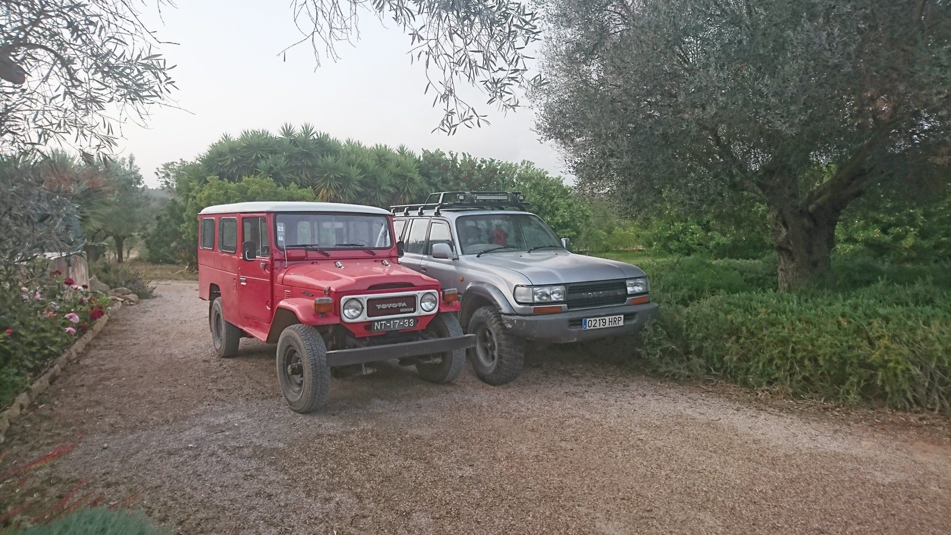

she also made a new friend, a very old lady from Holland showed up..

Nice Dutch truck :clap:
