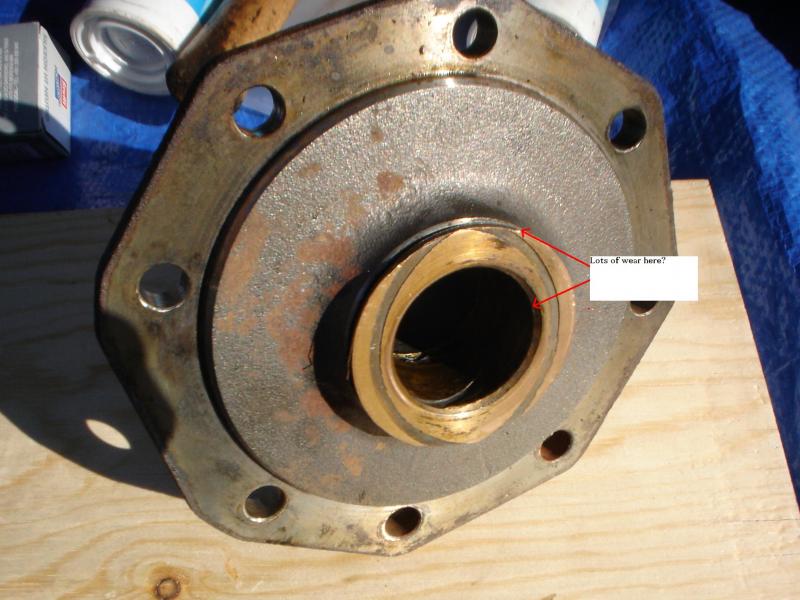

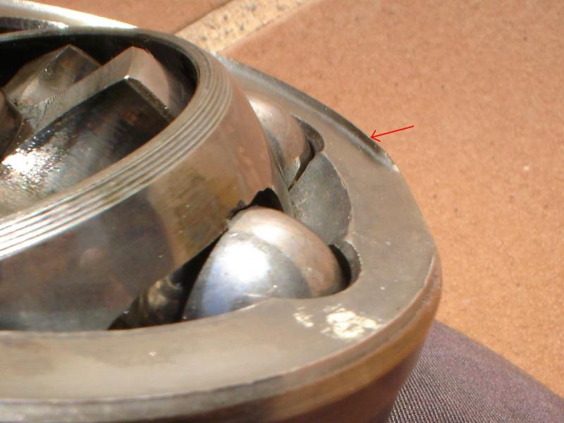

OK next update! Friday I started the front axle overhaul stripping, cleaning, greasing and reassembling ect. The RH side (drivers on mine) went according to plan and this side was the one where the swivel was nice and dry. Apart from a split pin needing to be drilled out of the steering drag link all went well.
Now to the other side, this one was leaking oil/grease quite badly and finding the breather blocked was nothing new however, once I had dismantled everything and started to clean I found the CV or Birfield had a strange wear mark on the outer ridge of the CV body. It seems the bronze bush in the front cover is badly worn? The birf flaps about inside the cover like a prick in shirt sleeve! So that will be ordered Monday evening, the joint does not appear to have any damage on the bearing surfaces and there was no nasty noises either, has anyone seen this before?

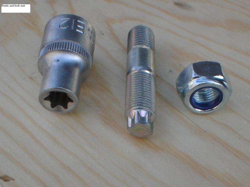

I have added a couple of pics for your perusal, also having heard of forum members in the past having their front lower arms work loose I decided to replace the four studs on each side, these studs are a 'torx' style and fitted nice and tight with a little loctite. The brake pads have seen better days so can someone post me the Toyota part number for the larger pads that have been fitted on 80's to reduce or at least slow the wear rate please? IIRC they were for a 100 or 105 series?
I will get back to you later this week when the other parts arrive.

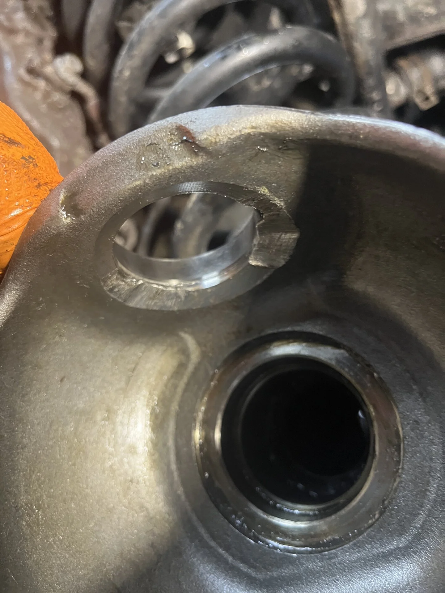

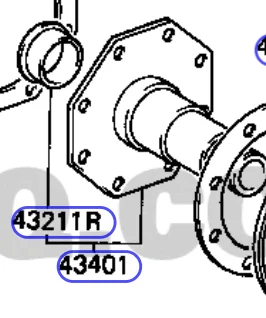

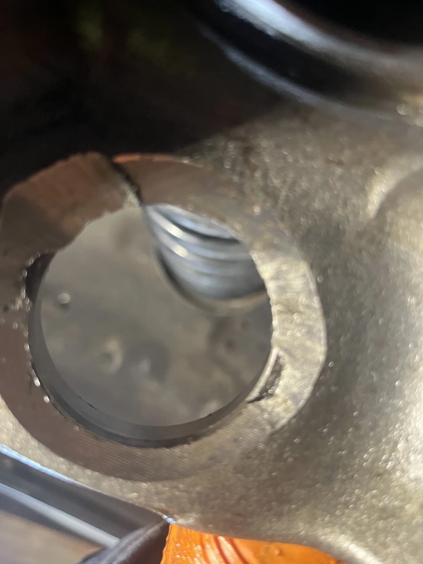

I had similar damage to my birf. Did a new brass bushing (43211R) get your problems resolved?
