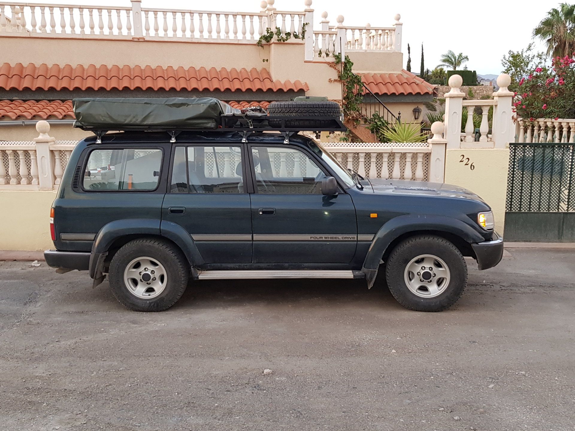

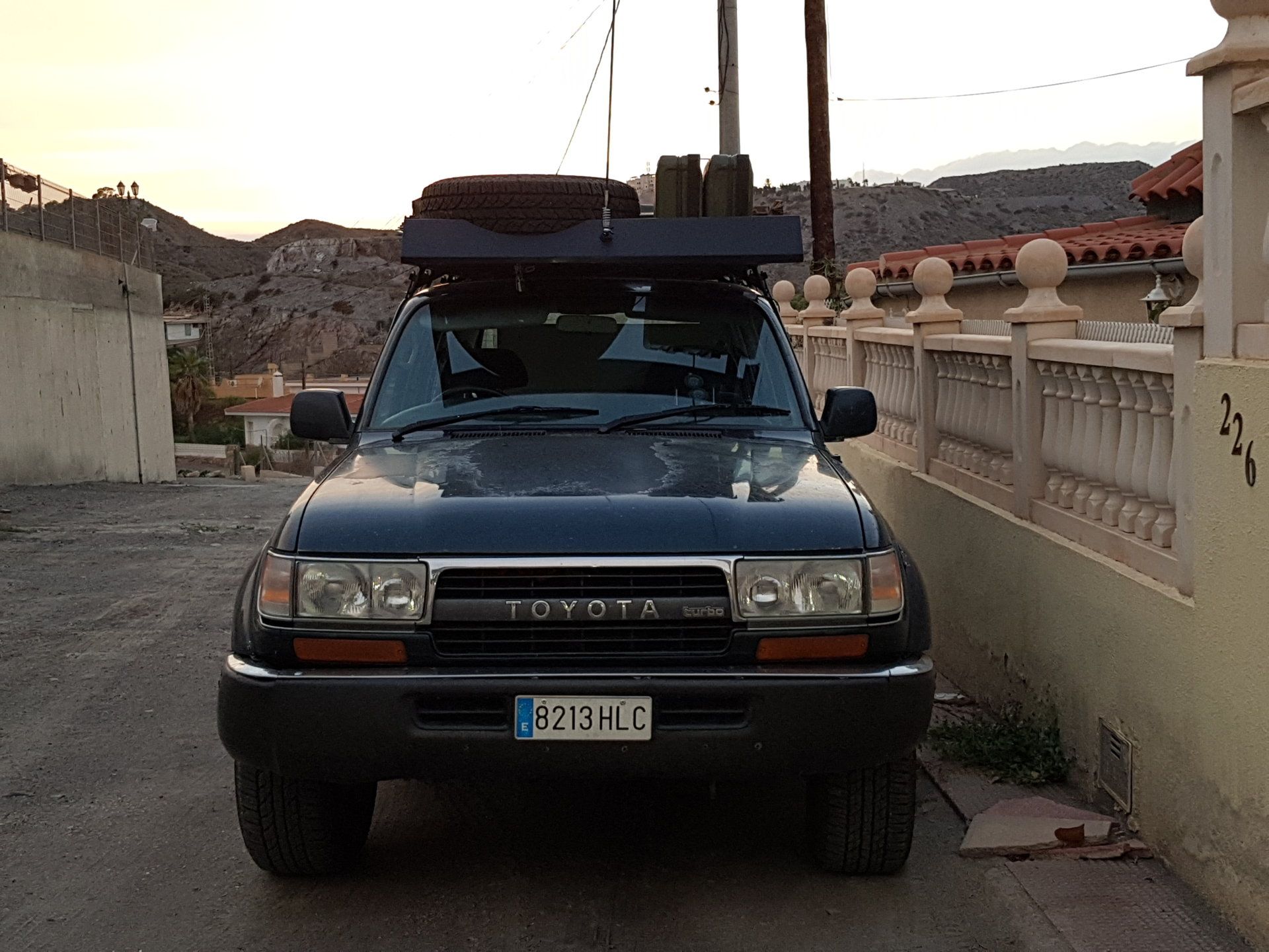

how much was she pressed down from the extra load? its a shame you didnt get lower wheel rim to arch measurements front and rear under full loading for reference.
I got the rare opportunity to briefly stand mine next to a stocker a couple of weeks back. I think he's still on his original factory suspension, and stock tyres, and basically empty, whereas mine has an extra 350kg (the usual 200kg plus 2 kart engines, 2 x 45kg dogs and a full tank) in this pic
If / when I had this much weight on my standard springs we would have been nose-upwards and handling like a Sunseeker
Edit. Google pics did this to one of my photos, nice huh? standard permanent 200kg loading there.
Hi Kev, there are pics and videos aplenty, mainly taken by Rodgers friends, if they come my way I will post a couple up. The car is still loaded up, we are out again this coming Friday for a couple of days, if I remember I will grab a tape measure.
The pic of the standard version looks like mine, sun is setting so getting dark here now, but snapped a couple of pics for you. She looks s little low in the rear but road is uneven, and left rear is in a dip, when on a level surface she sits pretty much level. Living higher up our mud track drains pretty quick, but we have to suffer the ruts and holes lower down on the way out.........well until the neighbours get together and bung the local who owns a JCB. :D
For your information (and my memory), the weight over the rear axle is 1,500kg, and front is 1,340kg.
I will use these figures when choosing my next set of springs/shocks, TBH the stock setup rides really good both laden and unladen, other than looking for some extra ground clearance I am happy with the performance 'as is', so don't wish to screw it up, Mr T got this area of the 80 spot on IMO, but my long suffering fuel tank armour tells me a couple of extra inches would be good.
Hmmm, pictures loaded a bit odd, adjusted spacing and looks OK (to me) now.
