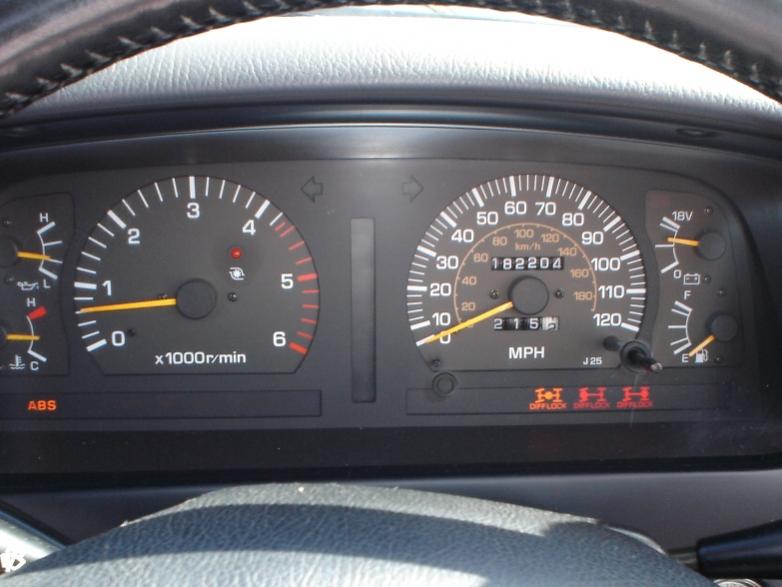

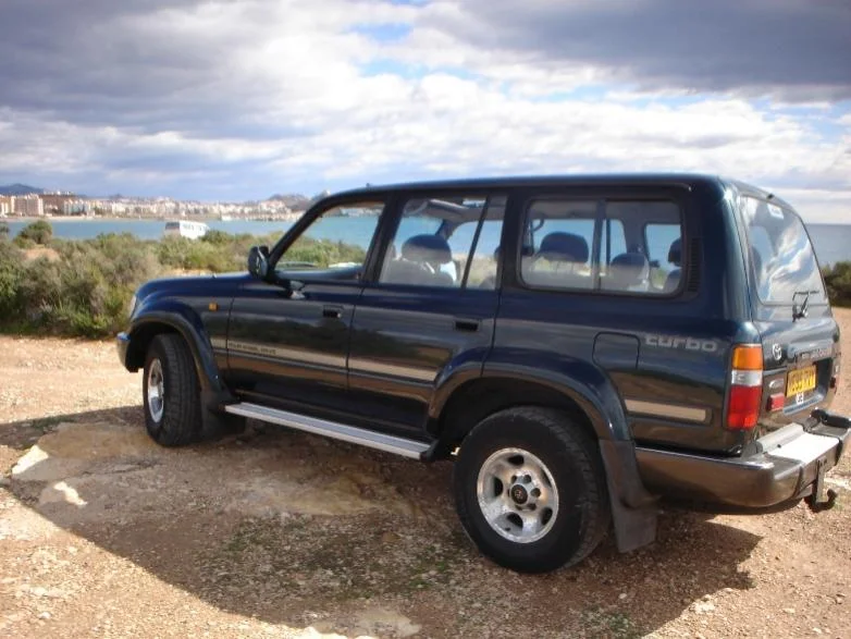

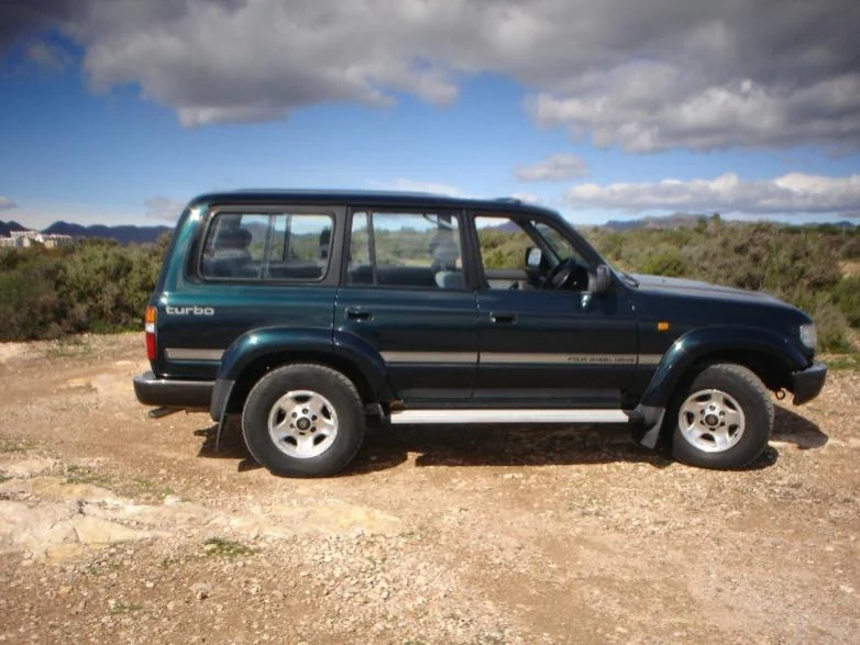

So, I popped over to the beach today and took the diff locks for a walk and gave them some exercise and bingo all working perfectly, scrub that job off the list :D
Next some pics: I am not exactly 'bathe it daily' so apologies in advance.
Just the three for the moment but you get the idea.
thanks for comments so far.
regards
Dave

Well it looks really....ehm..... very .... greenish? :flipoff2:
No serious.. judging from the pics it seems to be in good shape... i like the fact you can open the rear windows aswell. Previous owner didn't do any mods at all? Is this the older or lastest model 80 with the new dash etc?
