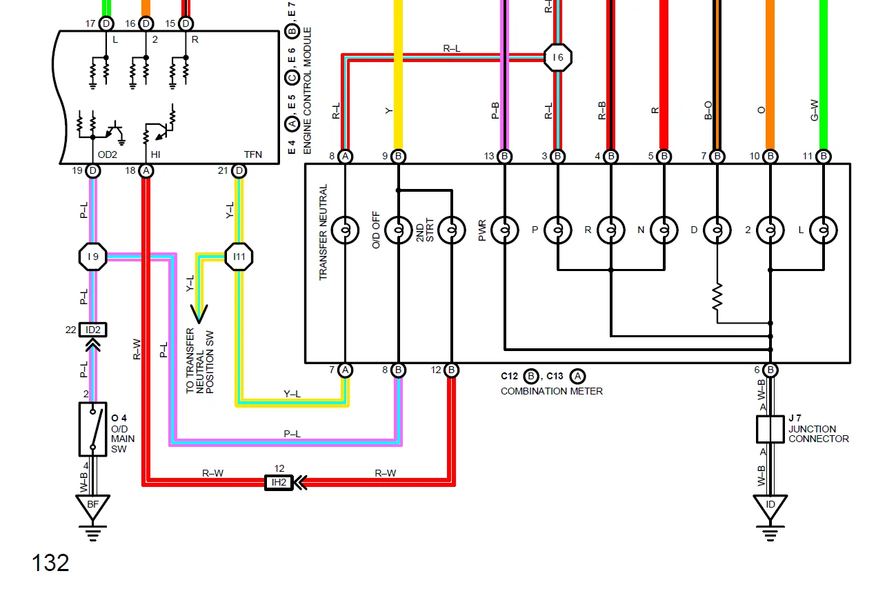

It seemed like the OD actuation was malfunctioning. Does anyone know how the OD button works? Is it an electric mechanism?

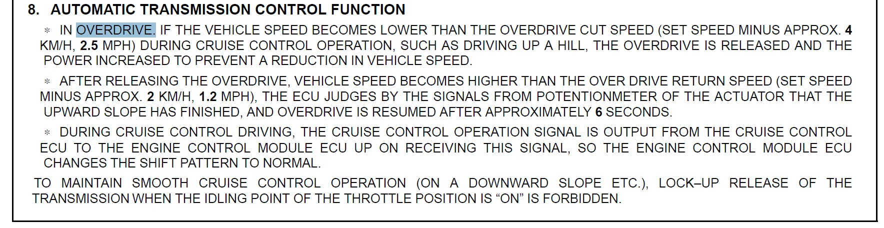

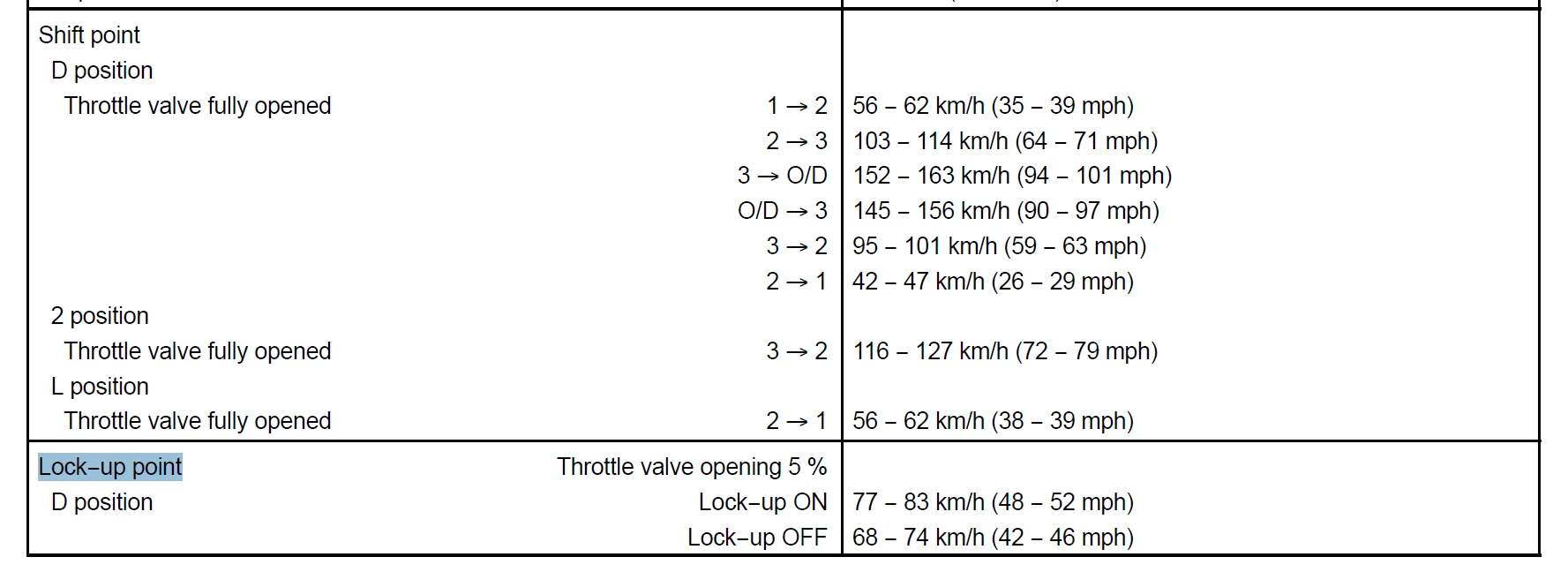

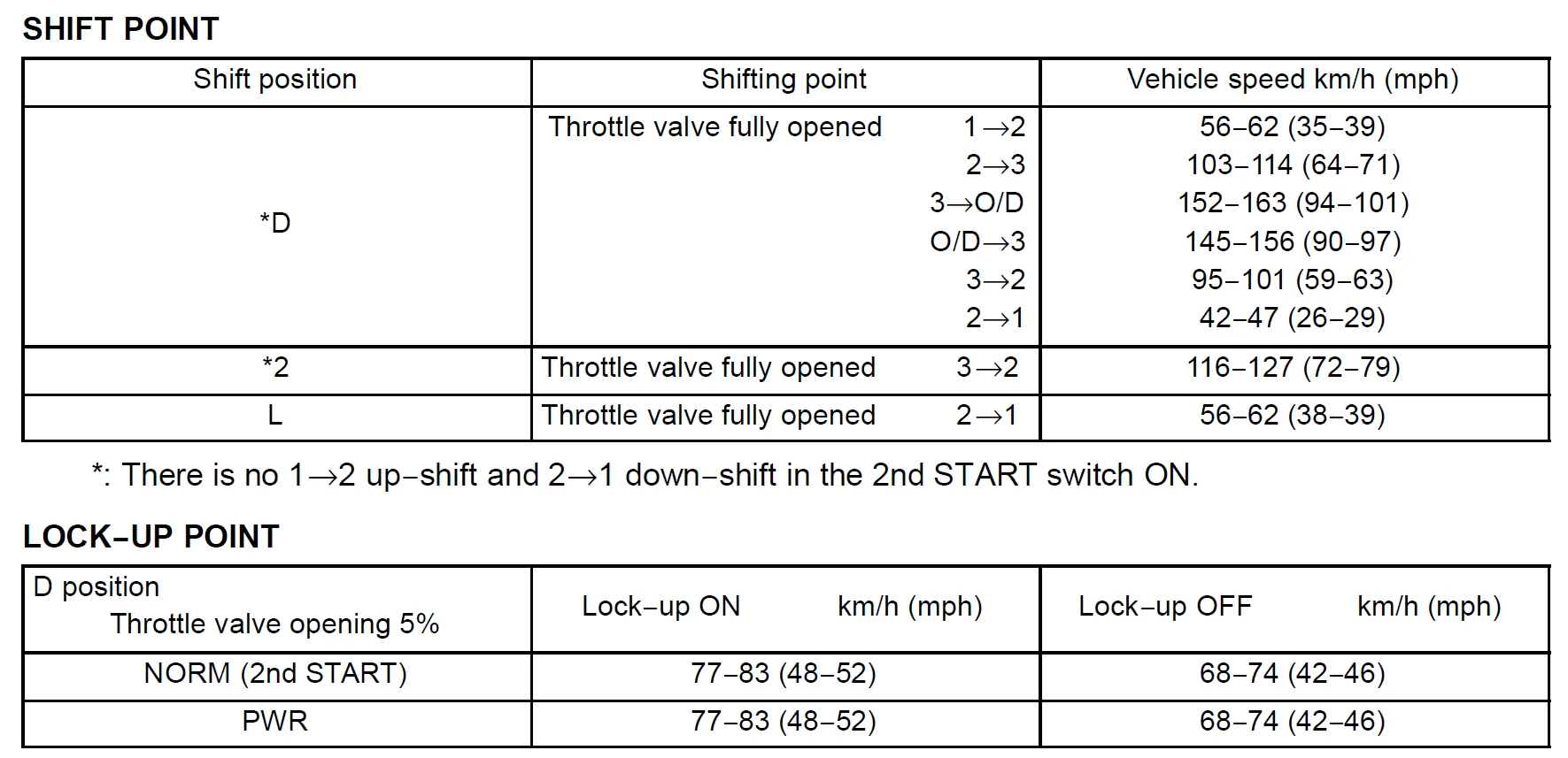

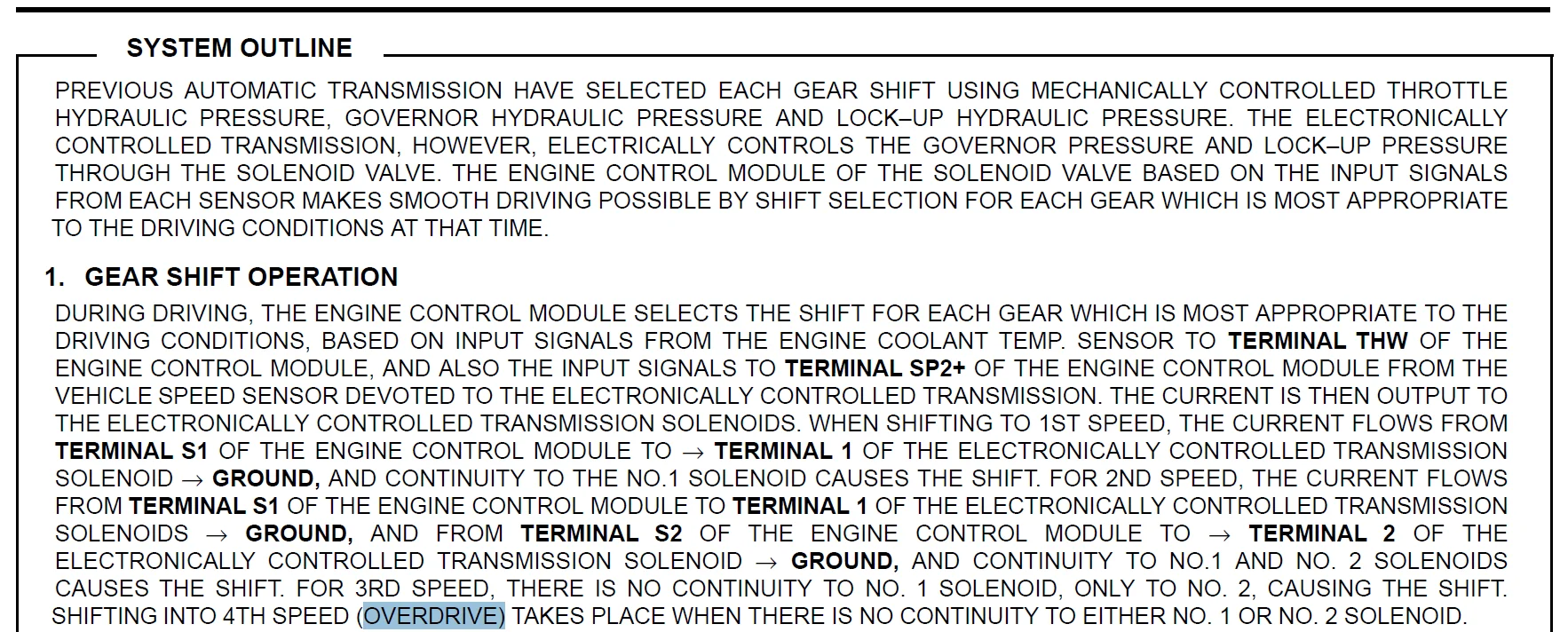

From the service manual (transmission section):
(from the Cruise Control section):

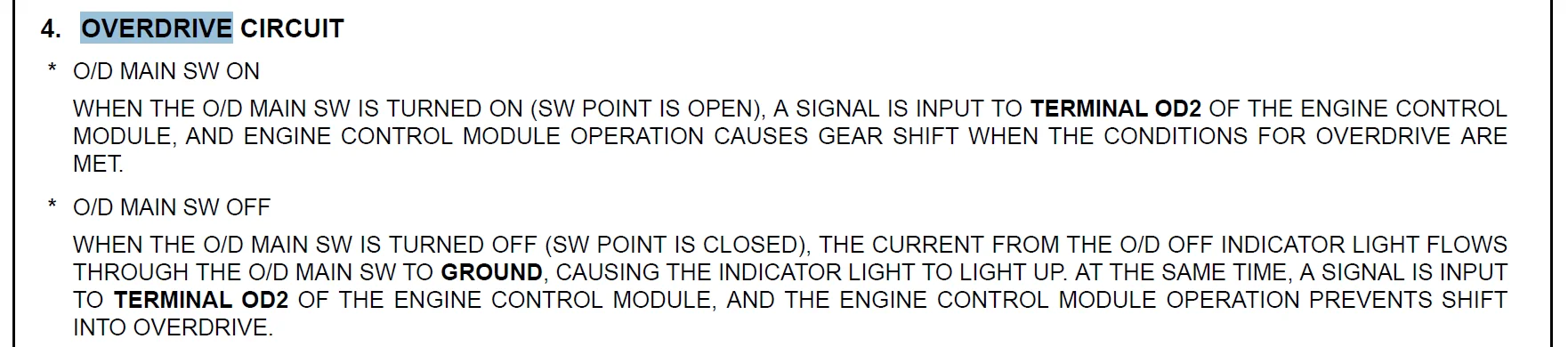

The transmission control circuit makes decisions on which gear to use based on several inputs, one of which is the O/D switch. Yes, it is an electrical switch, but it's not directly connected to anything, except the ECU (and the combo meter light).
