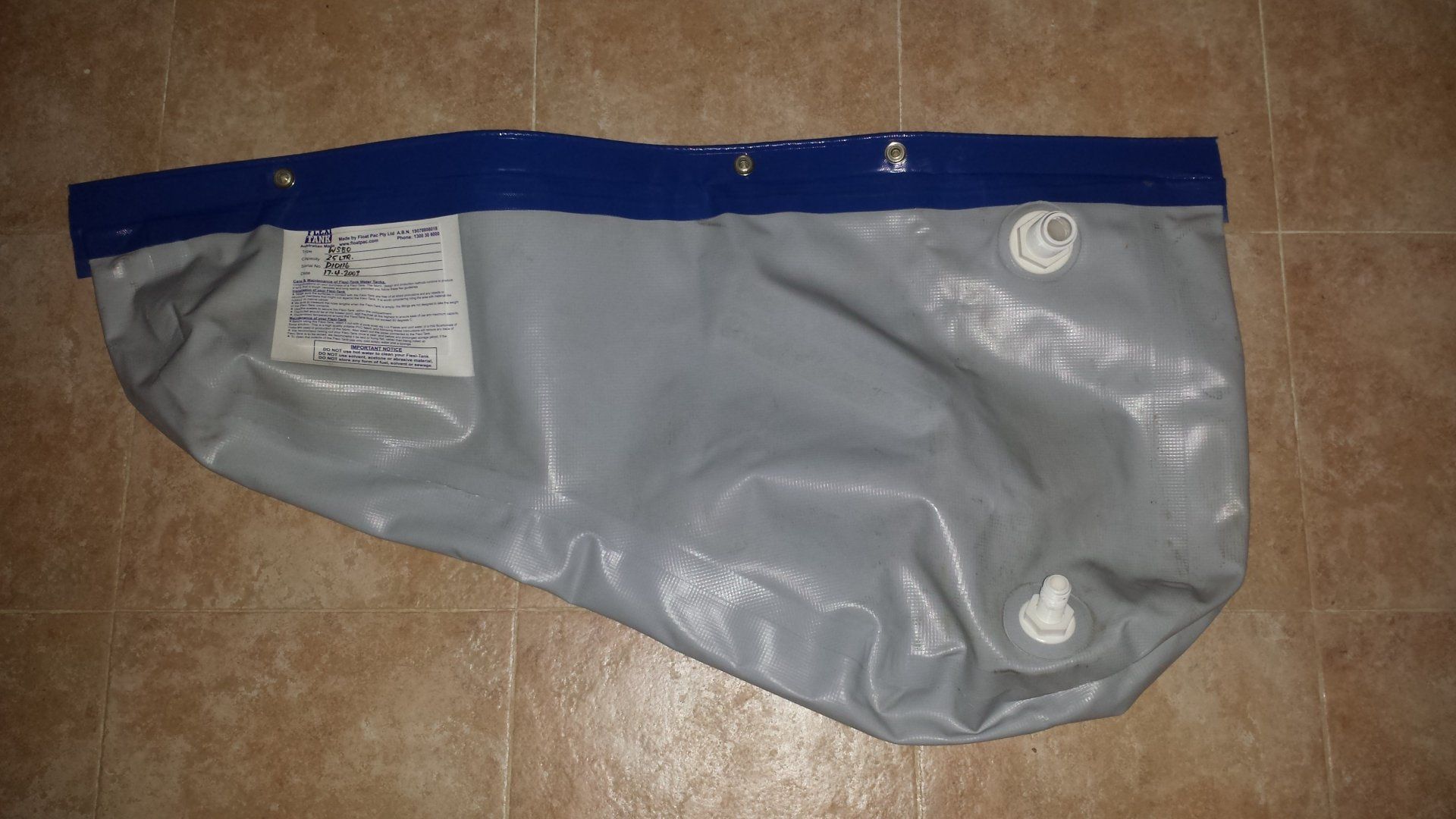

Cool rig! Mind sharing any pix of the flexitank and how you installed it/what it looks like? Thanks!
Hi, this is the flexitank.
It has a marked capacity of 25 litres, but IIRC it is nearer 27....ish? Fitment pictures in a 'safe' place, if I find them I will post them up.
The tank goes in the right hand rear quarter, if you remove the plastic panel complete with the little box the bag goes right in, the rear box part of the compartment is removed from the trim. I lined the cavity with a foam insulation material. The bag is suspended from the three nuts you can see, for whatever reason one of the three holes did not line up on the 80, I am unsure if this was an issue with my particular car or the bag manufacture, but easy to rectify. After making holes for the fill and supply pipe, the plastic trim clips back in place. The lid of the little storage box goes back and if removed it just shows the side of the bag, so in effect a dummy.
Now that was the first attempt, after a couple of months the second was more successful. I will explain.
The main problem is the weight of the water, it causes the bag to bellow out at the side, this pushes on the plastic trim and causes it to bulge outwards. This also makes the fill pipe pull down on the trim putting a crease near the filler neck, this causes it to make filling a slow process. Another issue is my passengers kept mentioning they could hear water sloshing around, I could not hear it at the front unless all windows were up and it was quiet in the car, I had never noticed it prior to someone mentioning hearing water.
So the bag was removed while a batten was measured to fit across the opening, my carpenter friend (Pete) used doweling as being round it will not dig into the bag material, which incidentally is very strong anyway, but just being careful, I also had some similar cuts of doweling and had then fitted around the curve at the wheel arch.
Next a piece of IIRC 8mm ply was cut and shaped to cover the straight area of the plastic panel, this was then screwed temporarily in place. The plastic trim then curves out towards the front and rear of the body, easy for the plastic but not the wood. So I cut the curved pieces off the plastic trim and fixed them to the wood panel, a sheet of material glued over the top covered it all nice and neat. The wood along with the material covering has made the movement of water pretty much inaudible to passengers, I have not noticed it either but, having said that I never noticed it before.
The pipe at the bottom of the bag gravity feeds into a 12v water pump with a pressure drop switch, this can be connected to a pipe for use, this is mainly dog water and hand washing at stops on the trail, there is a connector so it can be quickly connected to a shower head, the water is quite warm at the end of the day so nice to get rid of the daily dust. The heat is radiated from the sun on the dark coloured paint through to the bag and some (guessing here) rising up from the exhaust?
This was finished around September last year, no signs of bulging at all and has seen plenty of use. Use common sense with water cleanliness.

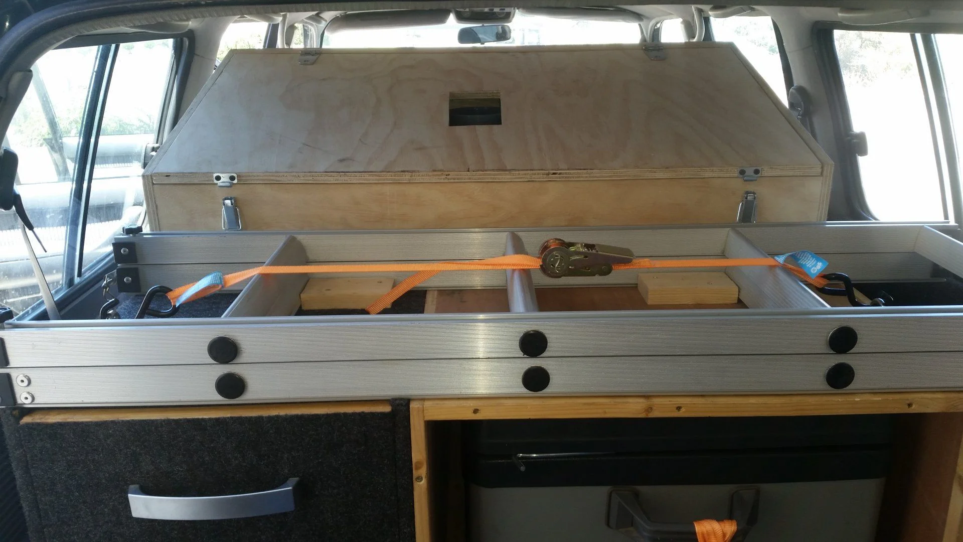

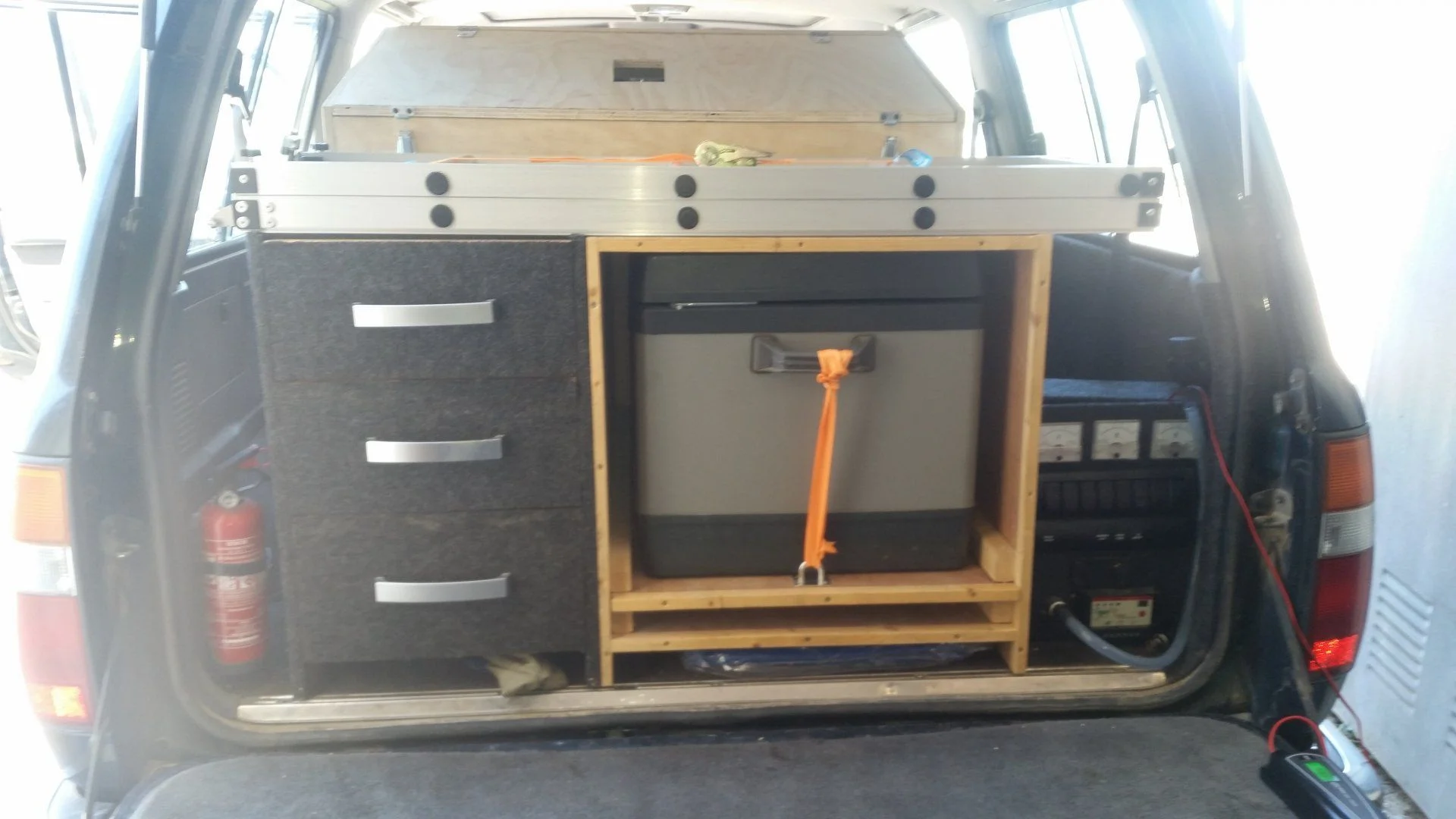

A quick follow-up of my last post, and the pictures that have been requested.
The top box has now been constructed, it looks as if it simply sits on top of the drawer and fridge box but in fact has four steel legs. They are inch box section welded to four inch quarter plate, then inverted and screwed down from inside the box, the protruding legs locate in corresponding holes in the drawer and fridge casings, once the strap is released the box lifts off, quick and simple. The observant will note the sloping lid, this because there is limited space above the box, the lower front does reduce capacity but makes it easier to load. This will have sleeping bag, pillows, spare clothes, and of course Cookie's travel bag with her bed and dog brush, doggy shampoo, and towels. The slope also discourages putting items on it and blocking the exhaust hole (see next pic), for the fridge.
A strong ratchet strap runs up from the third row seat mount, then through slots in the top box and once hooked to the opposite seat mount the ratchet is pulled tight, nothing is going to move. The small blocks in front of the box are spacers for the ladder.
The lid of the top box has now gained a hole, a tube runs from the box base to the lid, this is for the fridge exhaust , the air inlet is on the right hand side. The ladder is located by the small blocks, the quick release strap making removal and install easy.
This completes the rearmost sections, having a box around the fridge is great, I can put stuff on top off the box without affecting fridge access. As can be seen I started to cover everything with a dark Gray material but run out, I may end up purchasing a different colour as I am having trouble matching it up.
All the 'modules' can be used independently or with each other depending on my trip plans, I continue to alter and adjust according to my needs. I am not happy with the fridge to slider strap, the pressure on the handle quite high to prevent or at least reduce side to side movement. Next is the fridge wiring, at the moment the wires exit via the ftidge air intake, so that needs to be sorted. I would like to 'T' into the water feed to the pump and run a transparent pipe vertical to the water bladder in the right rear wing, this would make checking the water easier than guessing. Apart from getting a new supply of material I am ready to get Peter to start on the boxes that will go in place of the middle row seats. IIRC when visiting certain areas in Africa (bucket list) you have supply a seat for an armed guard, so one seat will need to remain, but this will be a rare occurance.....I hope!
Off out again this coming Tuesday for two or three days, 40 + degrees expected, this is a reccie trip for a future event, but again allows equipment installs to be tested under real trail conditions.
Thanks for the interest.
Regards
Dave
