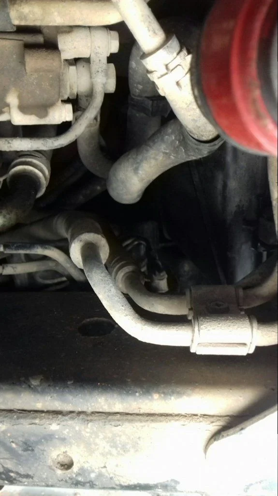

I see the steering cooler now, yes vulnerable and rusty. so just the new cooler on the trans and the PS through the rad is the way forwards then. gracias gents.
edit. I just went and looked under the car. this is not as simple as it sounds, as it looks as though the cooler wrapped round the frame at the front is an integral part of the flow and return to the steering box?
ie, removing it leaves 4 open pipes, 2 at each end, and only 2 tubes to connect into on the rad? it seems like I could only remove one side of the "paperclip" by re-routing through the rad but would still need the other side for the return?
what do I need to do here exactly?
mm. definitely confused here lol.
the parts diagrams all show some sort of loop affair, like this
http://www.euro4x4parts.com/parts/dfh1022-2183_power_steering_pressure_hose_44420-60260.html
however mine most definitely is 2 separate pipes, both terminating in the steering box the other side.
here's the passenger (left) side going down to the frame
and heres the 2 pipes coming back out the other end.
is this the same as yours? so I would need to route the flow through the rad to the box, and run a long new return pipe?

Power steering consists of a reservoir of ATF, the thing you top up. The ATF runs out of the bottom to the power steering pump on the engine where it is pumped to a high pressure. From the pump it goes direct to the steering box where it does it's work turning the steering. If you need to replace this pipe you need a proper hydraulic hose with swaged ends; do the whole run in hose and forget the metal section. A good hydraulic hose shop should make you one up while you wait; it's best done on the car so you get the right length, it's pretty stiff hose. Having done is work the ATF now returns to the reservoir. For this run low pressure oil pipe fixed with good Jubilee clips is fine and it is this run which can go through the radiator. The ATF returns to the reservoir, near the top, to start it's journey again. I think if you follow your pipes this will all make sense!
When fitting the oil cooler be careful not to fix it rigidly to the body as they don't like vibration much; either use rubber mounts or fix it to the water radiator and share it's rubber mounts. Above all don't fix the top to the radiator and the bottom to frame as that will shake it to pieces double quick.

My return pipe went into the top left of the oil cooler did the 'paper clip' thing and then exited on the right side back to the reservoir, maybe there are different variations for manual versus auto, I cannot see why but possible?
regards
Dave
So there were three lengths of pipe across the front on the return making four in total? I am sure mine had just two when it was made; the pipes were held on with double clips with a single, rusted solid, bolt in the middle, looking as though they hadn't been disturbed in 23 years
it sounds like John's (auto?) is the same as mine with the 2 pipes across to the steering box, and back. the exposed metal pipework across the frame in both directions must suffice as cooling, currently. thanks John.
although a good hydraulic shop here isn't such an easy thing to locate..
It does sound as if there are differences Kev, the cooler on mine (very rusty) was bolted tight to the cross member, this would act as a heat sink as well as the exposure to air.
Find a tractor repair shop Kev, the Canaries has some agriculture IIRC? They have the correct hoses and crimping tools.

yea.. here comes that "mission creep" again :) yes I see the differences between the 2 pipes, and probably the worst of the rust is on the high pressure one. so I cant really just leave it on, loop the return through the rad and forget about it.
so it's pipes off and a custom made one, which if Im pulling it apart and its going to be off the road, I should probably also address the slow leak from the steering pump too.. here we go again lol.
If you are lucky the steering pump will only need a new "O" ring on the output flange. When I dismantled mine I was amazed to find the ring was worn out, I have no idea why it should wear out as, so far as I can see, it is held immobile when tightened up! Your hydraulic man, when you find him, will be able to match it for a few cents; or you buy one from Mr T for a few Euros.

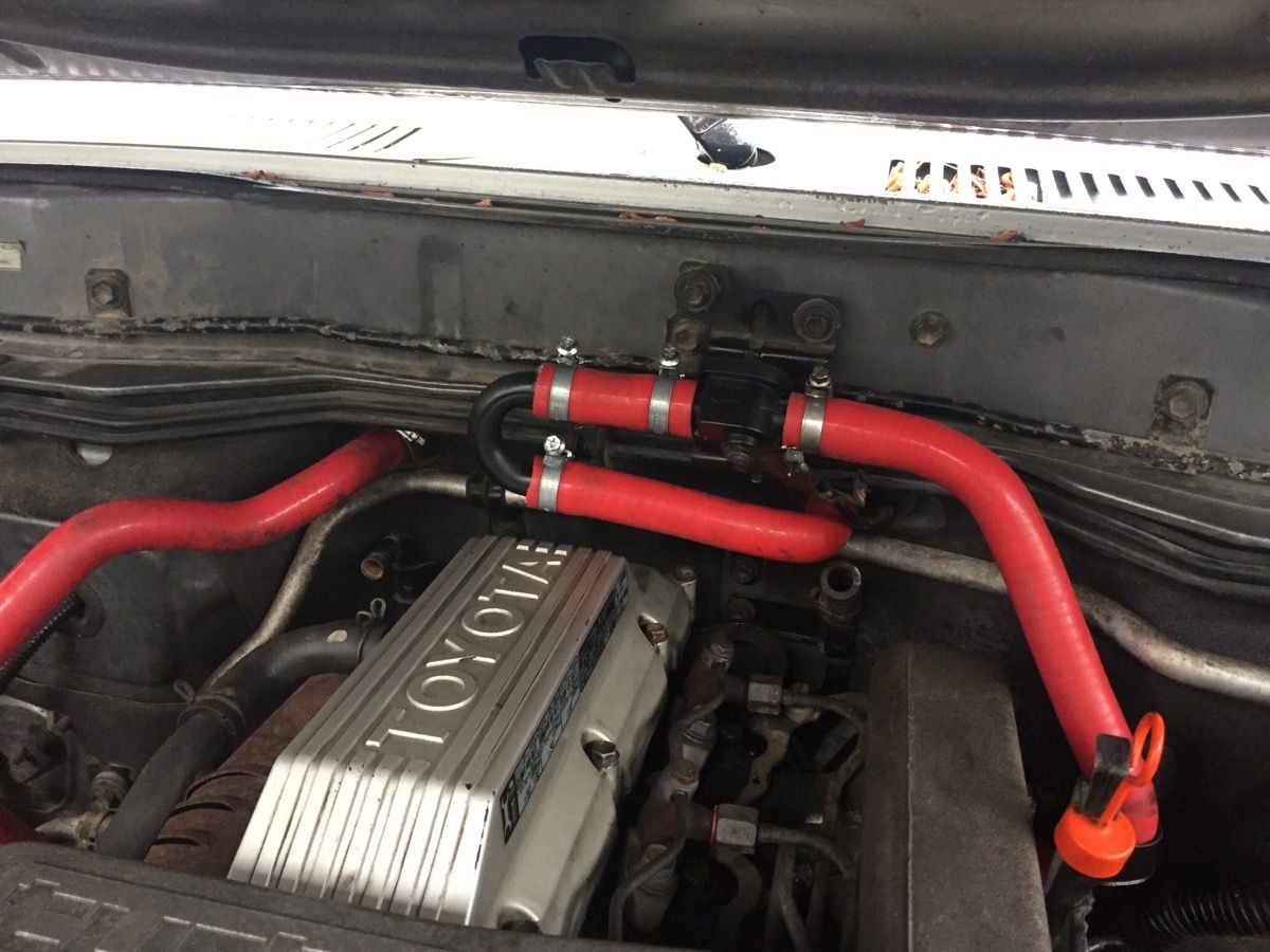

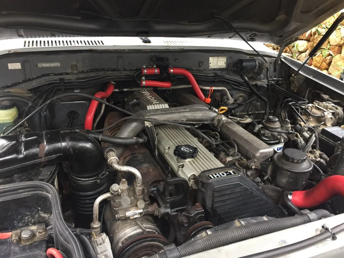

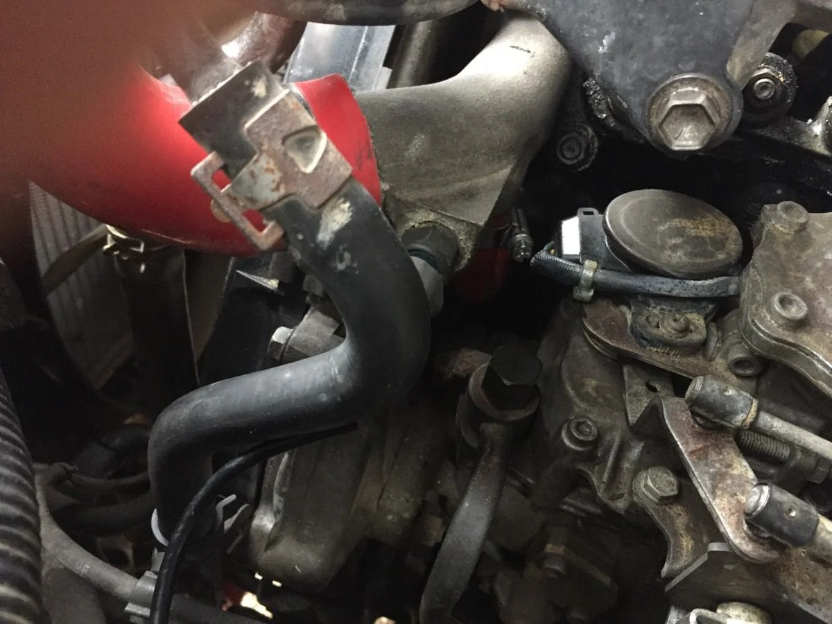

Still crossing the jobs off over here. So she just had a new Aisin waterpump, and genuine Toyota timing belt & tensioner, (all from Roughtrax, theyre really good) the Toyota 76 degree thermostat, new alternator belts, and Toyota red coolant. plus I finally got to fit the rest of my silicon hose kit, including those little turbo waterfeed pipes that are impossible to get to, until it's apart. It's nice to know nothing's going to suddenly spring a leak on 24 year old hoses under there anymore. Gave her a bit of a long-neglected clean up under there too
there's a red pipe under the watertube next to the fuel pump here if you look carefully, hardly an easy roadside fix lol
and turbo-side, not much better

Ah Kev, you have found the right silicone hose kit for the 80 12 valve! I have seen some rubbish and they more often than not have parts missing, please send me the link at your convenience, The red brightens up the engine bay for sure.
I too have removed the heater and the space under the seat will eventually be my on board air pump.

sure, it was this from "Winner Racing" silicone radiator hose Toyota Land Cruiser HDJ80 1HD-T/1HD-FT/1HD-FTE 90-97 red | eBay
but it wasnt perfect. I have 3 small pieces left over that I still dont know what they are.
and the (R/H side viewed from front) heater delete was done by cutting up the single larger hose left over too. to start with though, both rad hoses and main heater hoses fitted (with no, or minimal trimming) and the hidden torbo pipes were spot on too
Perfect cheers Kev! The extra pieces I have seen on other sites confused me as well, it led me to think I was looking at the wrong kit and moved on, then you get bored and give up, want to get mine done before the summer heat kicks in. At the moment I am researching mapping software and looking for a cheap android tablet to throw in the glove box for trail use, any thoughts? Having said that and knowing where you live, I guess you just keeping going around in a circle and you arrive back home right? :D
