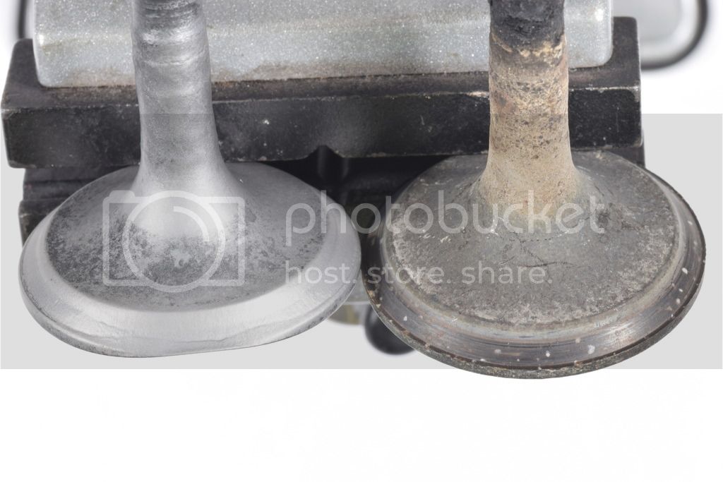

Some pictures of my "cracked exhaust valve".
Actually, a "Burnt" valve. Got super hot, locally thinned at the seat area (a million reasons why, it was probably lean). Eventually, the heated exhaust gas eroded the seat interface and it stopped holding compression. No wonder #5 was only 20 psi.
