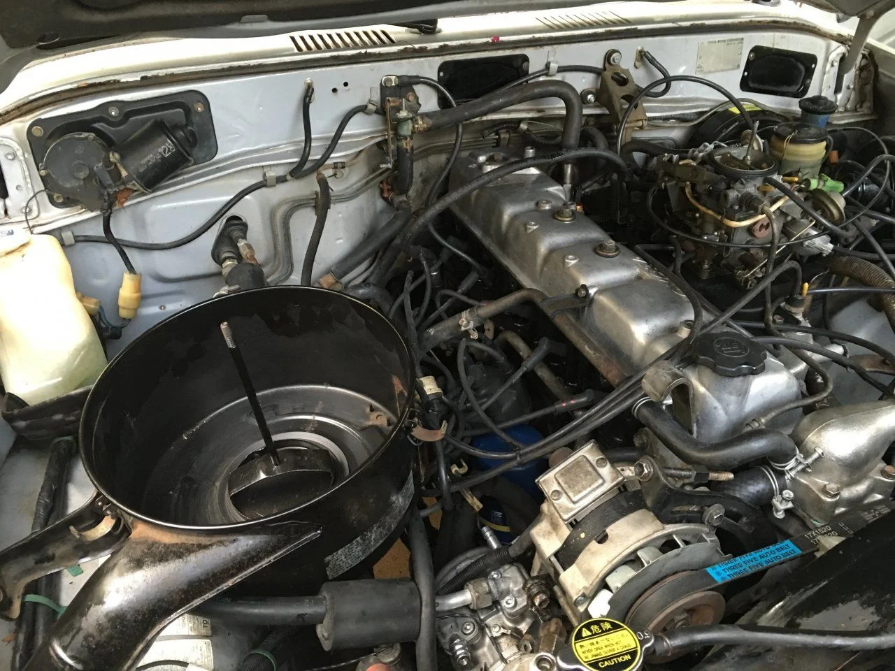

I also had to tighten my alternator up a bit. It was throwing the charging lite at low rpm and the belt was making noise from being a little loose. Thankfully I left my tools in the truck because I knew something would be loose after that much work.
The alt bolts are easy ones... 12mm and 14mm and you are good to go. Have cheapo ones in my bag in the truck that never leave. Hell there is TONS you can do on these trucks with just those two wrenches. I invested in a NAPA belt tension meter (little finger click thingy) and it has served me well, think it was all of like $15 too, though they had to order it.

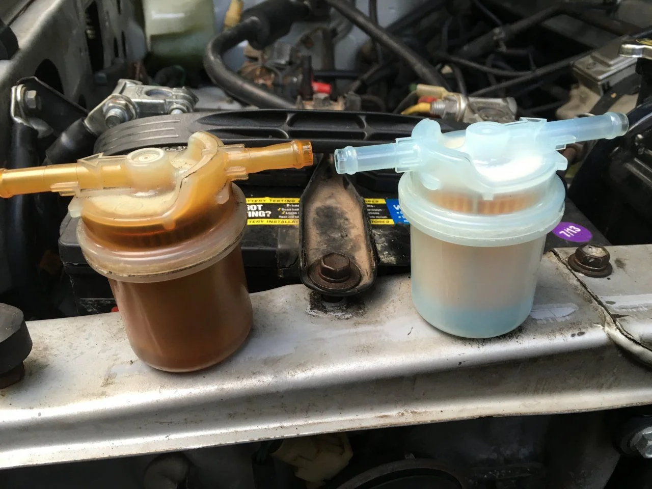

-replaced the fuel filter, the 3 months the truck sat for the head swap really gunked the tank up with flash rust. I need to replace the the fuel filters monthly to prevent things from getting really bad.

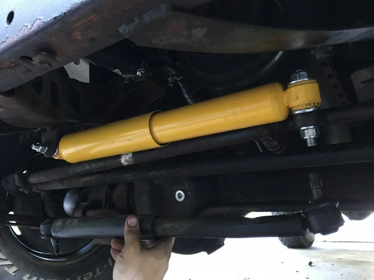

-replaced the oem steering stabilizer with an OME replacement. Huge difference! Steering feels way more confident. The highway is amazing now. It will track straight at 65mph with no vibration in the steering wheel at all. One of the best upgrades to the truck.

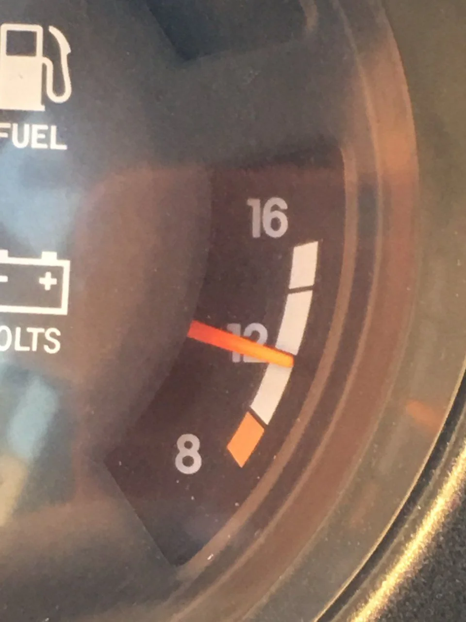

-my alternator is not able to keep up with low demand at idle. Battery runs 13.5v and alternator runs at lower than 13v under a 650rpm idle. Add the AC into the mix and it won't keep up at all. The alternator is a rebuilt unit from what I can tell. I ordered a 55amp Remy unit from rock auto. If that helps at idle, were in good shape. The photo shows where the alternator sits at idle with AC off.

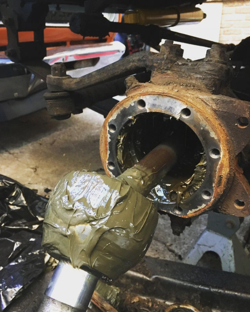

This knuckle rebuild has been an exciting bit of work, it really has taught me a lot about how the truck goes together and the forethought the engineers put into it.
I had no major issues taking it apart. The instructions that @cruiseroutfit included with the kit were great and his customer service to answer a question right before closing is great.
My dilemma has been the wheel studs. Rockauto has a messed up catalog, and I didn't pay close enough attention to the pictures. They sent a completely wrong part. I went to the local parts house and bought the Raybestos 27729B. That's what is pictured above. I can't confirm this, but @Spike Strip did for me. The OD is a few thousandths too bit before the knurling and they don't sit nicely. If I'm going to be pressing these in (I've learned my lesson) then I'm just going to order the right ones from @beno instead of doing this over.
So the rest of the PS side is done. The new races are in on the hub and bearings are packed, just waiting for studs to get it all finished up. I'm happy with the finished product. Added trail gear backing plate eliminators while I was there.

The only thing I regret is not putting a quick coat of black paint on the bolts. I cleaned them in evaporust, rinsed them and they flash rusted. Since I forgot to add grease to the brass/bronze bushing in the knuckle I'll pull it back off and clean them again when I lube all that stuff again.

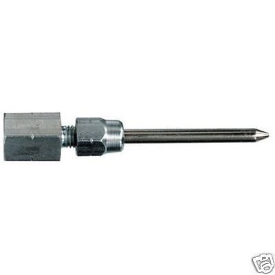

I bought one of these by Lincoln and it made lubing the birfields a breeze, I was able to get everything properly packed with my greasegun.
Now to start the DS hub rebuild...I took my time and learned as I went but now I'm confident that I can do this much faster.
What tool is that? Just a new pointed grease gun tip?
And yeah, doing one side and then the other you always learn new things as you go along and some good do's and don'ts. Oh and got the package over the weekend by-the-way, thanks for sending back.
Yep, it made getting grease into the balls of the birfield joint very easy. I could see it push stuff out on the other side.
It's really difficult to put stuff together wrong. So, now that I know how stuff falls apart I think I can get the DS back together in a few hours, but I'll pause for cleaning and do it at work with the parts washer and the ultrasonic cleaner to make it easier.
Thank you for loaning me that stuff.
I didn't take a picture of the other side but I'm 100% sure my inner axle seal was done!
Now to clean all the lovely gunky parts and start reassembly while I wait for my oem studs from beno.
