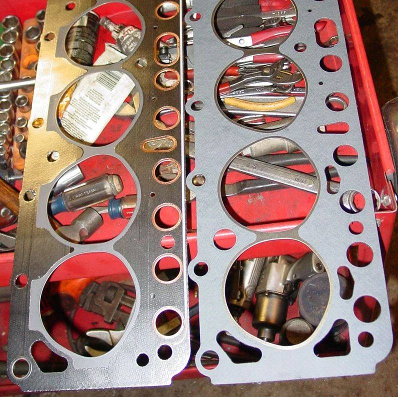

Cheap headgasket problems
Note the significant differences between the aftermarket HG and the genuine Toyota (on left). Don't fall for the BS from vendors that the cheapo gasket is OE toyota 'cause it's made in Japan.
The Toyota gasket has these additional features:
  • Copper crush rings around pushrod holes
  • copper crushring around oil transfer slot
  • silicon sealer bead outside of pushrod holes
  • steel reinforcement around dowel hole (bottom left)
  • contiguous steel fire ring
  • additional steel leafspring reinforcement between cylinders
  • much larger firering
  • Surfaced w/ Felpro graphlex material
  • steam holes in correct locations
Felpro gaskets have the added protection also.....it would be a good idea to have your torque wrench evaluated, just to be sure....
