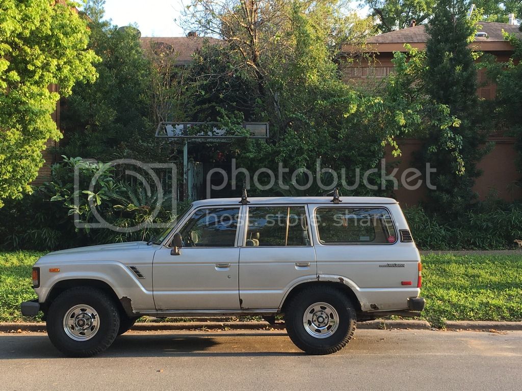

Build The 60 known as Mamabear: a tale of rust and good times.
Member Builds and Stories

Radiator is going to be the big issue. I've got a leak that I've not tracked yet that must be a pinhole. I've got a very slow drip and I'm inclined to get the radiator fixed. I really don't want to get an aluminum one. I've got the champion in my hotrod, but I like keeping this as original as possible. For reliabilities sake.
My transmission knocking has stopped. Sadly, it was due to a seal between the transmission and transfer case gone bad. My trans was low on fluid and my t case was so full, it poured out of the fill plug when I opened it up. I'm going to ride it out and just check it monthly until I formulate a plan for a new clutch, rear main seal, t-case rebuild and so forth.
A big thanks to @Output Shaft for taking my call on a Saturday afternoon. Really helped.

Next up: Head refresh/head gasket, waterpump, fan clutch, all new belts, refreshed radiator, 15w40 Mobil Delvac diesel oil/Denso Filter all at once.
Then, knuckle rebuild and tierod ends.
