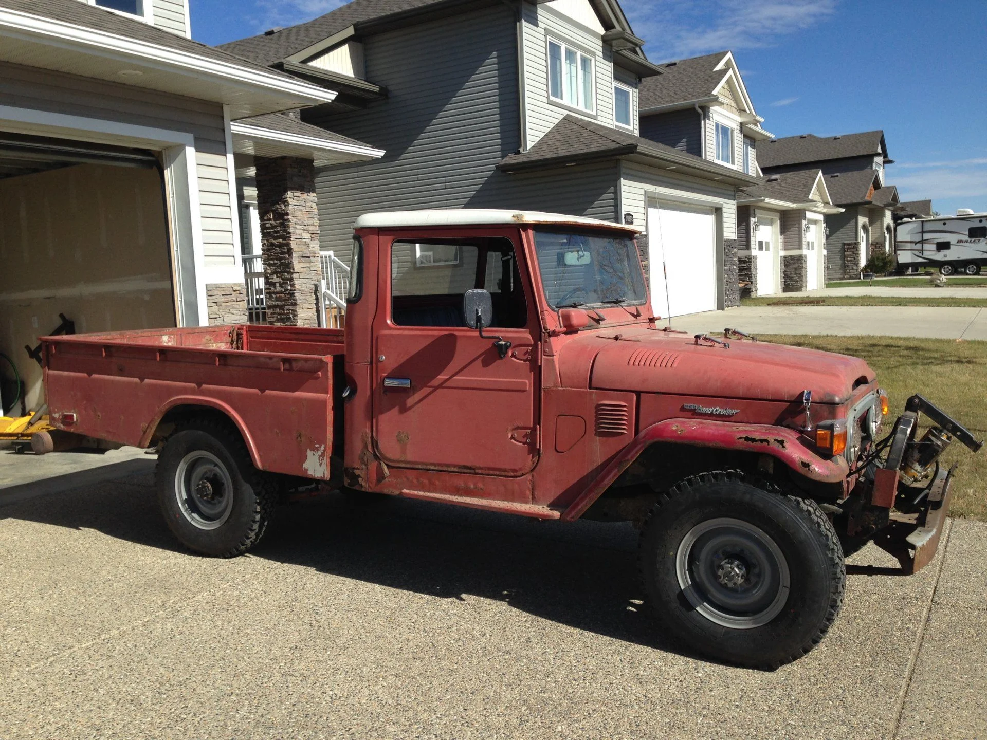

crusty. But a great work truck. Put a rack on the back and a tent platform for sleeping. An f or 2f engine is pretty much a diesel that runs on gas 😂.
